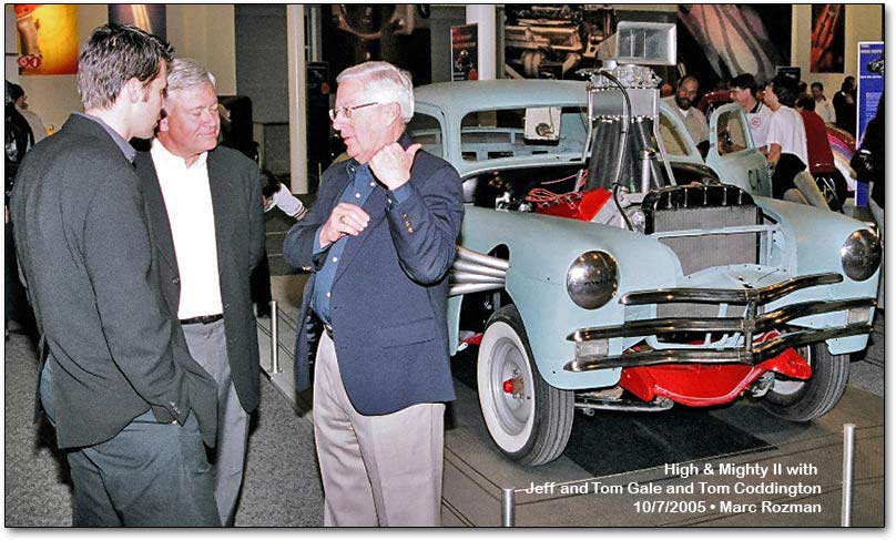

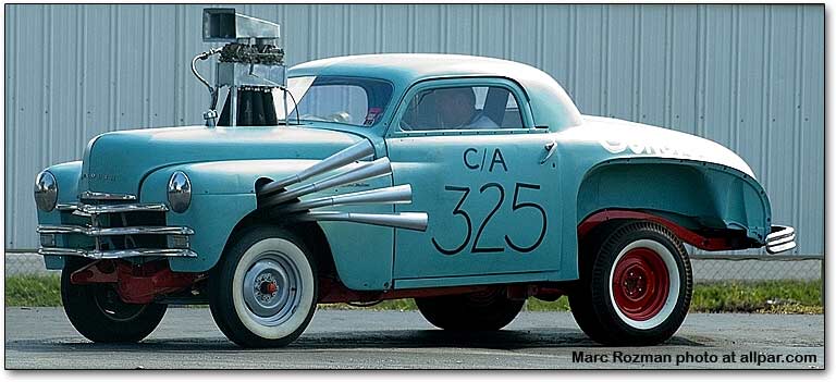

Also, the nose up stance was in theory that when the car launched this would help weight transfer to the rear. The cars that were level at rest would rise up when the car launched and in theory this helped weight transfer also.
Here are a couple pics of the restored High & Mighty race car that the Ramchargers first ran in 1959-1960. They kinda of started the craze.

EXCEPT.....the High & Mighty is an ALTERED, not a gas class car.
Two totally different classes, not even close. a Multitude of differences.
it SAYS, C/ A= altered right on it!

I know it is an Altered car.....................the point of the pictures was to show how early on racers raised up their cars for what they thought at the time would be a performance improvement. That's what I was talking about in my post.

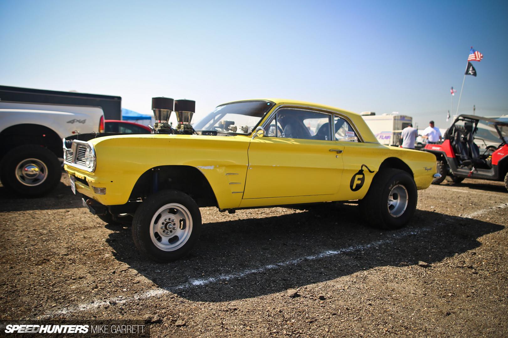

I guess it depends on your definition of "nose high".
I remember the Gasser Wars and, while my memory is admittedly poor, I don't recall any of the competitive cars having too high of an angle off the imaginary level.
F'rinstance, to me, this is too "nose-high".

I don't know if it's "too high" or not, but it definitely is what I would call "nose high". It's what most guys think of when the term gasser is thrown out.

Gassers and Altereds both were designed around the basic formula of weight divided by cubic inches. Yes there were other differences but still the basic formula was the same for both of them.
