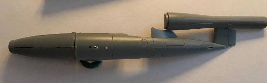

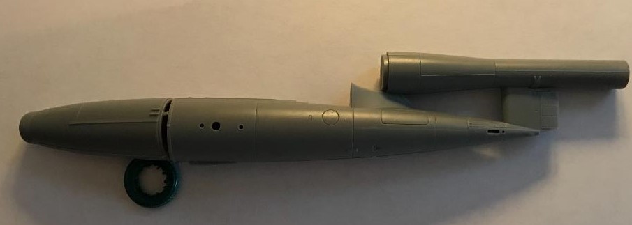

jaxenro Posted December 16, 2018 Author Posted December 16, 2018 So I finally got the base model in the mail from HK. My thought was to make wheel covers like the Stutz LSR car from the wings but the chord isn't big enough to cover nor are they thick enough so i am looking for a plan B. Pics to follow it is really a simple kit for the price not a lot of parts.
jaxenro Posted January 1, 2019 Author Posted January 1, 2019 I am going with one front wheel trying to decide do i want it in the forward or more middle position I am leaning towards forward thoughts
jaxenro Posted January 1, 2019 Author Posted January 1, 2019 Lot of the weight is on the back end the front section was the 1,000 kg warhead which I think they are leaving out but I will go with the forward position I am working on mounting the rear stabilizer and elevators on the nose to keep it down running the elevators in tandem

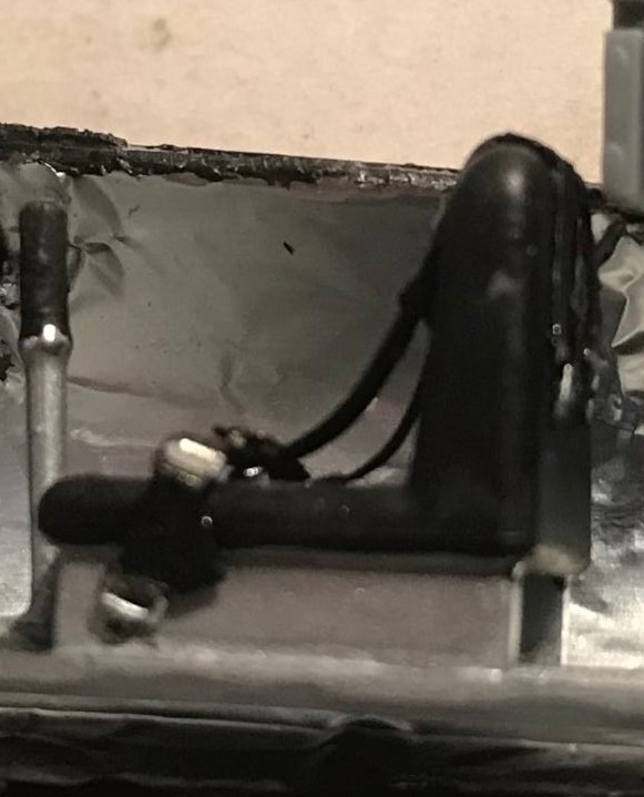

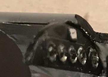

jaxenro Posted January 11, 2019 Author Posted January 11, 2019 (edited) Not that any of this will show but I did add some seat belts and stuff and gussied up the control panel a little. I am sort of trying for a rough edge look as they tacked in some sheet aluminum to cover parts of it I cut out and built the front wheel well also I will be closing it all up and painting the main body over the weekend Edited January 11, 2019 by jaxenro

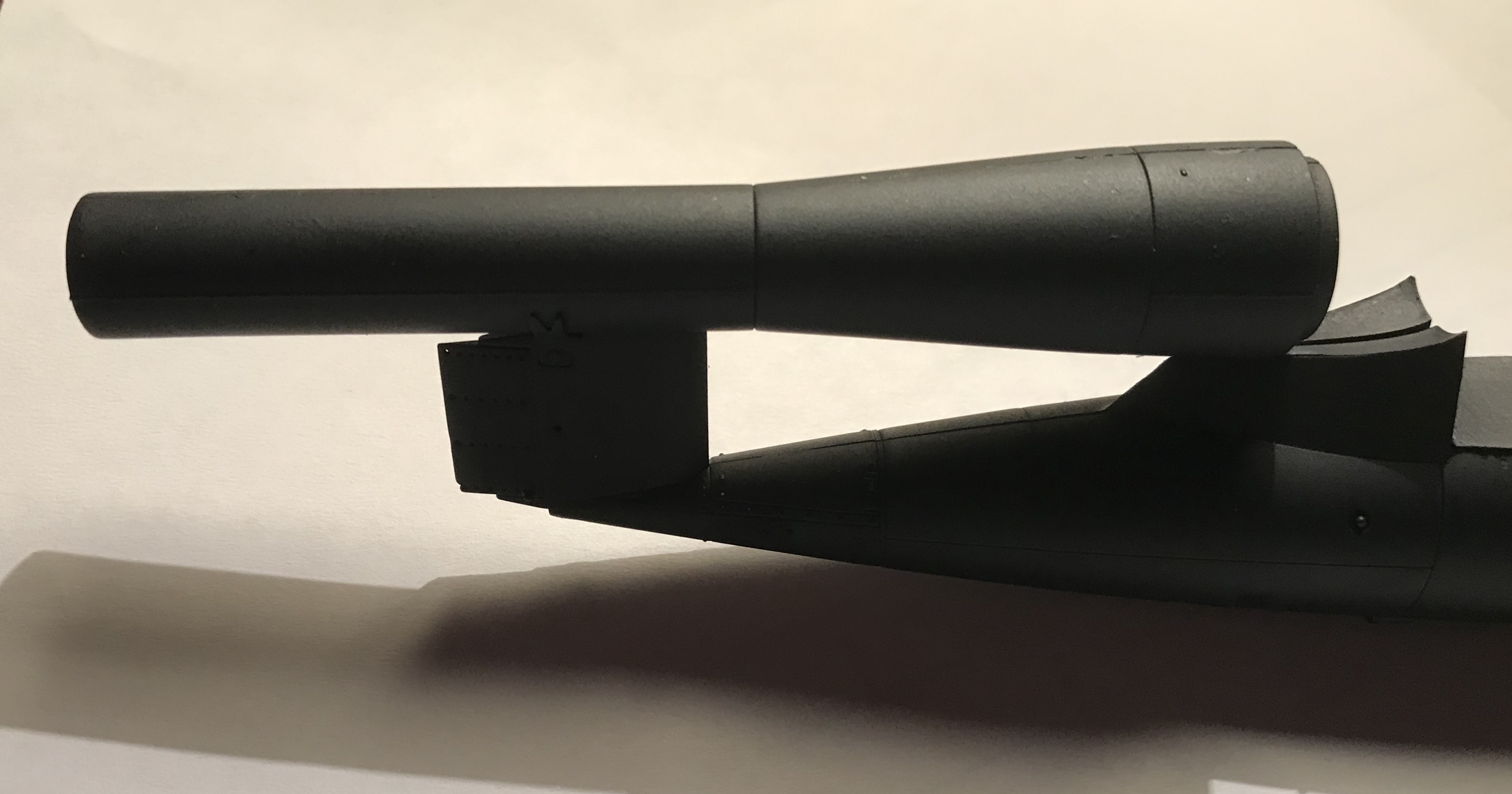

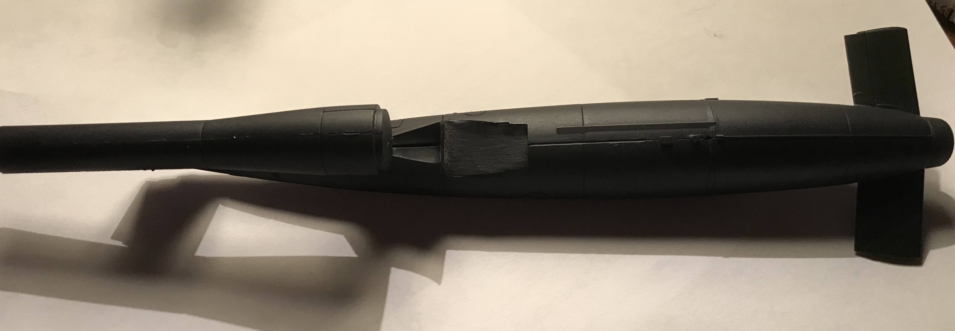

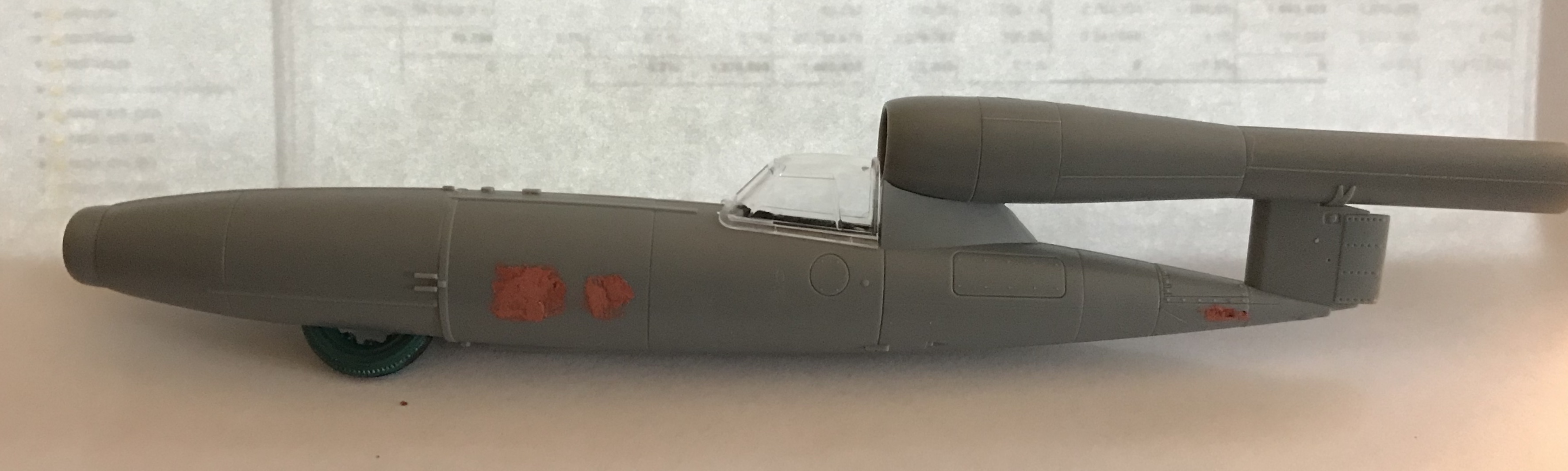

jaxenro Posted January 14, 2019 Author Posted January 14, 2019 Some progress and a mock-up still too cold and wet for painting

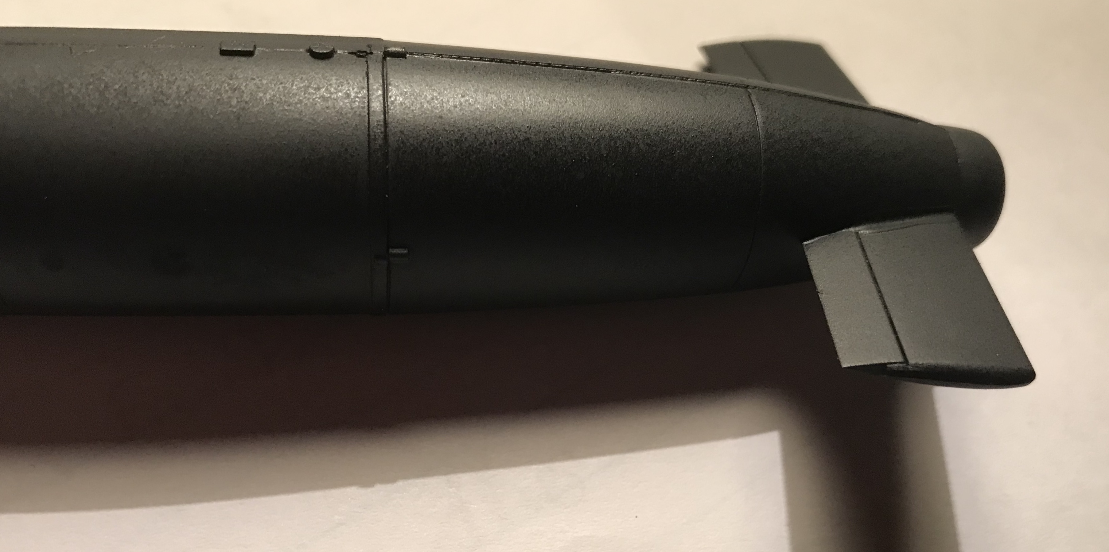

jaxenro Posted January 16, 2019 Author Posted January 16, 2019 Got some paint primer on it need to fill a few seams. Also added the front wings to keep the nose down
