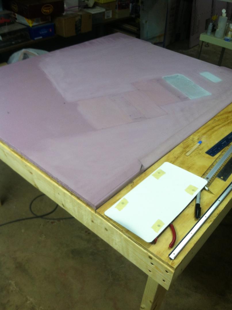

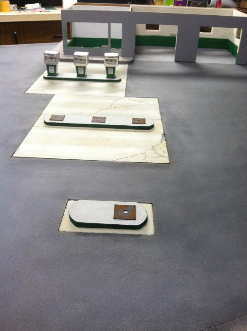

bill lanfear Posted February 6, 2019 Share Posted February 6, 2019 Hey Elvin, I ran into this problem not too long ago myself for my gas station diorama I am still working on. What are you using for "asphalt"? If you don't know yet, I use pink insulation foam boards lightly sanded. Painted it flat black (airbrush) with acrylic hobby paint from wally world, then to lighten it up, I sprinkled baby powder over it and rubbed it in by hand. you could use brown powder of sorts with the same technique to get a "dirty" look. Watch out for anything that will tear up the foam. It also makes great concrete! Hope this helps! That is what I use anyways....maybe someone has a better technique?? Quote Link to comment Share on other sites More sharing options...

bill lanfear Posted February 8, 2019 Share Posted February 8, 2019 Elvin, be sure to use acrylic paint as others will dissolve the foam, also be sure to experiment with glues to see what works. I use elmers white, clear, and wood glue. I have successfully applied static grass and the only major challenge with the foam is not scratching or denting it accidentally. Good luck and can't wait to see how it turns out! Quote Link to comment Share on other sites More sharing options...
mredjr Posted February 9, 2019 Author Share Posted February 9, 2019 Thanks Bill, I like the foam but I am going to make the base 48" x 42" and want something under it but I to keep it light. Quote Link to comment Share on other sites More sharing options...
bill lanfear Posted February 9, 2019 Share Posted February 9, 2019 Yeah mines on 1/2 inch plywood very close to your dimensions...I left an area to place a road with another piece of foam. I sand it down for approaches, the dome on the road and curbs. Don't breath in that stuff when sanding!! Quote Link to comment Share on other sites More sharing options...
