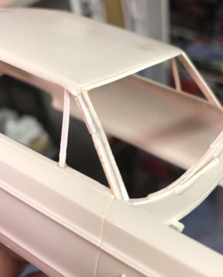

I do need a bit of advise on how to repair the windshield pillar. It had been broken in two spots, and a rough repair made by the previous guy. I don’t have a parts kit that has a pillar close to the same size.

That being said, I'm not sure how I would tackle the A-pillar.
Looks like he tried to save the lower portion of the pillar that wasn't broken and tried to just glue the broken section back into place.
I would try to save that lower section as well, but you might need to replace the broken part with some styrene stock.
This is why I avoid old kits with broken pillars like the plague!
I absolutely hate trying to fix them!

Unfortunately, I don’t have a choice. These kits aren’t cheap, so I have to work with what I’ve got! The rest of the kit is unbuilt/unpainted, this is the only issue. Oh well, it’s a good opportunity to learn something.
I have used Evergreen stock to replace "A" pillars. It takes a little work, but I end up with a solid piece in place of a couple broken parts that might not be as strong as they should be.

Trent if you have a body with good pillars you can pull a mould off the one body using a fast setting putty. Another member showed off this technique a little while ago and it works very well
That's not a bad idea.
cast one from the good body with some 2 part epoxy if you're not set up for casting with resin.
Steve
br67, I’ll give that a try! I’ve never cast anything before, but there’s a first time for everything!
Bucky, I still have a few parts cars to check, but so far none of the parts kits are close.

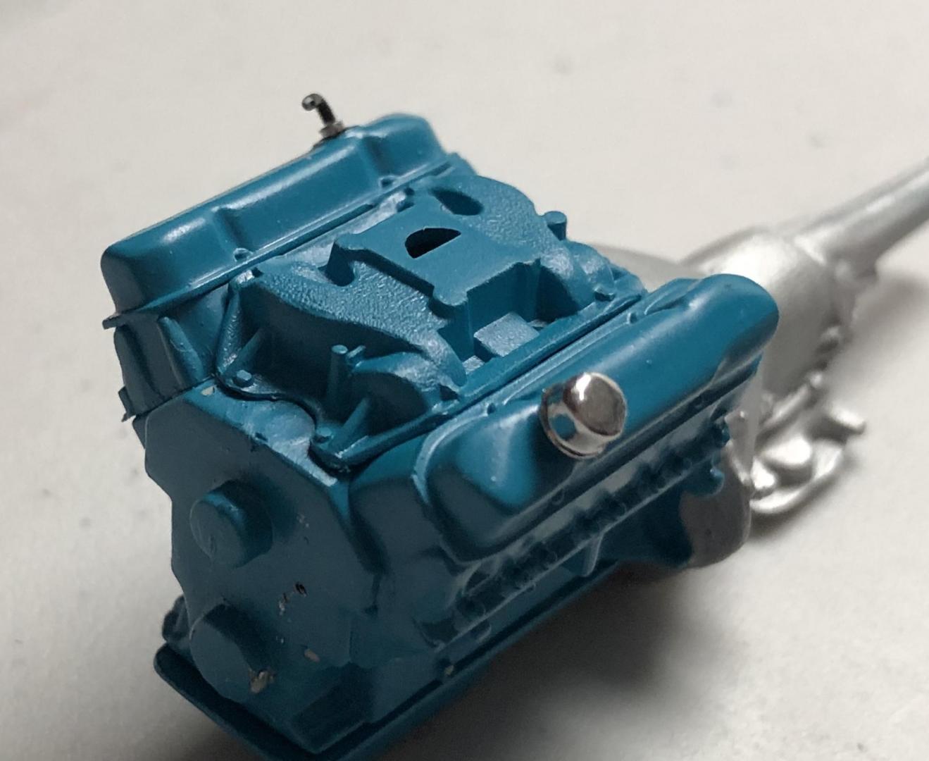

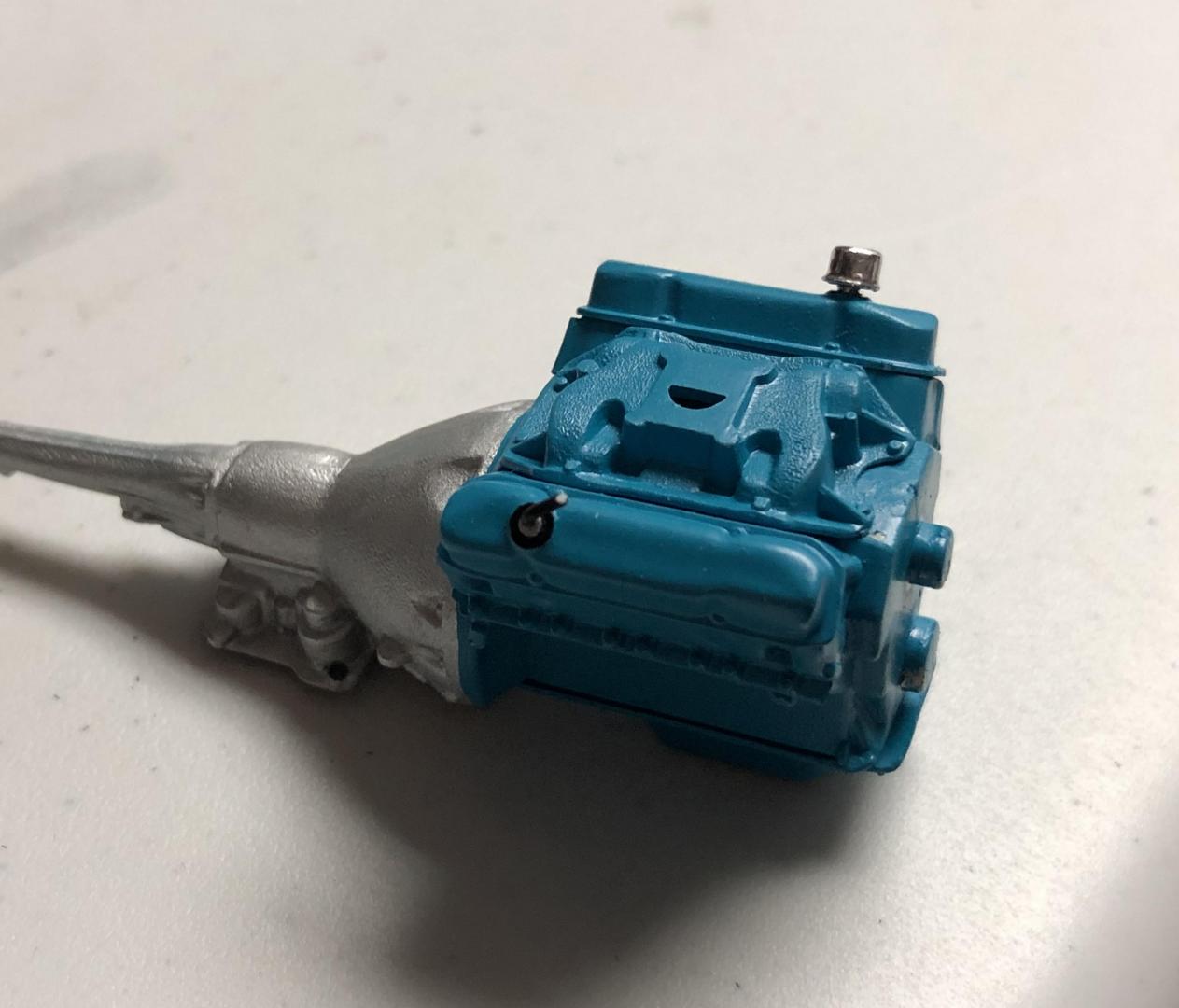

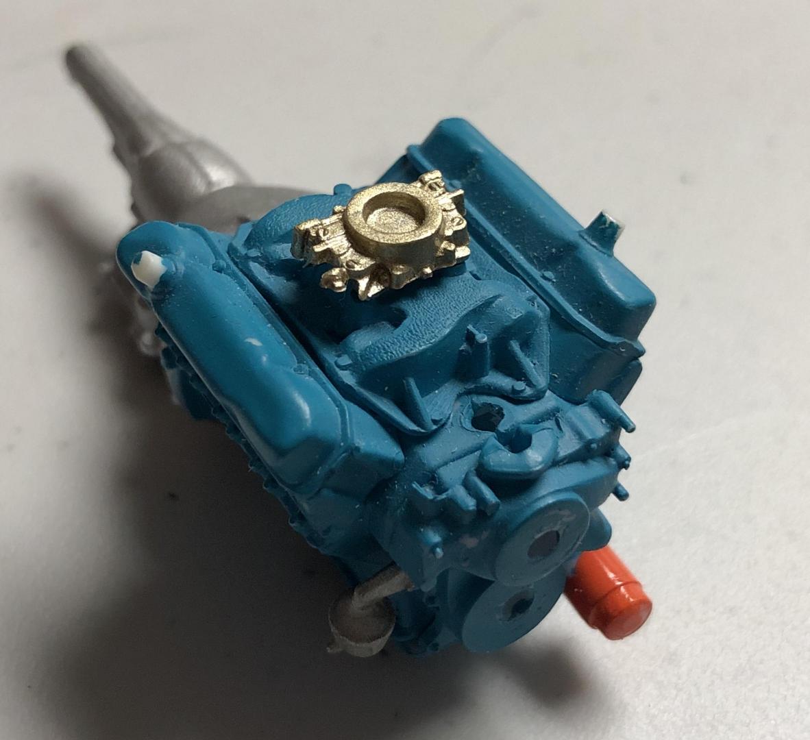

A bit of engine work getting done while I wait for parts for the Super Bee to dry.
The valve covers for the 383 were just generic, and didn’t really do it for me. I cut off the breathers, and made a PCV and a much better breather/oil fill cap. The first picture is of a spare 383 I’m building for a Dart (for a comparison), the other two are the Fury’s 383.
