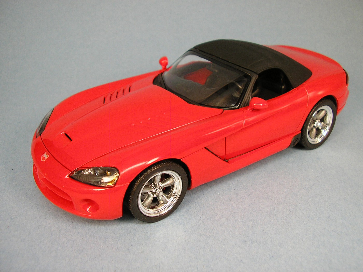

On 10/19/2019 at 11:43 AM, MrObsessive said:
This here...........GOOD stuff for any plastic. Put on dusting of primer coat and then put on the BIN Zinnser. Prime again with your choice of color and NO issue with bleed through or crazed plastic.
You'd need an airbrush though.........no thinning is needed if mixed thoroughly in the can.
I did this Viper using the sealer as that was one of the kits that had an issue with "soft" plastic.
I'd assume if you wanted to thin this a little bit you could use denatured alcohol since it's shellac based ? The Viper came out beautiful by the way !
David you could do that, but I haven't had to deal with that ever since I started using it years ago. Pretty much straight out of the can after mixing it up and then putting it on with my Crescendo airbrush using the heavier tip.
Thanks for the compliment on the Viper! ?
