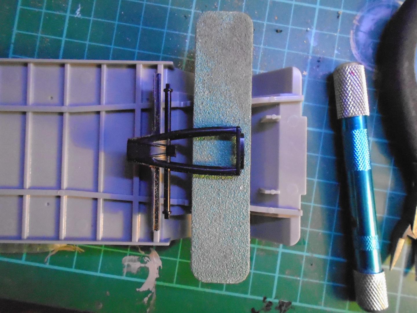

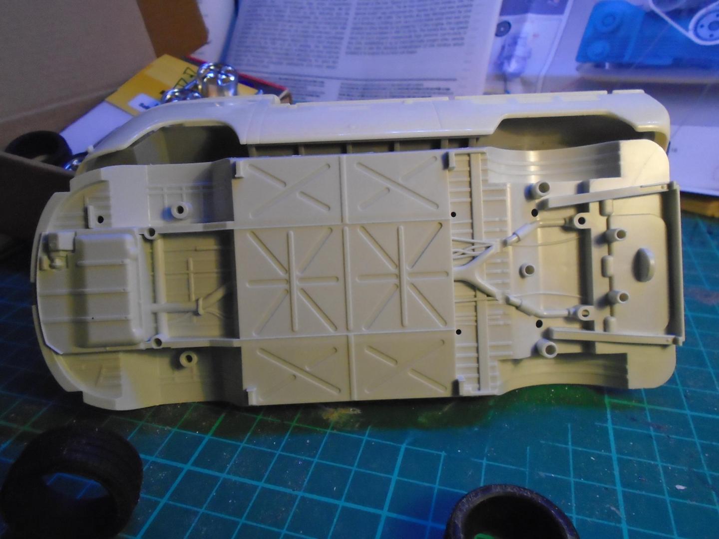

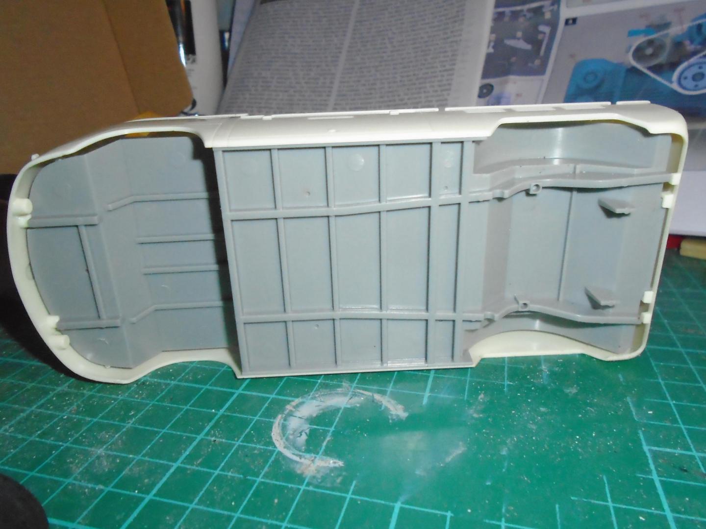

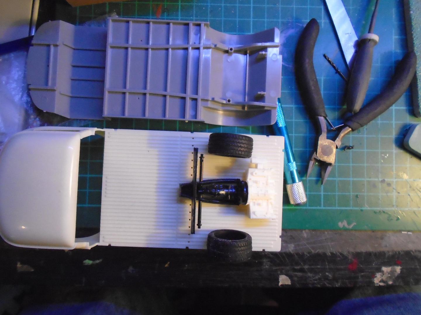

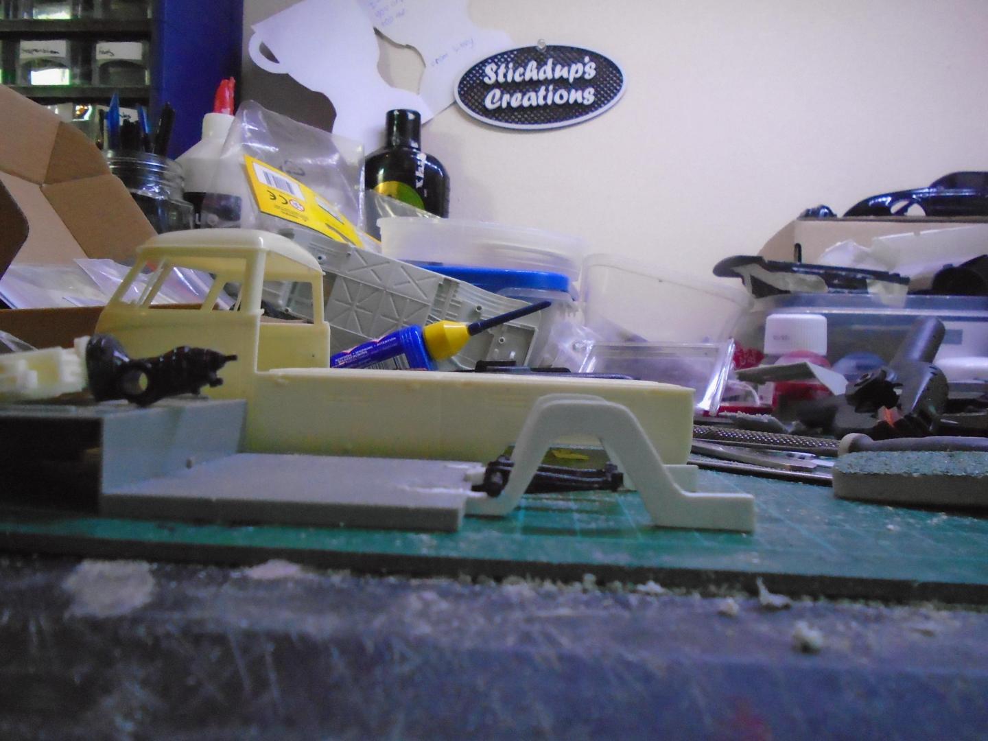

stitchdup Posted December 19, 2019 Author Share Posted December 19, 2019 Well i thought i really should get the saw warmed up since I'm effectivelly got half the time due to work. I'm starting with the rear since it will set the ride height due to the bed floor. Its the reason the big rims dont fit how i want so have been swapped for porsche 5 spokes. I am using the tamiya beetle rear chassis since it has gearbox mounts and is simple enough to narrow. I will be using the hasegawa rear torsion arms though as they allow a little more space than the bug versions. I am using the beetle gearbox as the suburu one is about twice the length so it can go in the spares box for now. I've put together the engine block and gearbox to help with mockups and to give a reference for the suspension. I'll be grafting the beetle rear onto the hasegawa chassis but all that will be staying is the the two rails as the bug parts replace most of the rest. The rails will also give me somewhere to build up the engine bay around the engine as neither the revell nor hasegawa offer much in this area and building from scratch will be simpler than modifying the kits. There's really not much to one of these bays anyway and doing it this way will allow me to fit the rads in a space designed for them instead of where theres a gap. I'll get the suspension built up and engine complete before starting this as the engine has a lot of bits still to fit. Quote Link to comment Share on other sites More sharing options...

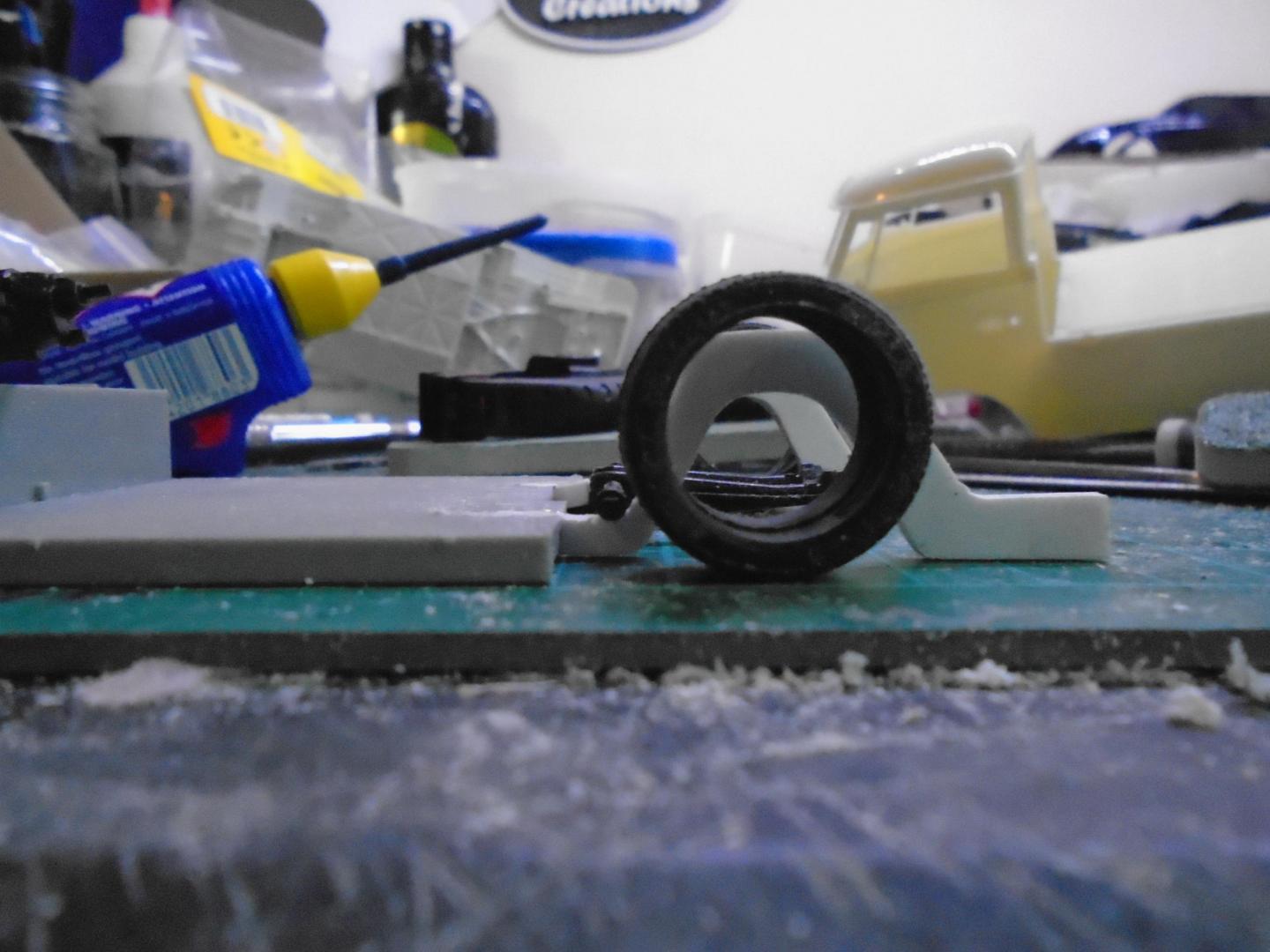

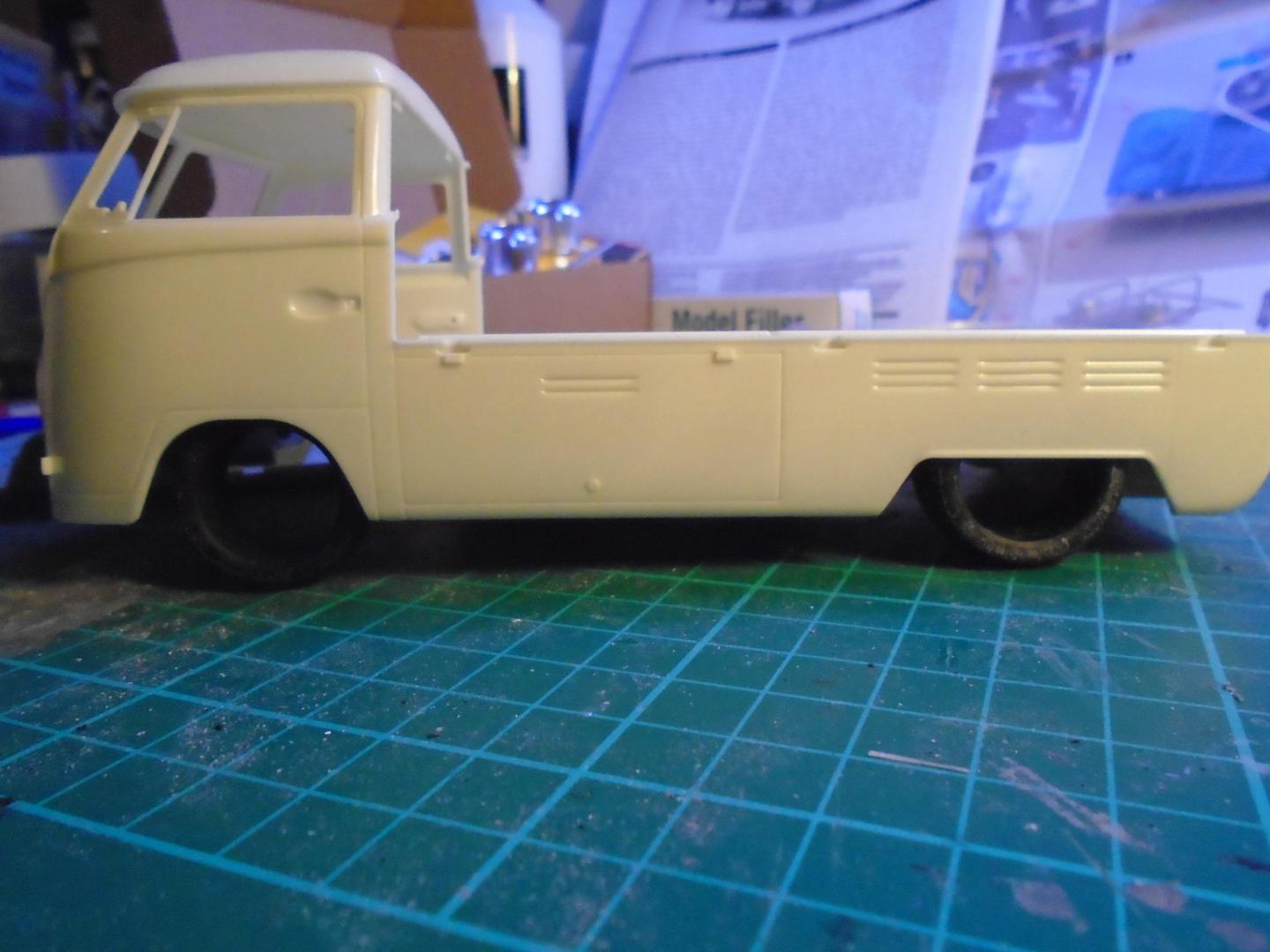

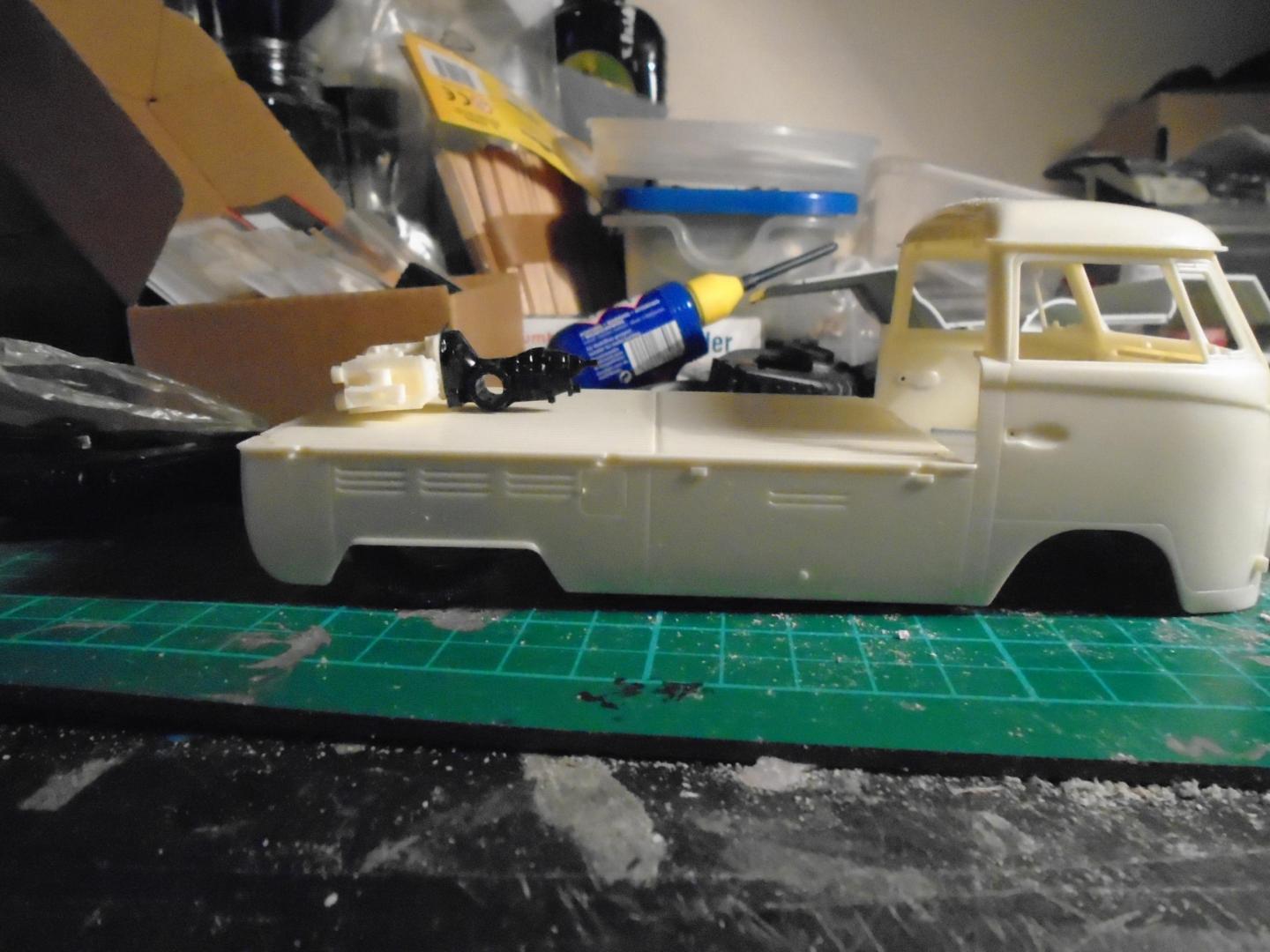

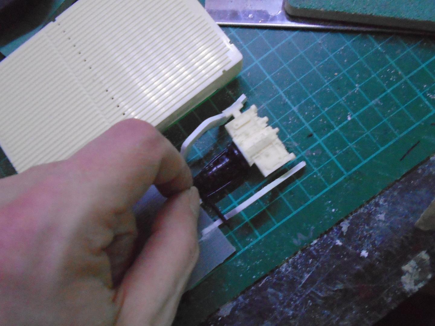

stitchdup Posted December 19, 2019 Author Share Posted December 19, 2019 (edited) So the rear end wasn't sitting as low as i wanted it to. I spent an hour or so modifying the hasegawa rails before deciding it would be far easier to just chop them off and build some new ones. I cut 6 of each rail then glued them in batches of 3 then temp glued these together so i could get the 2 sides the same shape. Obviously I made them so it would sit on the floor on slightly smaller wheels but then my brakes wont fit. I'll be doing more work on the suspension next to ensure it will stay this low so all the mounts will be to suit this stance. I have to build a new engine bay but since vws are pretty much all flat surfaces that shouldn't be too hard and I can build it to suit the engine and other parts. Since I have to fit a radiator I might use the vents from the van left overs on the side panels so I can move the radiator under the bed and give me a much cleaner looking engine bay since the suburu engine is pretty ugly. It means I'll have to open them up to show it off but that also gives me somewhere to put the air tank and pumps and using the van vents will keep it original looking too Edited December 19, 2019 by stitchdup Quote Link to comment Share on other sites More sharing options...
