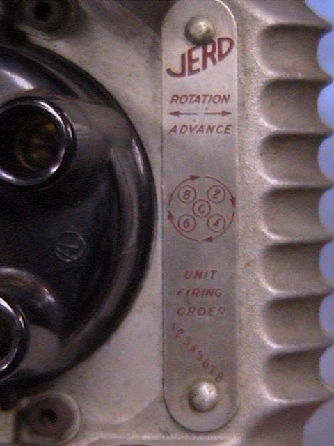

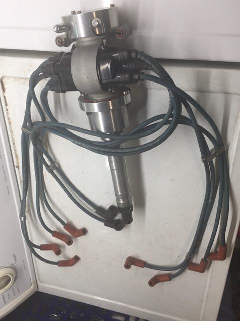

afx Posted March 16, 2020 Posted March 16, 2020 Looks like there are 5 wires each side, one each for the 4 cylinders on each side of the V8 and 1 coil wire.
MeatMan Posted March 16, 2020 Posted March 16, 2020 I had the same idea a few years ago and did quite a bit of research on it. My post requesting info is probably still on the server. AFX is correct, but I could never get confirmation that the caps were for separate sides but I believe it to be true. This is the best pic I found that I could remotely trace the wires.
Jon Haigwood Posted March 16, 2020 Author Posted March 16, 2020 (edited) Looking close at a bunch of pictures It looks like 2 wires go to the side they are mounted on and 2 cross over to the other side. And the same for the other side. I just can't figure out where they mounted the coils. Edit: actually it looks like the coil wires run under and behind the firewall Edited March 16, 2020 by Jon Haigwood
STYRENE-SURFER Posted March 16, 2020 Posted March 16, 2020 13 hours ago, Jon Haigwood said: Looking close at a bunch of pictures It looks like 2 wires go to the side they are mounted on and 2 cross over to the other side. And the same for the other side. I just can't figure out where they mounted the coils. Edit: actually it looks like the coil wires run under and behind the firewall I looked and looked, I'm with you, those coils are probably hidden out of sight. From these two pics you should be able to deduce the plug wiring and firing order.
Jon Haigwood Posted March 16, 2020 Author Posted March 16, 2020 1 hour ago, STYRENE-SURFER said: I looked and looked, I'm with you, those coils are probably hidden out of sight. From these two pics you should be able to deduce the plug wiring and firing order. Thanks that is a big help
