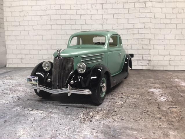

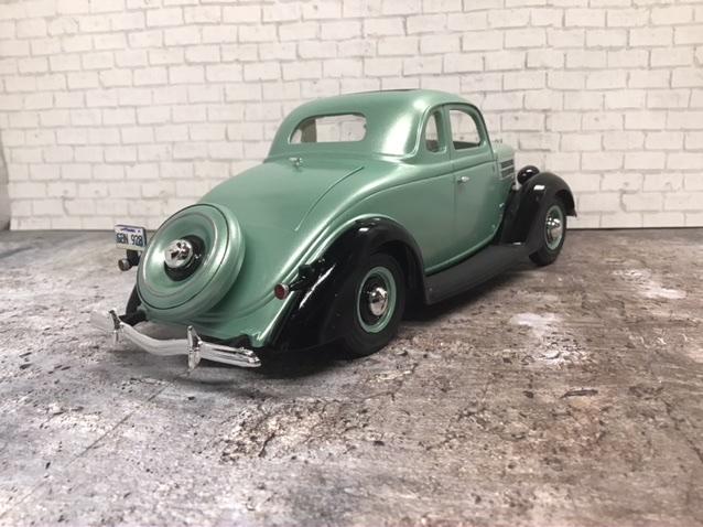

I’m calling this one done. I used epoxy to mount the headlight buckets since they seem to need to lean out a bit to clear the hood. The mounts molded to the fenders should have been slightly farther apart? I also made some taillight lens from clear red sprue because there were none in the kit. Under glass pics:
http://www.modelcarsmag.com/forums/topic/156196-amt-‘36-ford/ADD6F8E5-783C-4852-B0AD-54887402C398.jpeg
Thankfully, Zippi gave this one new life.  The bodywork is incredibly nice, Greg. After seeing this, I think I may be sold on sprue-goo.

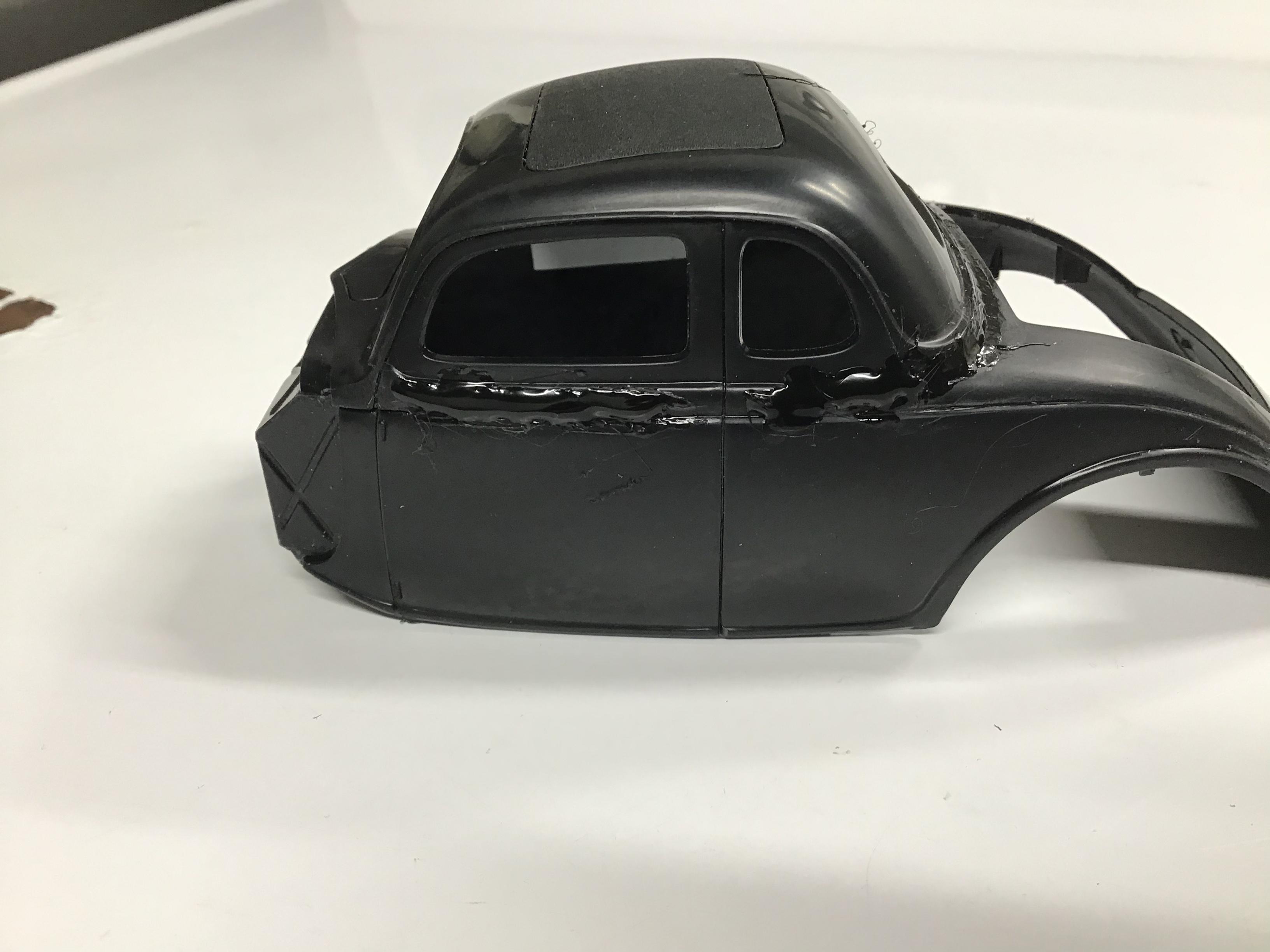

This is going to be a time filler build in between other stuff. From what I’ve read on here and what I’ve seen so far, it is a horrible kit. That said, I am going to try some body work and some modifications I haven’t attempted before. If I mess it up beyond repair, no biggie! I started by glueing the roof on which doesn’t fit well at all. I made some sprue-glue up and pasted it on the seams. I will attempt to file it closer to the proper shape when dry.

Just pulled this kit out of the stash and was checking out some wheel options and noticed the pour fit of the top section of the car to the body.  While doing some research on this issue I came across this old thread of yours where you did a bang up job making up some sprue glue and filling that gap.  I'm headed to the hobby shop today some I'll pick up some Tamiya Extra Thin Cement as I don't think they carry the Mr. Hobby.
Another way to improve the fit is to cut the body away from the firewall down the sides by making a vertical cut up the side where they meet. Then you can bend the body out to line up with the bottom edge of the roof and glue. Then fill in any gap between the firewall and body (it should be small). I've seen other builders do it and I plan to when i get around to building another.
