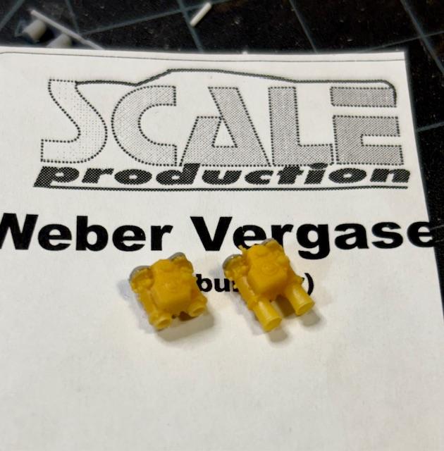

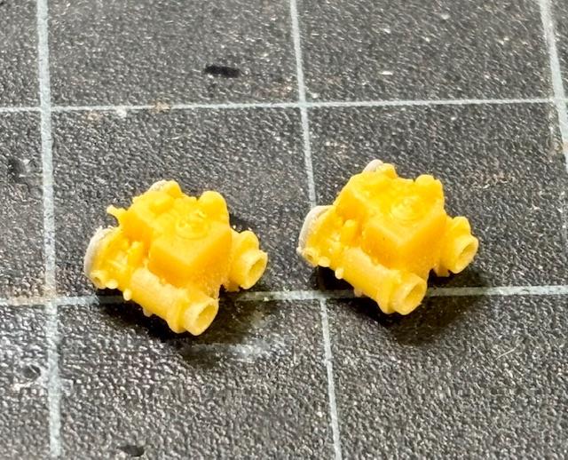

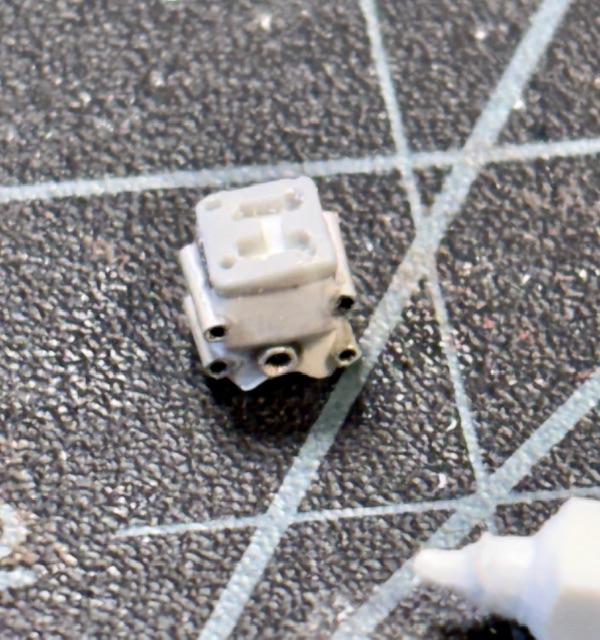

absmiami Posted May 1 Author Posted May 1 Not all Weber side draft carbs are created equal - these - by SP - are correct for many of the private team Lotus 18s - including the Moss Monaco winner … the manifold is angled up to allow the carbs to clear the horizontal frame member -

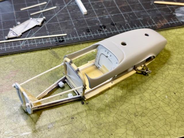

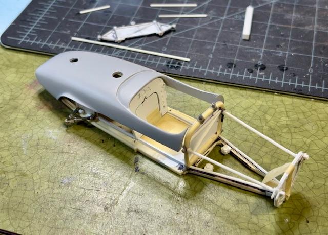

absmiami Posted May 1 Author Posted May 1 Changes to engine bay frame mounts - but this is close to what I’ll need …
absmiami Posted May 1 Author Posted May 1 The frame adjustments result in the top frame member taking a detour past the engine bulkhead - supposed to be straight back - don’t … tell … Colin ….

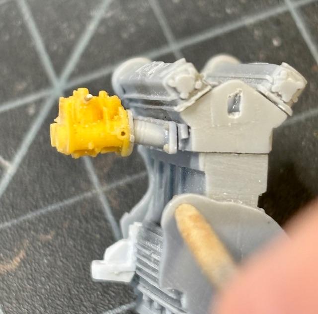

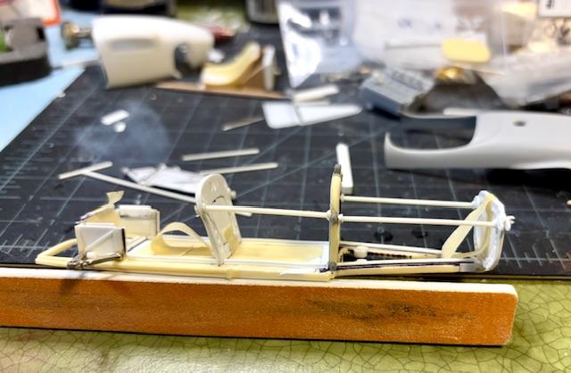

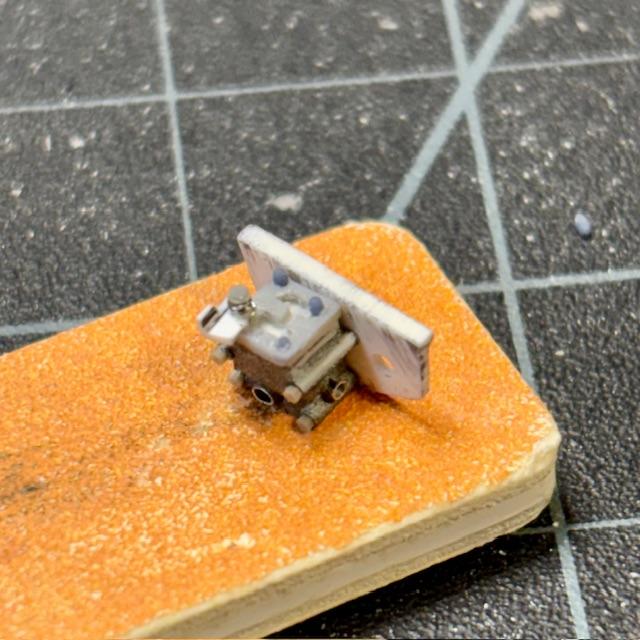

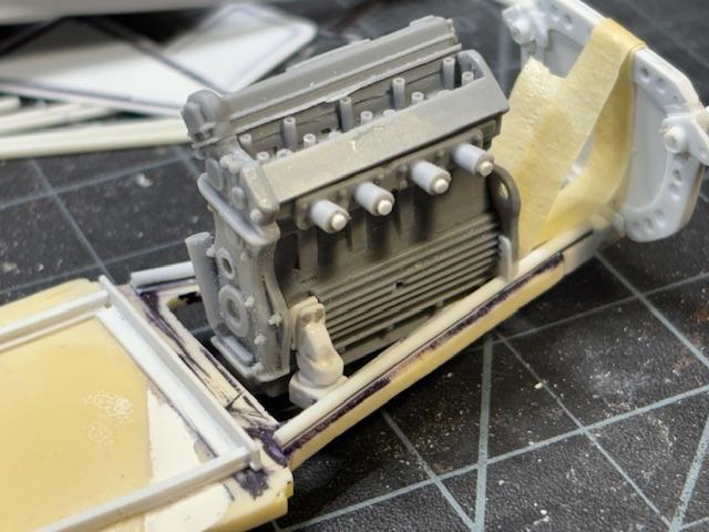

absmiami Posted May 5 Author Posted May 5 Some additional changes to make a decent engine mounting on the bottom frame members …

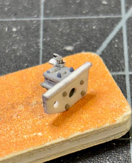

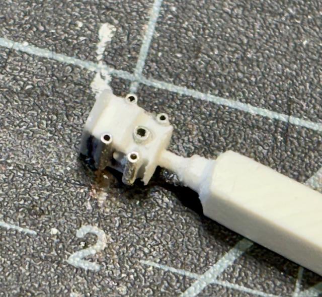

absmiami Posted May 5 Author Posted May 5 (edited) Gear selector casing with frame plate and added bolts and a reverse gear lock-out clip … dress in should work for the shifter … Edited May 5 by absmiami

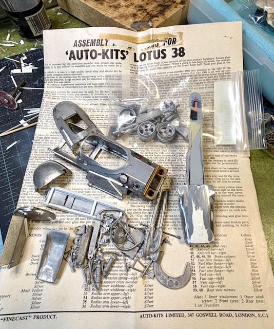

absmiami Posted May 8 Author Posted May 8 I had put this one aside years [and years] ago - Matt Bacon has posted a number of White metal kit builds - but not the Lotus 38 Clark Indy winner - its getting a little hard to find/buy like the other Auto-kits open wheelers - it’s a curbside - i’m going to apply some new found - thanks Matt - lo temp soldering skills - and i’ve got the engine …

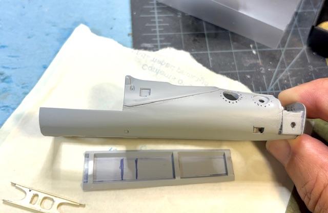

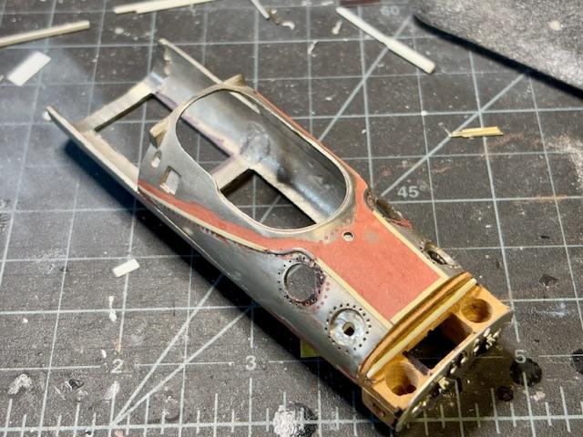

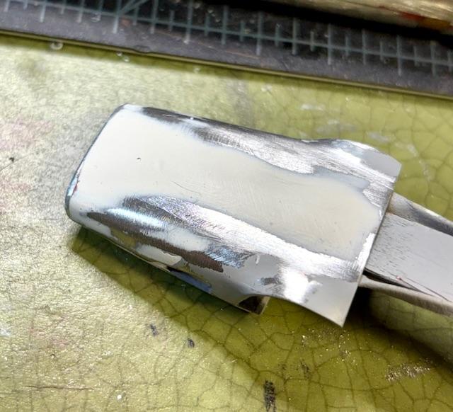

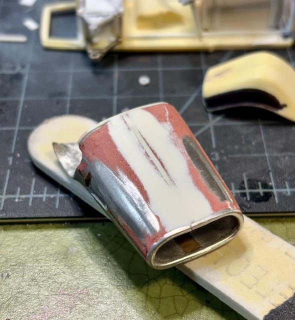

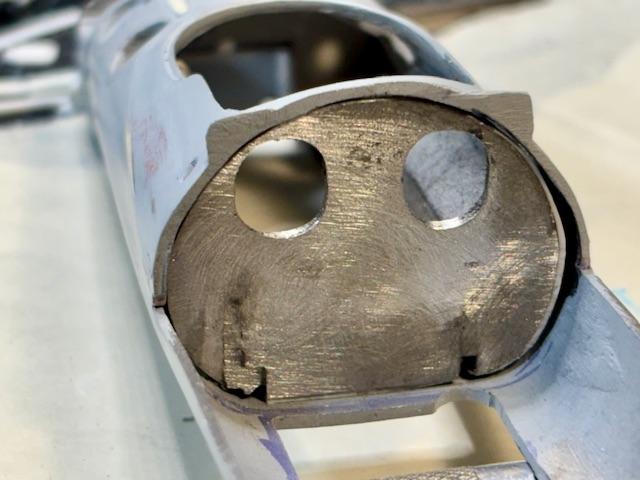

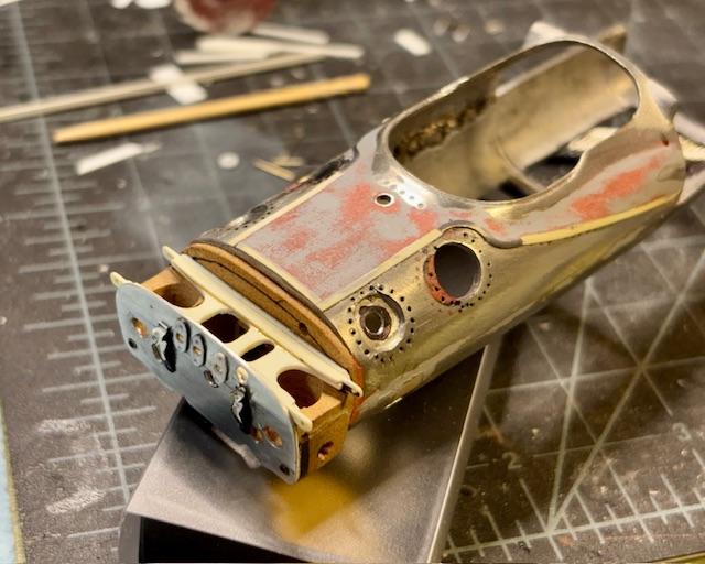

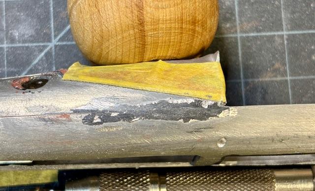

absmiami Posted May 8 Author Posted May 8 The nose needed some surgery - cut apart and put back together following 24th scale outline drawings made by the late Bob Clidinst - but putty shrinkage has left me with some surfaces that are relatively flat - needing correction …

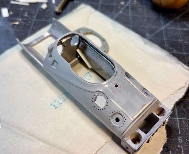

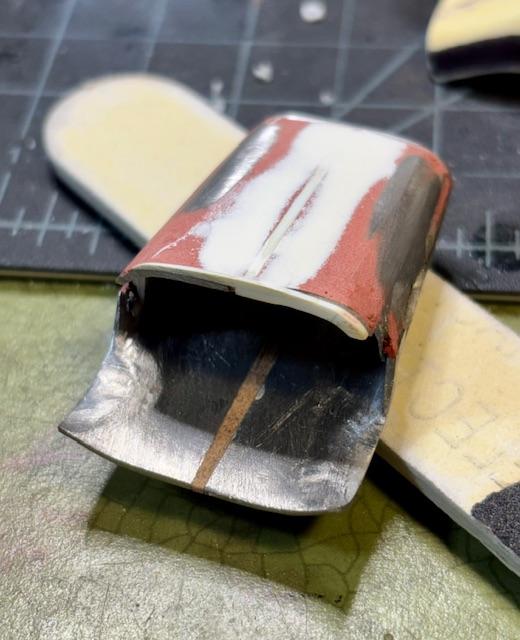

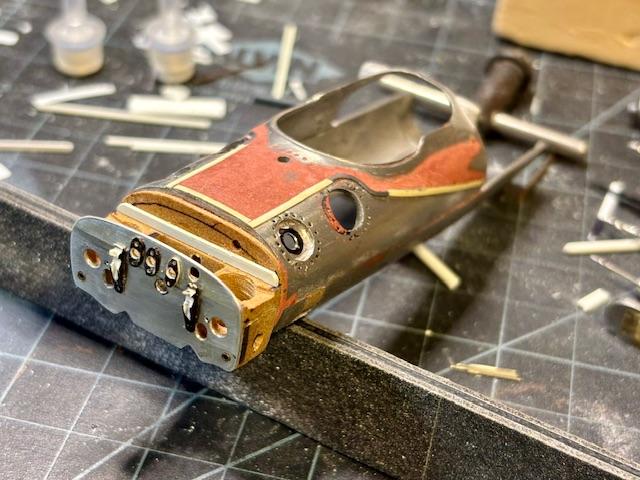

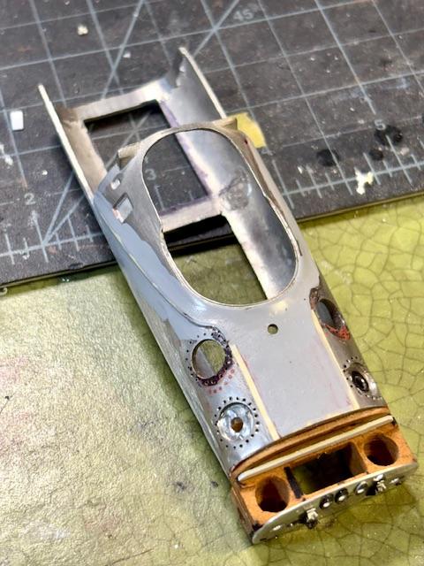

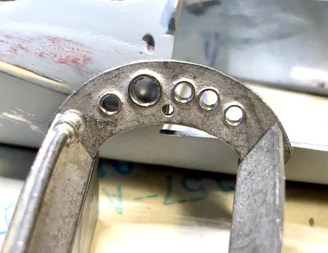

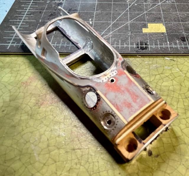

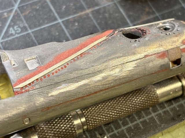

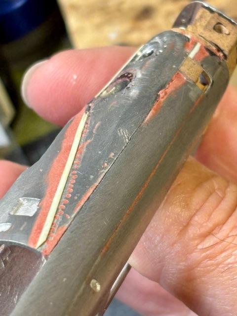

absmiami Posted May 8 Author Posted May 8 I’ve “re-skinned” the monocoque - this was actually Lotus’ first full monocoque design - to make more accurate rivet lines … i can add the rivets later - probably the Archer rivet lines decals - when i put the build aside i had gaps that i couldn’t bond well along the top/bottom seams …. Gaps that would surely open at the wrong time - like after i had finished the paint …

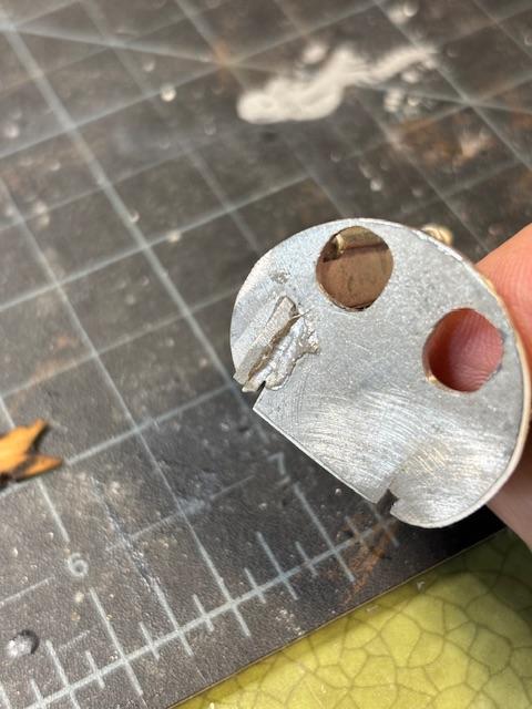

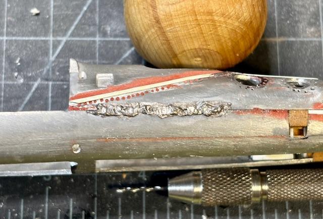

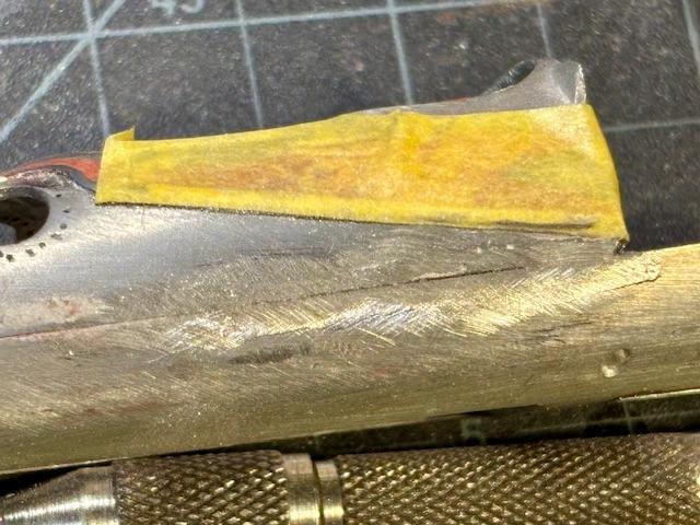

absmiami Posted May 8 Author Posted May 8 (edited) The low temp solder used in the Lotus 25 build was applied along the seams - it didn’t flow well into the seams - gaps - but i manged to apply enough solder to secure - i think - the seams … Edited May 8 by absmiami Sp

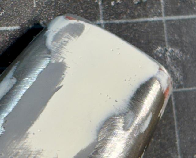

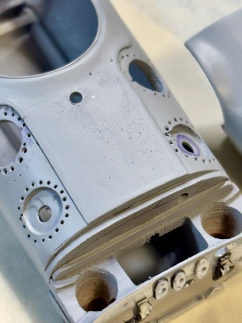

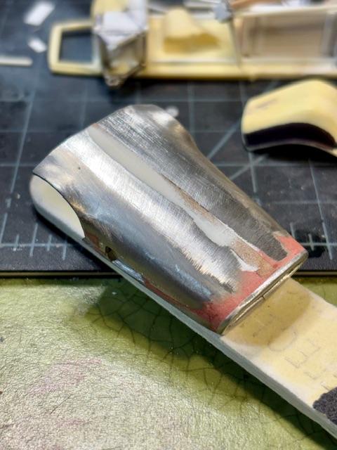

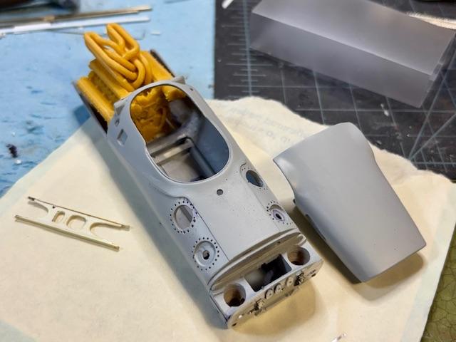

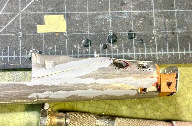

absmiami Posted May 9 Author Posted May 9 Tamiya fine putty - Mr Hobby’s Mr Surfacer - brushed on - and Tamiya spray primer …

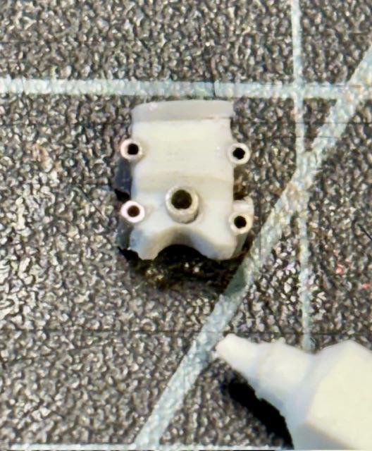

absmiami Posted May 9 Author Posted May 9 The Tamiya putty does leave a few pits - plan to try their new UV activated putty- probably solves this issue …

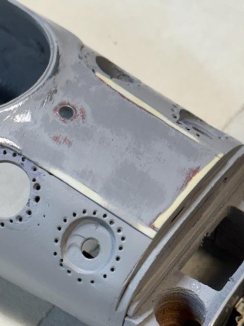

absmiami Posted May 9 Author Posted May 9 Almost there - seams are hidden now - need some mr surfacer on scuttle …

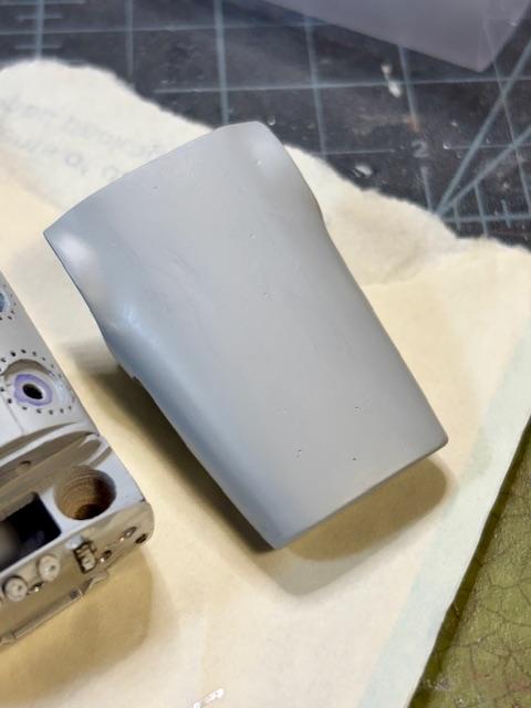

absmiami Posted May 10 Author Posted May 10 (edited) Gracias BK a coat of mr surfacer cleans things up … Edited May 12 by absmiami

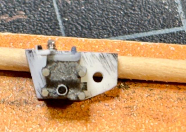

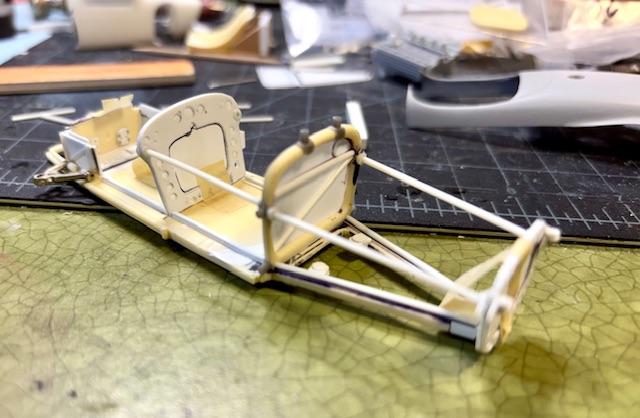

absmiami Posted May 12 Author Posted May 12 Will make - finish - and glue the bulkhead and driving compartment side panels in at an early stage - so i can then build out the left and right engine compartment “horns” - this added detail is needed to turn this fr a curbside into a detailed 38 -

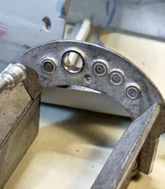

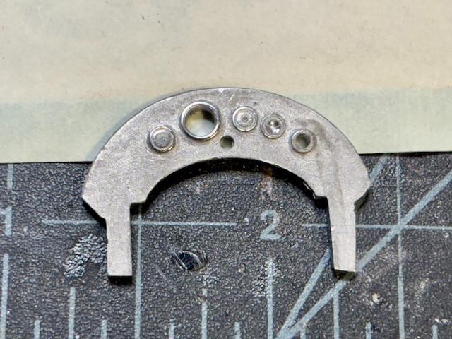

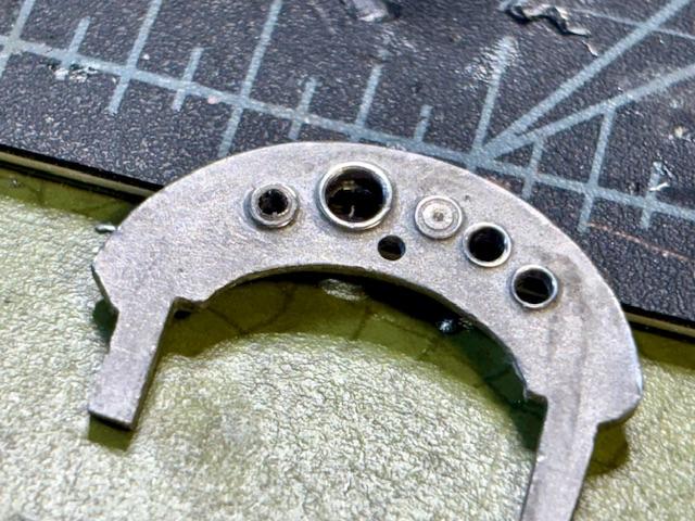

absmiami Posted May 12 Author Posted May 12 So I’ll have to make and attach the instr dash at an early stage - one of the nice things about wh metal is that you can polish parts to get a nice finished shine on certain features - like the gauge rings …
