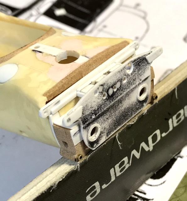

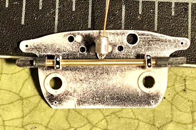

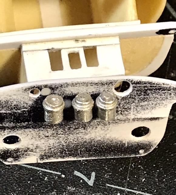

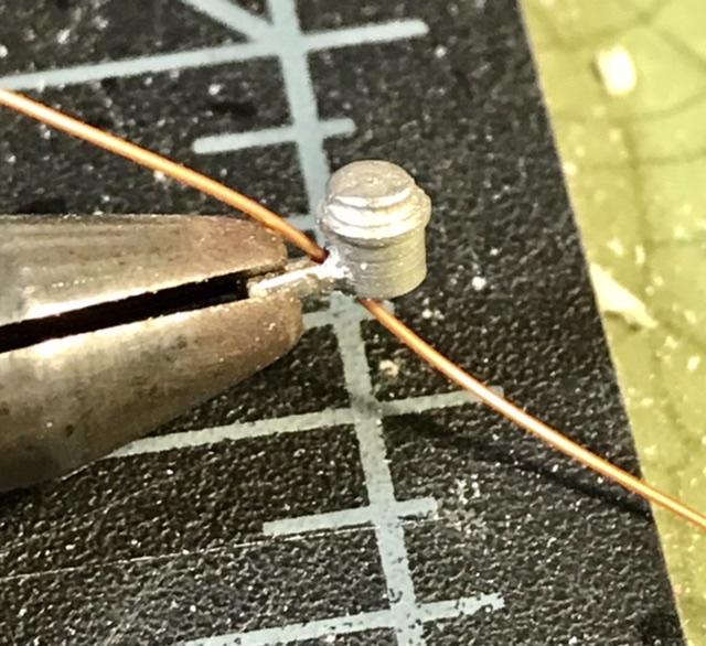

The clutch and brake fluid cylinders are spare white metal parts from another - older - project.  Got to add some flanges - The steering rack will be attached below these bottles.
On the real car - the rack sits level with the pivot brackets for the rocker arms - can’t do this in 24th scale. -  not enough room under the shell -  MFH was able to do this in 20th scale - don’t know how they did it - they’re pretty good !  Steering rack and oil tank next     -     I think ... unless I’m distracted and wander off again ...

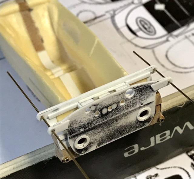

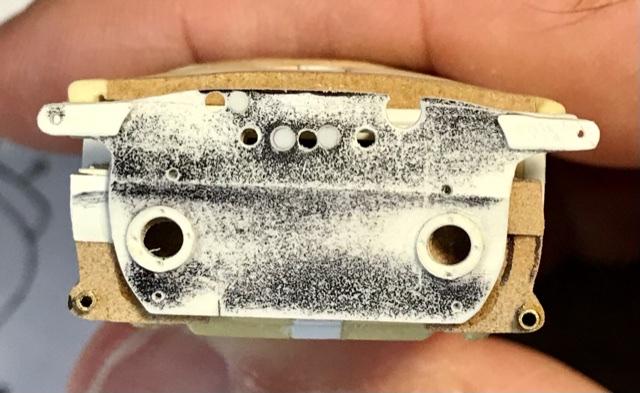

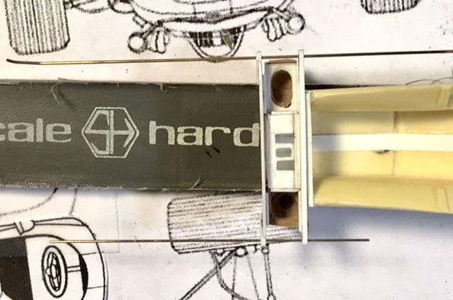

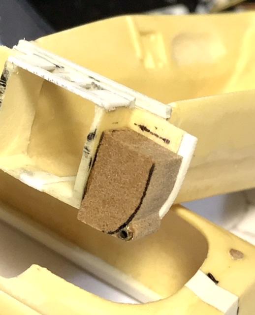

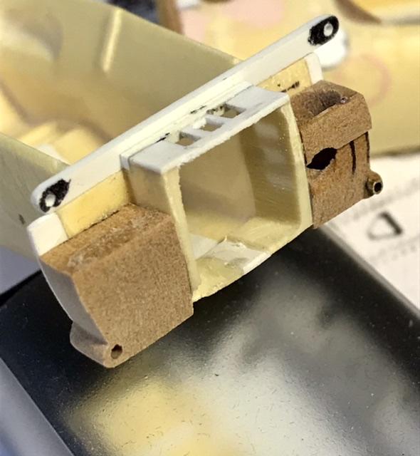

The fluid reservoirs have .040 “stems” -  just large enough to accept small drilled holes for the brake and clutch lines ...   the steering rack is .047 brass tube with some plastic “ears” and attachment brackets...   and I’m making the housings for the springs from some spare renshape ...  still lots of adjustments needed - including added width to the pivot points for The rocker arms ...   lots to do ...

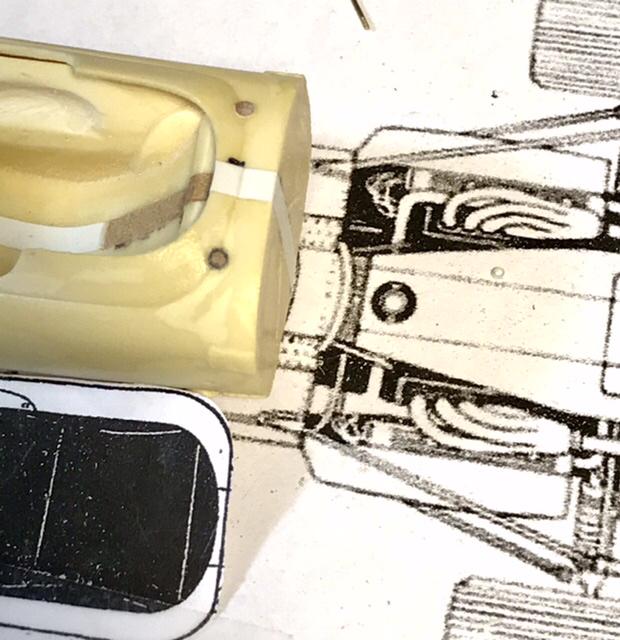

Right hand damper box in ...   more changes - widened the rocker pivots - them glued the front bulkhead in ... pins in the pivot holes while the epoxy sets - need the pivot holes square ...
Notice that the bulkhead has lost its rounded profile on top - just not enough room in this scale to fit the nose and keep the correct profile - but the fluid reservoirs still fit - that’s OK ...

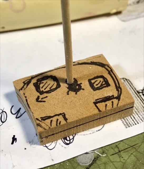

Thank you for that question. It is the scratchbuilder’s secret weapon -  that is unless you can draw and print your own parts ...  it’s Renshape ...  this is the medium stuff. Easily shaped with hand tools. The files and random toothed cutters by PermaGrit are best for this. -   It’s like wood without grain ...   expensive but necessary if you want to make your own whatever ...
That’s what I thought. I think it’s the same stuff that you are using for your Bugatti. If your Renshape is not brown - it’s a different density ...  but basically the same
stuff. -  by the way - you must take the Bugatti to the last GSL to compete in the salt lake / land speed category - and you will have some competition. ...
Looked again -  I think you are using  the same density  -  and I too am a big fan of the late, great Chris Ethel ...  got an idea ...

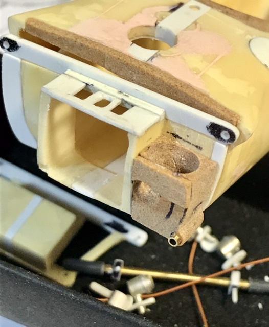

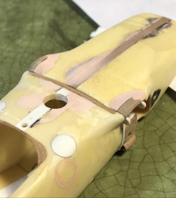

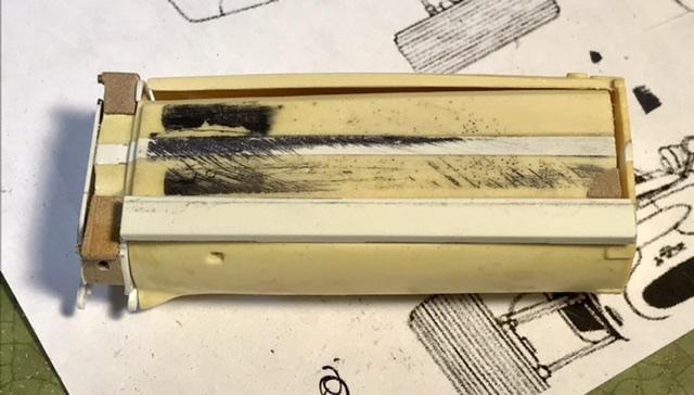

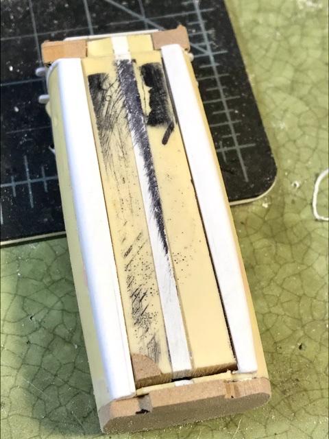

HOT BENCH ...  there’s plastic, Renshape, and resin flying everywhere ...  studying the Lotus 43 build on the Brit Modeler site I realized that the car has curved panels at the base of the monocoque that house some of the fluid lines ...  making these with Evergreen strip ...

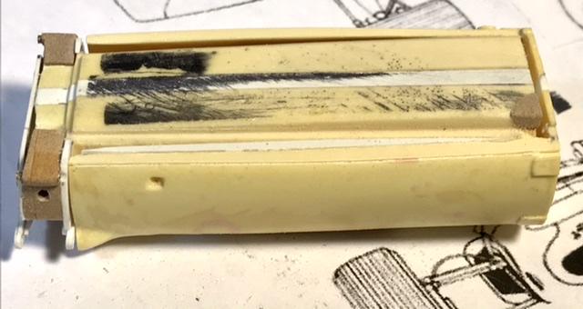

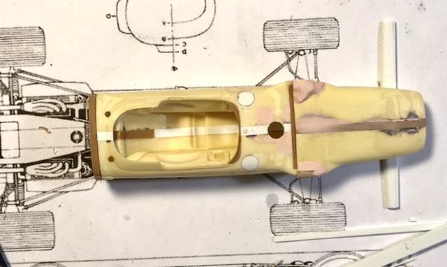

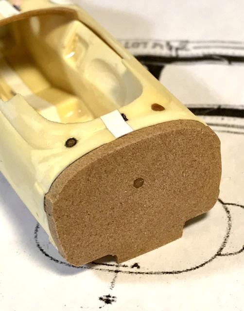

The drawings I’ve got suggest that the Joker resin monocoque is a little short - and this is confirmed by studying the 20th scale MFH build ... so it’s back to the Renshape for the added scale 2.5 inches at the back - and this piece will also serve as the engine bulkhead ...and this should enable me to nail the wheelbase ...

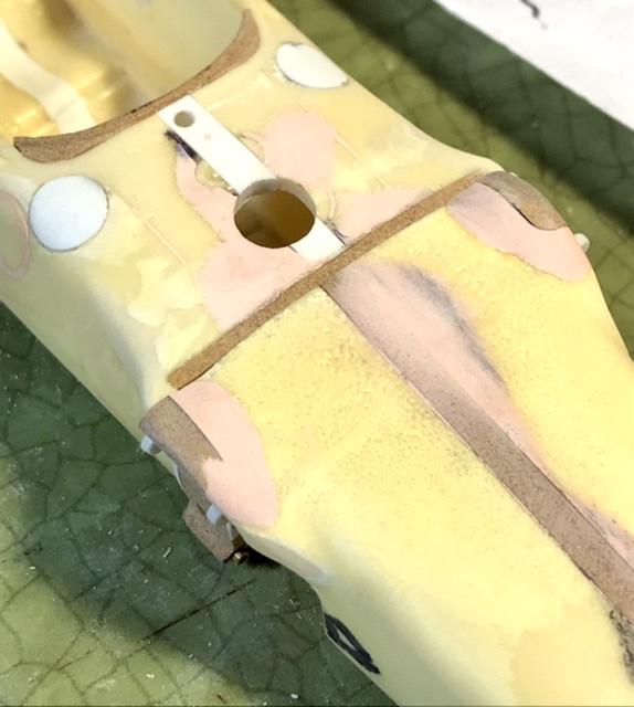

Reaching a point where this build is ready for a nap -  evergreen strip was cut and sanded to make lower rocker panels that housed - I think - the lines to the two water pumps -  and I’m shaping the ridges that covered the suspension pick-ups - these have a different shape than the Lotus 49 - hard to match - MFH’s 20th scale kit got it close to right - mine will be - okay ... the main thing is I’ll be able to fit all of the major components in the forward section - under the nose - somehow ...

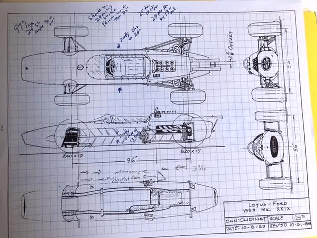

Drawings first- the late Bob Clidinst drew many Indy cars - this is a copy of his 29 drawings on grid paper - to 24th scale ... the notes are mine ...
Clidinst lived ten minutes from the Speedway and volunteered there - he was given access To the Museum cars and he measured most if not all of the cars that he drew - I’m pretty sure he got the 29 dead to rights - all of the published measurements correspond with the drawing ...
