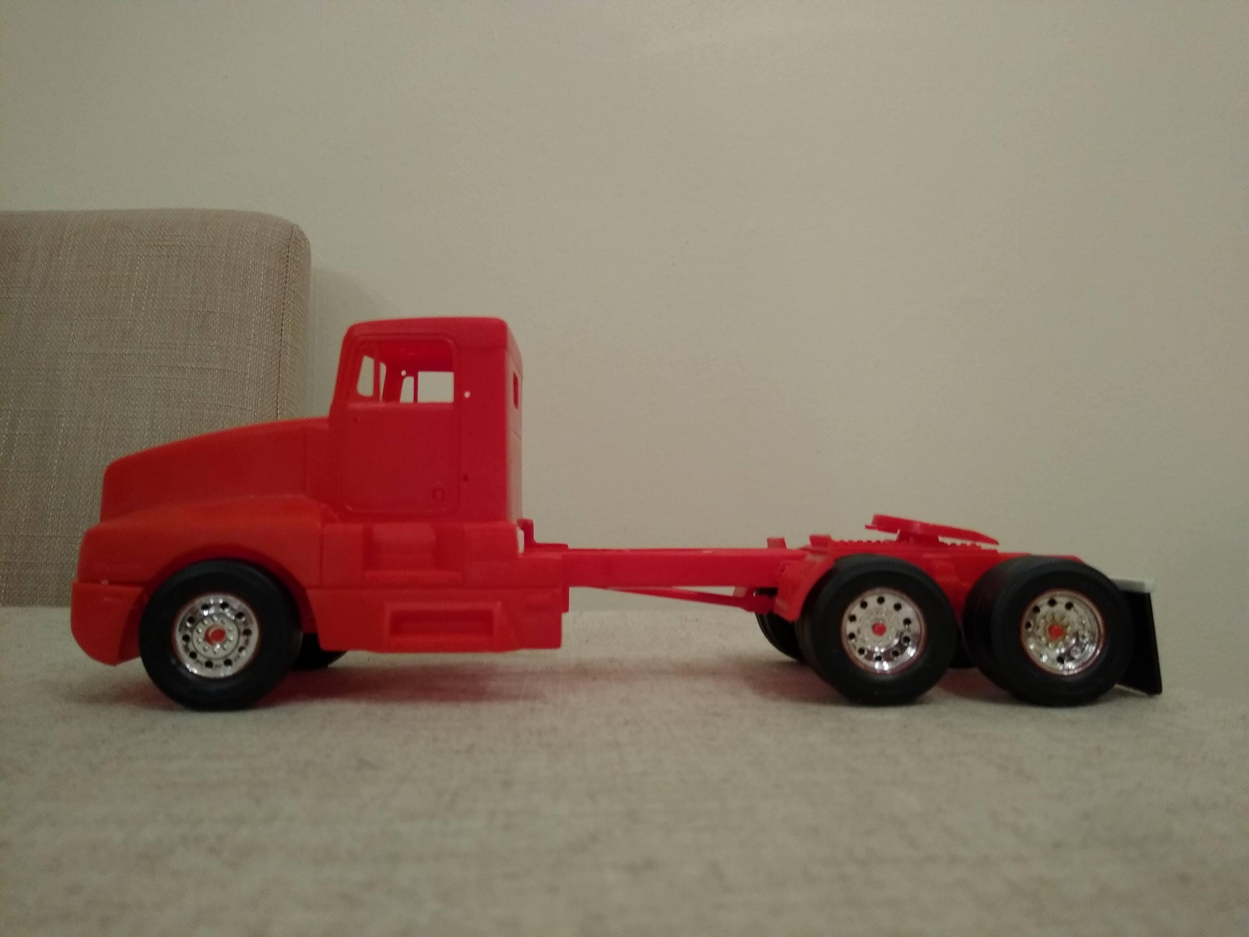

Aerodyne03 Posted August 17, 2020 Posted August 17, 2020 Nice, I'm curious to see it being painted Do you do it exactly in the color in the photo you are inspired by? You did a great job of scratchbuildibg on the small parts??, the only thing I have doubts about is moving the tanks under the skirts ... in theory under the skirts there is often the battery pack, if you move them you I would still recommend leaving the part of the tank with the cap in one place unless you want to pierce the side skirts (these are t he advice of a fixed model maker, then the important thing is that you like the truck and you have fun?? )
Rockford Posted August 17, 2020 Author Posted August 17, 2020 Enrico, it will be black chassis with a white cab and a little stripe along the side, pretty much as the truck in the photo though a little longer chassis. On the fuel tanks and battery boxes, I thought e exactly the same and was going to omit one tank, or shorten one etc... and then I realised there's no battery boxes there on the kit and I could go to all that work for something that will never be seen. So, I'm going to move the tanks and imagine they're shortened because it's a day cab on short runs so it doesn't need two 200 gallon tanks. It's the overall effect I'm going for with this, so that it looks ok on the shelf.
Aerodyne03 Posted August 18, 2020 Posted August 18, 2020 Right, you're right, in the end the important thing is that it looks good, I like the truck in the picture, so I'm waiting for updates??

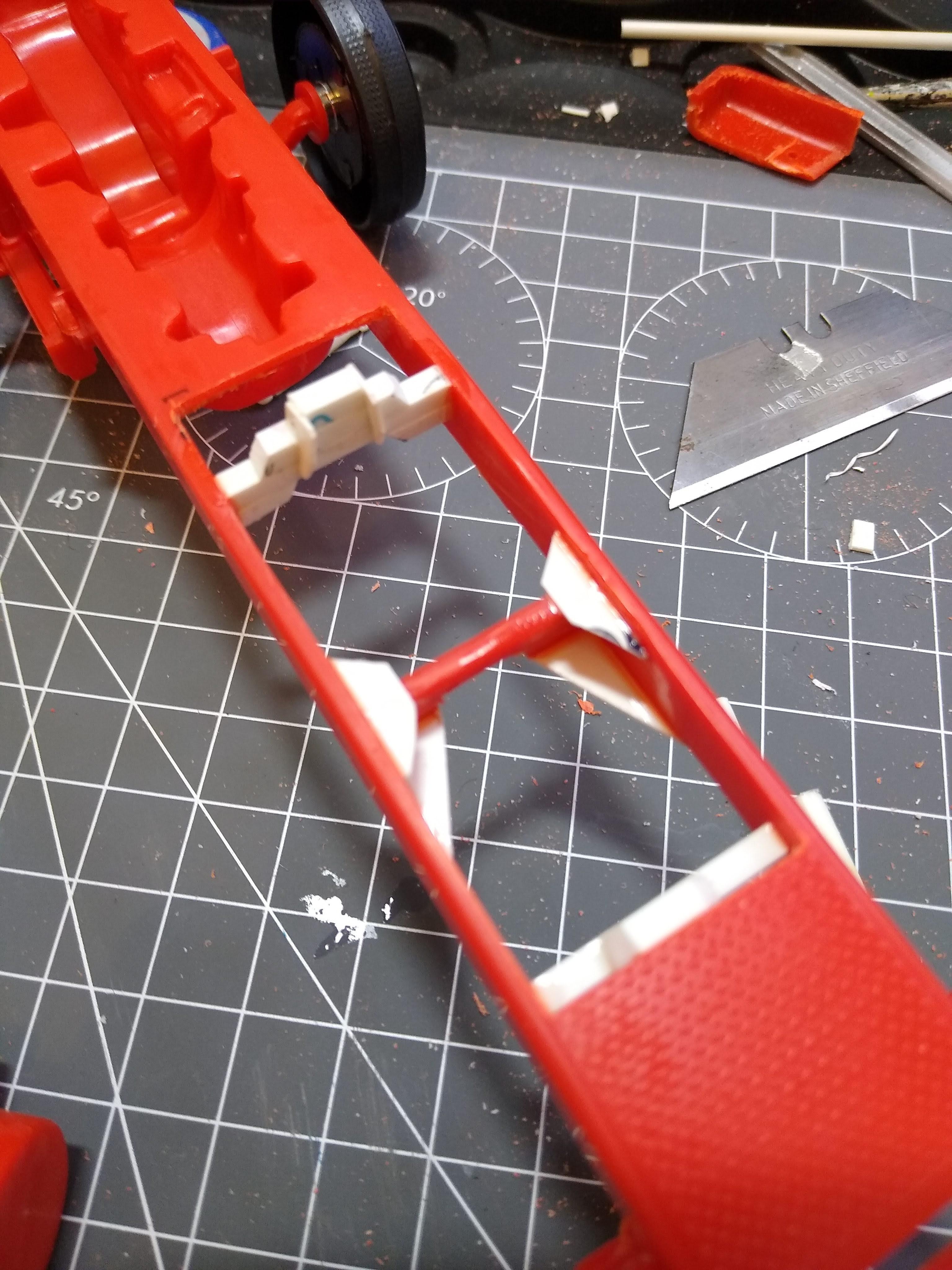

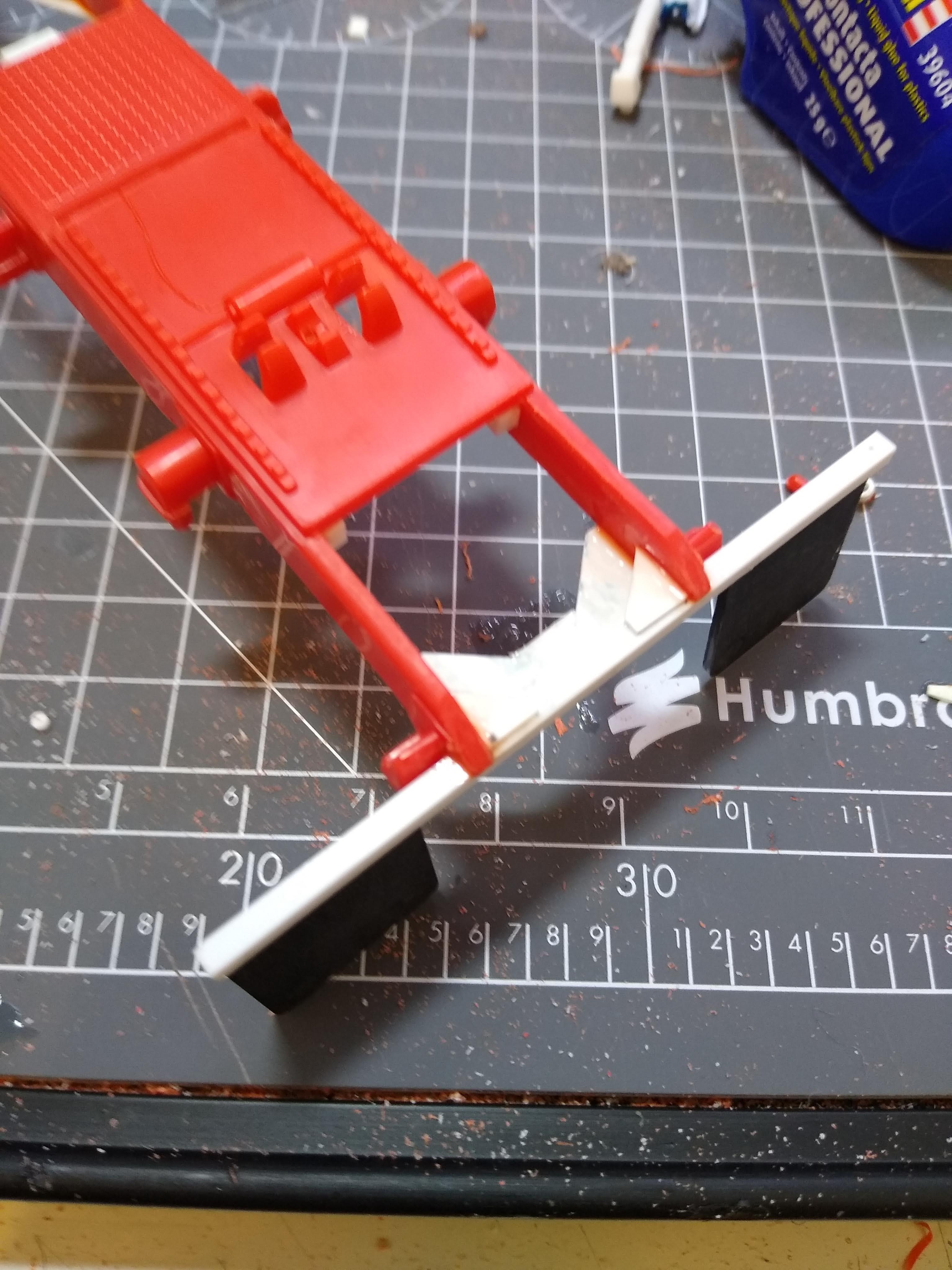

Rockford Posted August 21, 2020 Author Posted August 21, 2020 Added detail to the exposed chassis. Using plastic card I made some fillets for the crossmembers. Using square plastic rod I fabricated the crossmember for the rear cab mounting and a smaller one for the pogo stick just in front of the tread plate. With the majority of the work done it's time for a quick mock up and looks ok. I know when I prime the cab the joint of the new rear wall will stand out like a sore thumb no matter how much I have rubbed and filled, so I'm braced for that. Anyway, they reckon filler works better over primer.

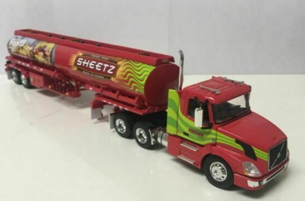

Aerodyne03 Posted August 22, 2020 Posted August 22, 2020 The trailer you posted was also done by the heller complete with a tractor, but be careful because it is a very short trailer ... I don't know if your modifications include that of lengthening it, however in America the trailers exceed 16 meters, if I if I were in your place I would try to opt for a nice tanker, of course it's just a humble advice it's you who must like the truck??
Aerodyne03 Posted August 22, 2020 Posted August 22, 2020 You may find something like this on ebay if you're interested ...??
