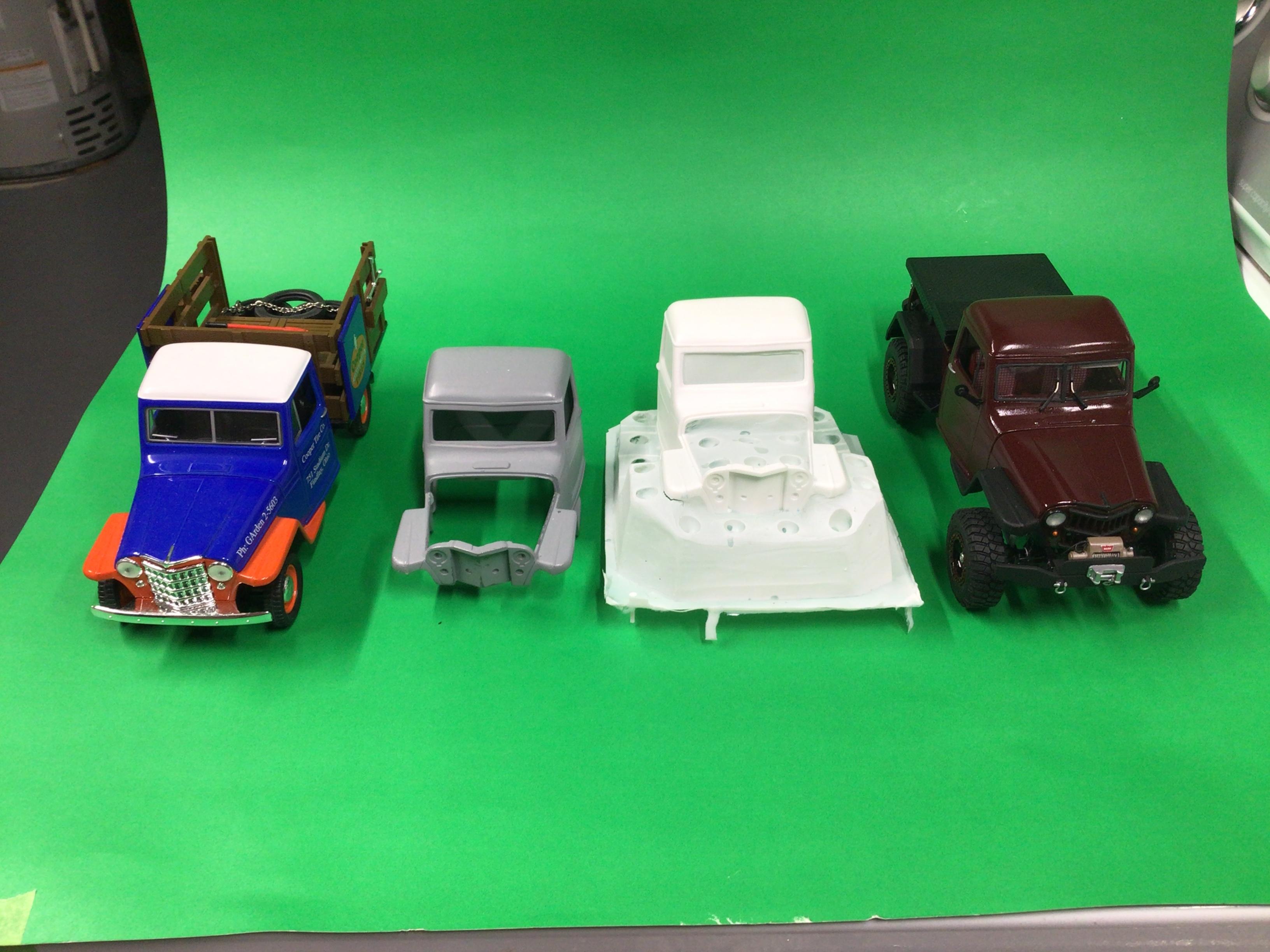

Another model mag, S___ A____ often had die-casts modified using brass and solder, so it can def be done.  Don't think I'll try it, with the modeling time I have left at 76.  The only problem, possibly, using resin stuff like JB Weld or epoxy is the differential in heat/shrink time vs. metal in such dissimilar materials; eg. don't let your finished product get extremes of heat or cold!  Like all the 1/1 guys in the 'sixties who tried to graft fiberglass hood scoops onto their cars using epoxy and/or bondo, you will eventually see cracking -- tho possibly it will be very minor.  Just sayin'...

Thanks for the caution James. I could see the filler possibly separating under extreme temperature swings. No worries though since I cast the entire cab in resin once I had the corrections made. I was not after a corrected stake-bed, but a copy of my 1:1 truck.?

I’m glad I found this thread. I decided to just jump into the deep end with a die cast project. I don’t know if I would have thought of Milliput, even though I have used a lot of it on styrene projects.
Nice work on the pickup, BTW.
