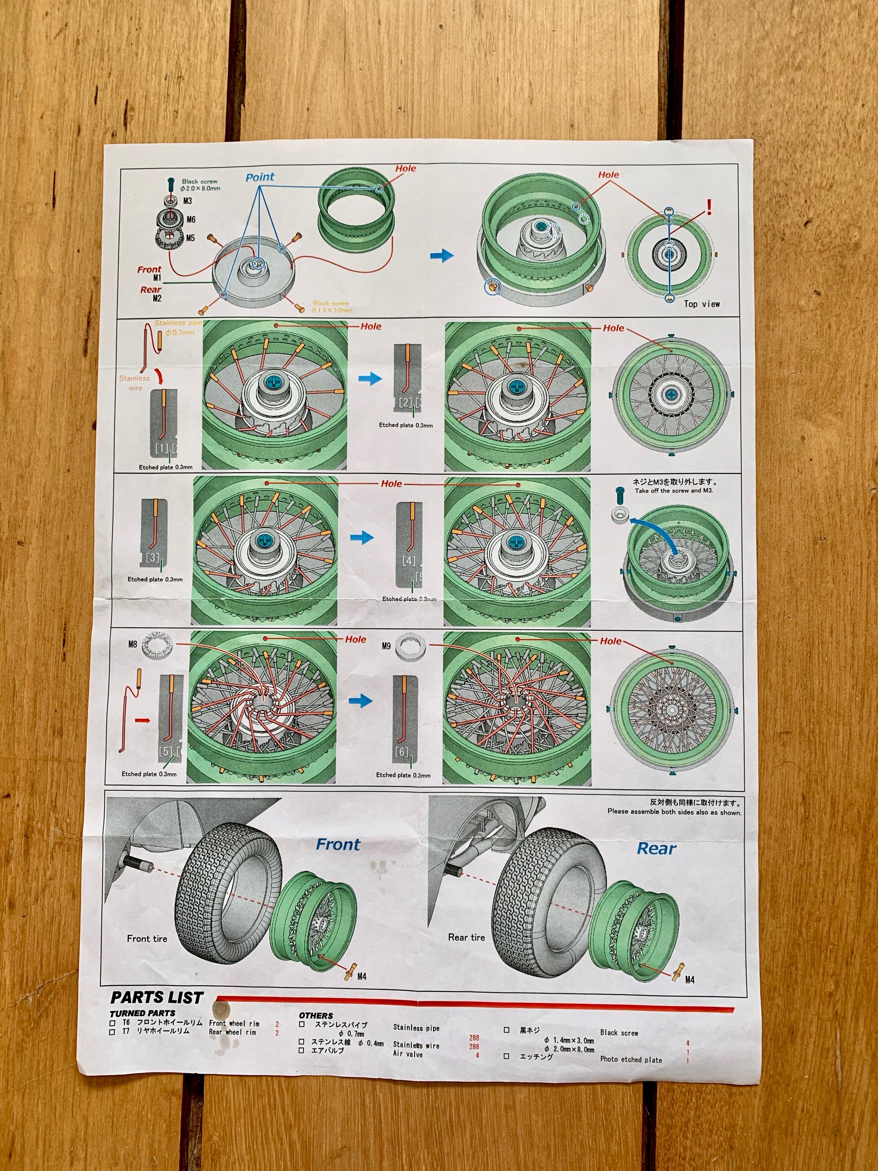

I've got no tips or techniques to pass on other than to thoroughly read the instructions so you are conversant with the assembly process and then everything will come together without issues.

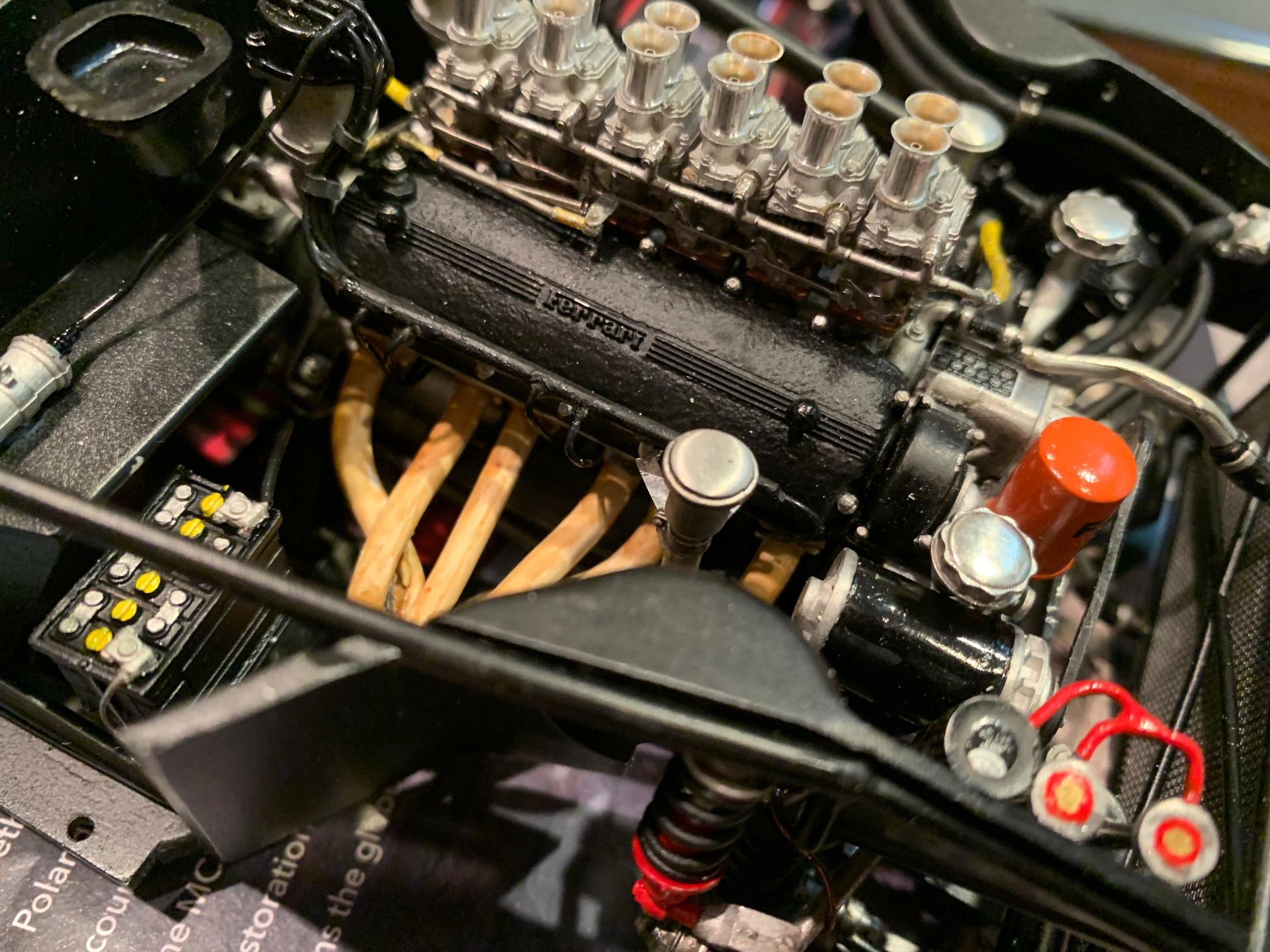

Thanks so much for your responses! I say, with no sarcasm, that I am sure most on this forum are far more expert than I and the advice is very much appreciated. I'm certainly trying to follow the instructions and have the wheel rim and hub properly mounted on the jig. Did you in fact cut each spoke individually before putting it in place? I have initially tacked them in place with CA, with the intention of reinforcing around the rim with epoxy once all spokes are in place. Does that sound sensible? Is there some other fastening technique that I should be using? Did you modify the inner hubs or simply assemble them as supplied?  I can't help but think, due to my inexperience, there is some "expert" technique that is eluding me. Perhaps I simply need more time and patience, but I am also in the process of personally restoring a full-scale Ferrari (not a  250 GTO, alas) and, at 72 years of age, try to prioritize my projects. Attached are some photos of portions of the model I have already assembled.

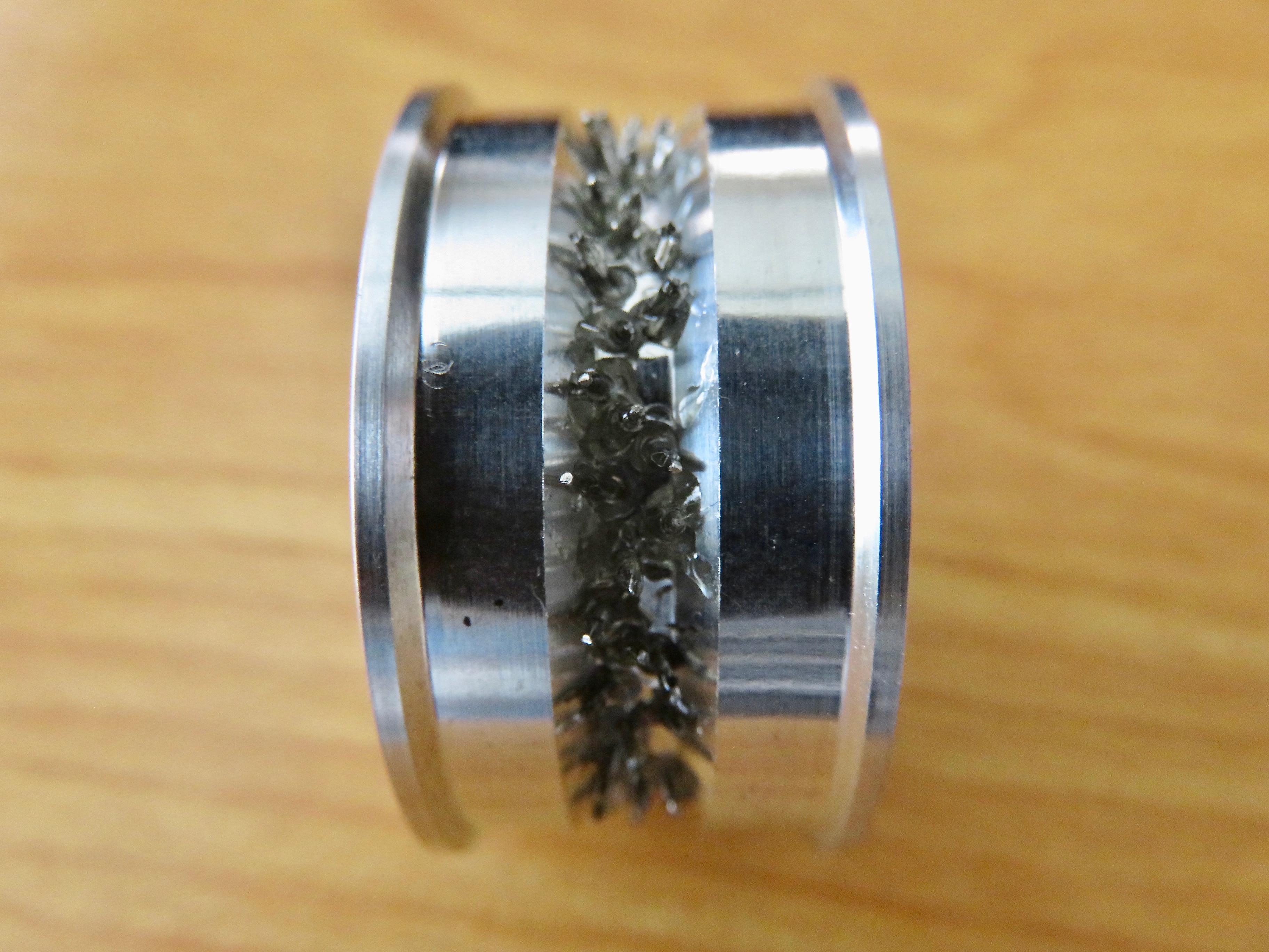

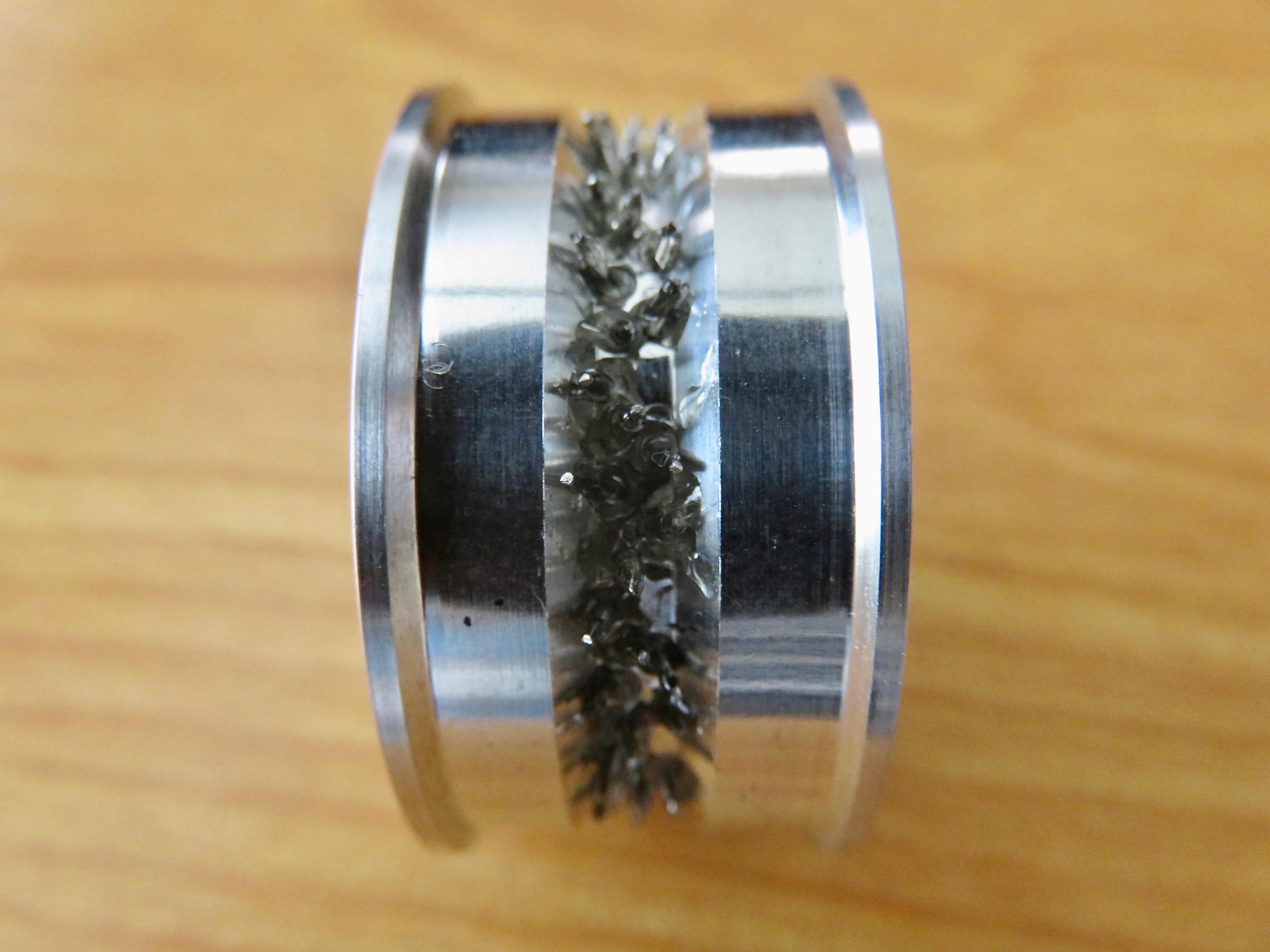

You've done an excellent job Day.  I just left all the spokes at the supplied length during assembly and tacked each one to hold in place till the rim was assembled then  slopped  a healthy amount of epoxy in to the grove to ensure a solid structure.
It all looked like a hedge hog at this stage and I then went around with the snippers and cut off the protrusions

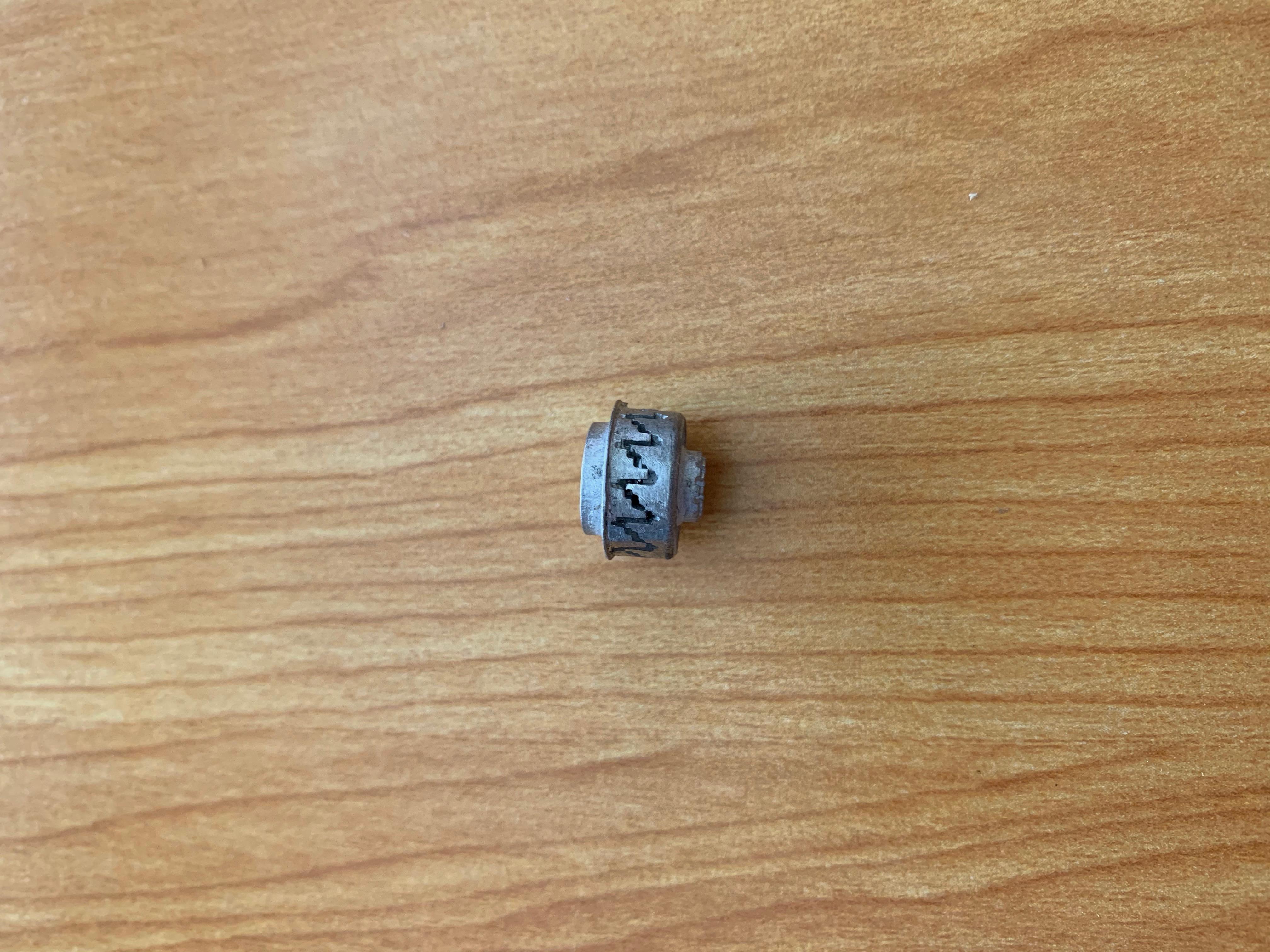

The  inner hubs in my kit were of a poor quality  when you put the two pieces together so i ran JB Weld in to the  the gaps and redrilled the holes with a pin vise to ensure the spoke were positively located.
I can't help but feel there has to be a better way to manufacture that inner hub to ensure a more positive fit for the spokes but working with what was supplied it worked out okay.

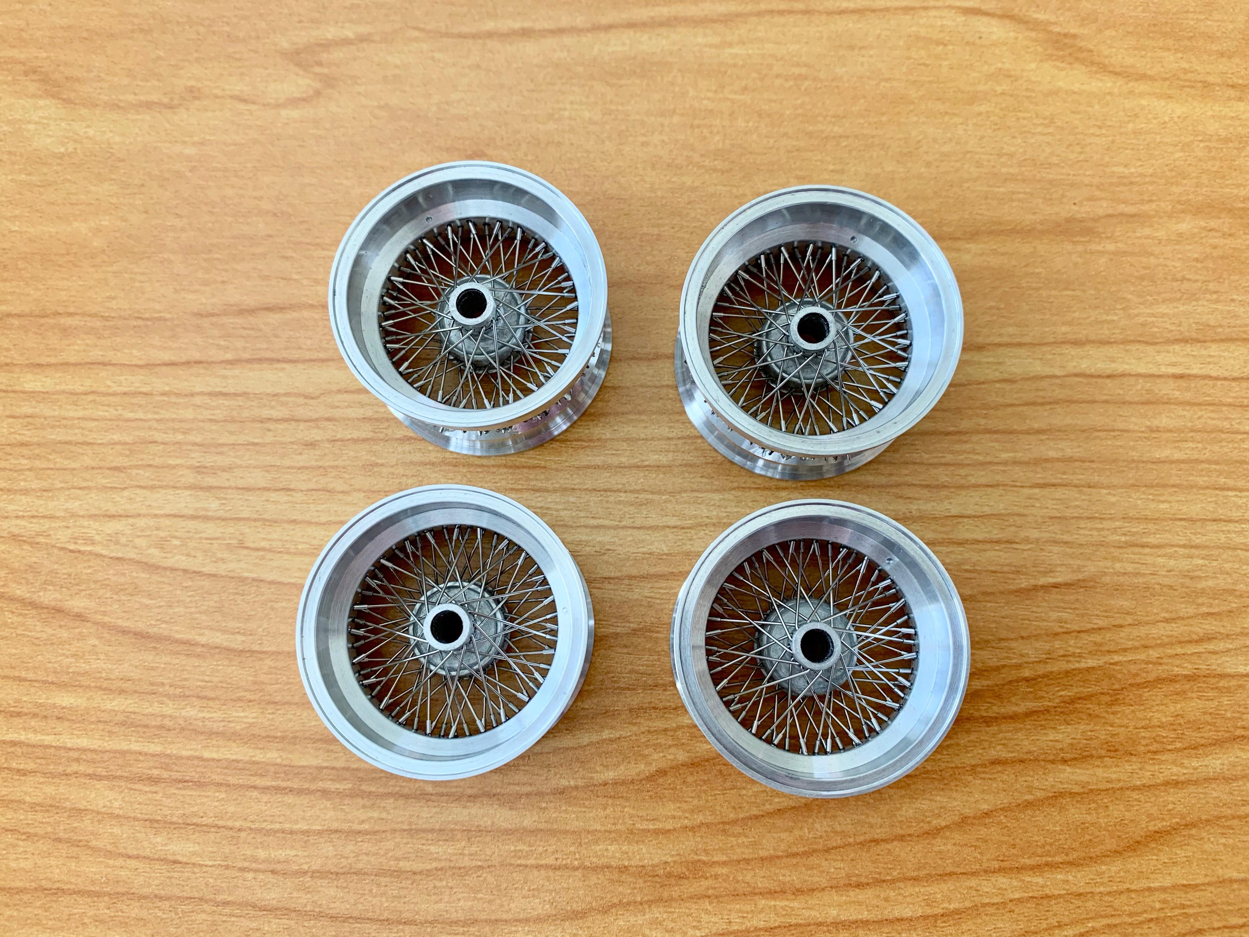

There is no rocket science or special techniques needed to assemble the rims. Once you've  got your head around how it all goes together the rims don't present any dramas.
Thanks so much, Ron. I believe you have given me the inspiration to "tough this out." On my second wheel, I will give special attention to preparing the inner hub. I didn't send pictures, but the car body is finished and also looks great. I'm anxious to finally put everything together.
