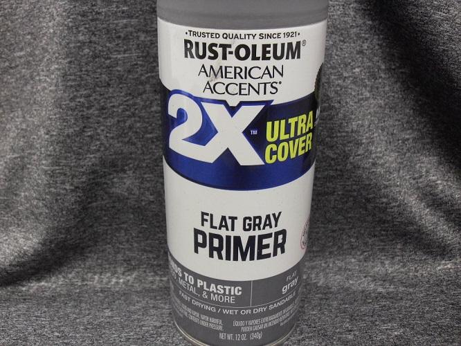

Hey, Guys.... I was doing a spoon test of some Tamiya paint over two different shades of primer. I had some DupliColor sandable in dark gray, and Rustoleum 2X flat gray... I was surprised to get two completely different finishes from the two primers. I know that sandable primer is meant to be sanded to smooth it, but had no idea it was so porous. The Rustoleum though the finish is a lot smoother right from the can. You can see in the pic the spoon on the left that was primed with the Rustoleum.... The color is richer and more uniform, where the Duplicolor primed one on the right is all blotchy....
I didn't sand either spoon. Also, the Rustoleum is meant for plastics (says so on the can).....

DupiColor primers are really too "hot" for bare plastic.... Their perfect match paints work just fine over the Rustoleum, though. I still like the Perfect Match paints, I just think maybe I've found a better primer for myself.
