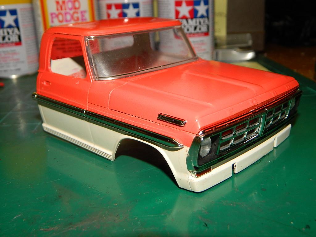

Great looking interior. By they way I'm an Orange fan on automobiles also. The down side is the you become very visible in traffic and get tickets even when your not doing anything wrong. I had a '69 Camaro in Hugger Orange that I owned twice for a total of 18 years. BLAH_BLAH_BLAH_BLAH thing almost cost me my license more than once.
Thanks David!  I think I may have to strip and repaint the body.  Way too much orange peel and a lot of the paint is coming off as I polish the orange.  I really don't like this enamel paint and I may try to find something close to that shade.
I have used Model Master Chevrolet Hugger Orange and their Grabber Orange that is a little lighter and is supposed to be a Ford color so that might work. I used their Go Mango on a Sedan Delivery once and almost like it better than the Hugger Orange, but that's only my opinion. Tamiya offers an Orange TS-12  that is real bright.

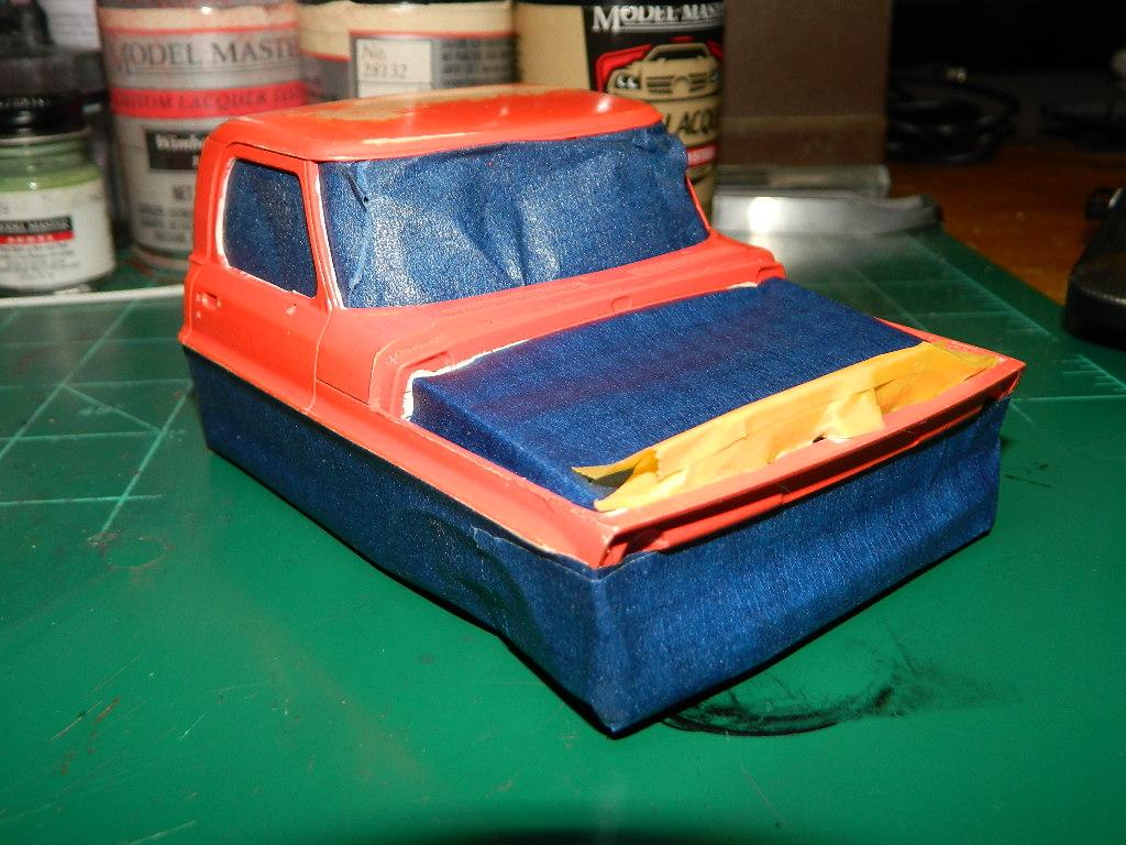

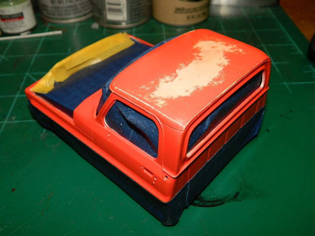

I tried to polish the paint and went through the paint.  Another masking and it is back into the paintbooth for another respray.  After that was done, I detailed the grille using my Sharpie markers, Tamiya Flat Black paint and Tamiya Panel Line Accent Color.

I went and painted the body and hood again with Testors Competition Orange and now they are in the dehydrator for the next 8+ hours.

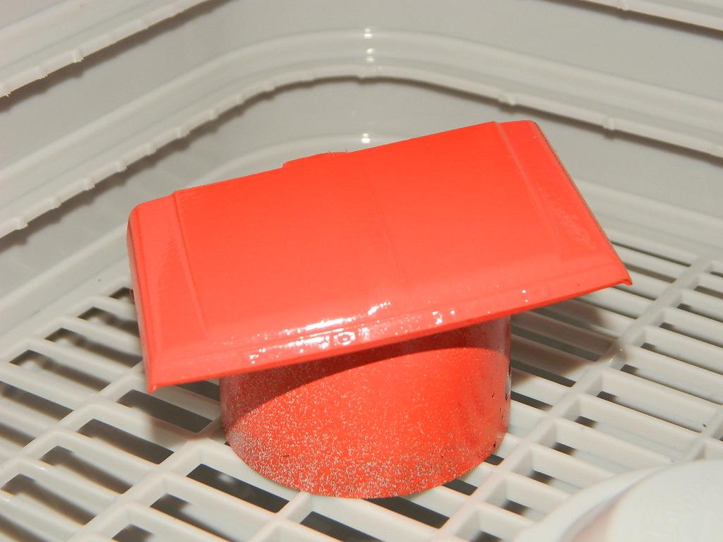

The grille was the least of my concerns.  I sprayed Testors Competition Orange on the hood and roof and placed them both in the dehydrator for 18 hours.  They are slightly tacky, but are, for the most part, dry.  I'll leave them alone for a while and then consider my next move.

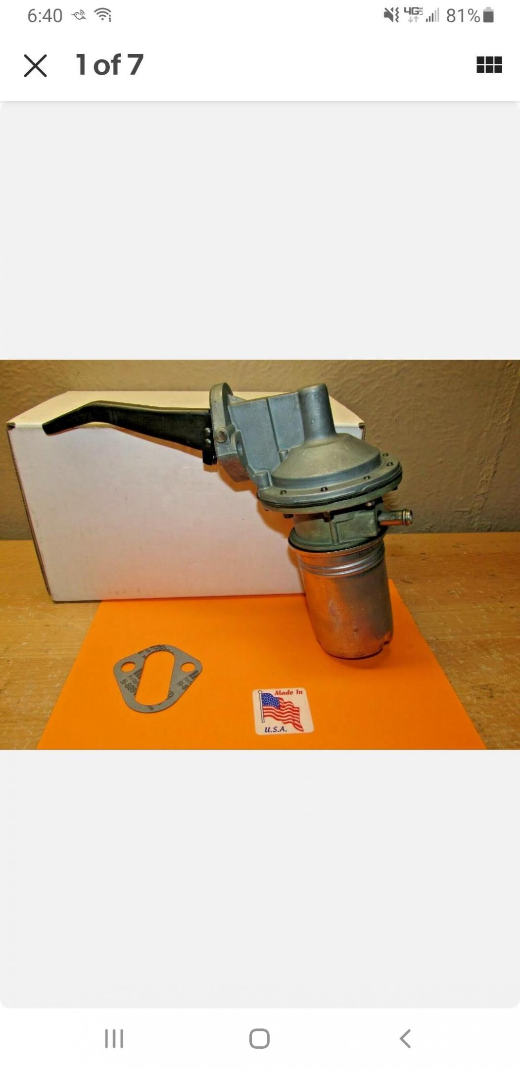

On 10/29/2020 at 11:13 AM, Painted Black said:
I think this is what they were shooting for..standard on some FE Fords.
I think this is what most of us are used to seeing.
I have reattached the bottom portion of the fuel filter.  Since many have shown me that the fuel filter is a long and complete unit, on and off the forum, I wasn't aware that the filter portion was added to the assembly.   Now, I know better!
