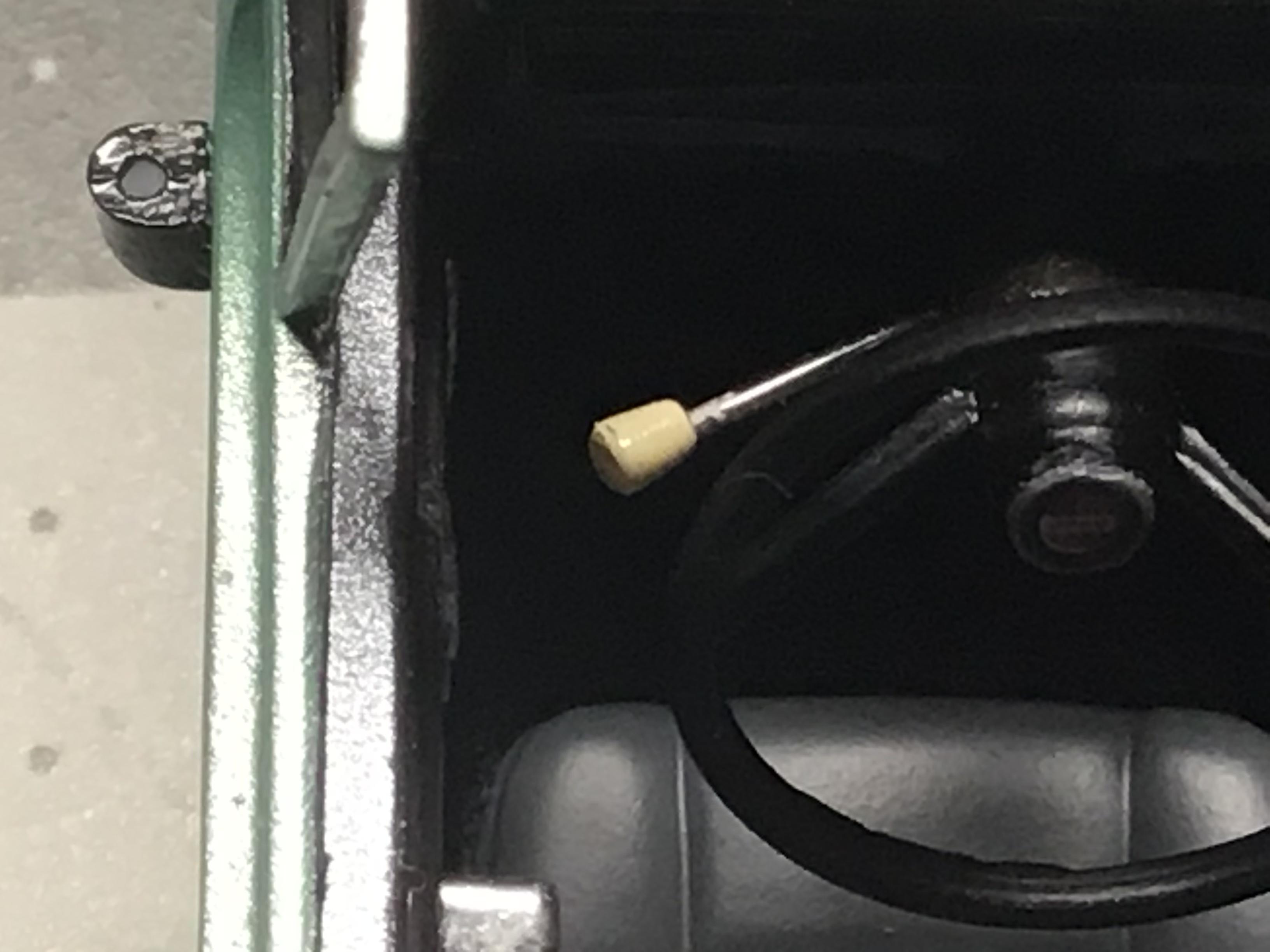

NOBLNG Posted December 21, 2020 Posted December 21, 2020 (edited) That’s how I made this turn signal knob. I then put it in a pin vise in my drill and shaped it a bit. Edited December 21, 2020 by NOBLNG
misterNNL Posted December 21, 2020 Author Posted December 21, 2020 Nice job Greg. Yours looks a lot more realistic than mine does. Mine is in one of those closed interiors where they will barely be seen if at all. Have a meaningful Christmas season.
