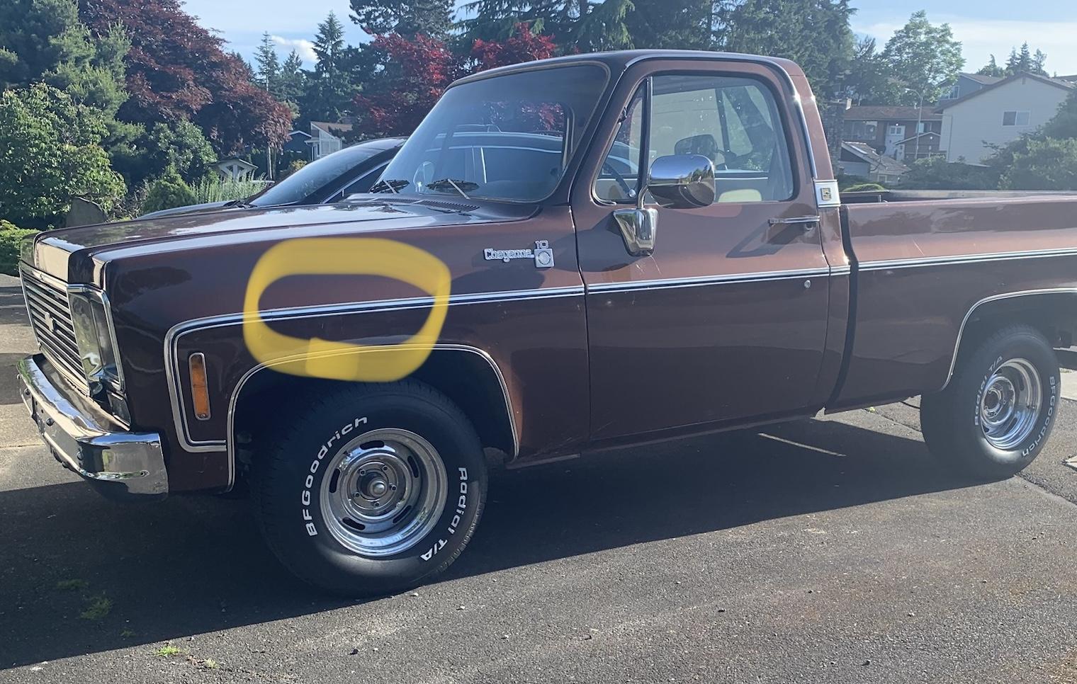

Vince311 Posted January 8, 2021 Posted January 8, 2021 I’m going to be building a Chevy Swb truck similar to the one in photo. I’ll be Using the snow plow gmc truck as a starting point. what is the best way to create the body molding? (As circled) thanks!

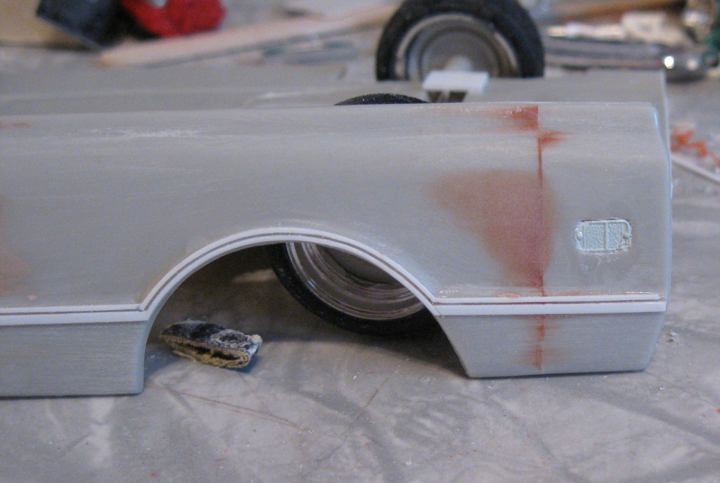

Casey Posted January 8, 2021 Posted January 8, 2021 It's going to ne very difficult to replicate the molding, due to the recessed area, but for the basic shape, see here: You could create the molding with multiple pieces, spacing them properly as you adhere each piece to the body shell, but that recessed area might be too small in 1/25 scale to bother with, too.

Can-Con Posted January 8, 2021 Posted January 8, 2021 You can get pretty close using a couple sizes of plastistruct strips. Carefully glue the wider one on first with liquid cement, let it fully set for a day or two and glue the narrower one on. Worked pretty good for me. I added the trim on the box to match the existing trim on the cab.
Vince311 Posted January 8, 2021 Author Posted January 8, 2021 10 minutes ago, Casey said: It's going to ne very difficult to replicate the molding, due to the recessed area, but for the basic shape, see here: You could create the molding with multiple pieces, spacing them properly as you adhere each piece to the body shell, but that recessed area might be too small in 1/25 scale to bother with, too. Thank you! Looks like super thin styrene strips. That could work. I think etching might be a bit to much. This should be fun

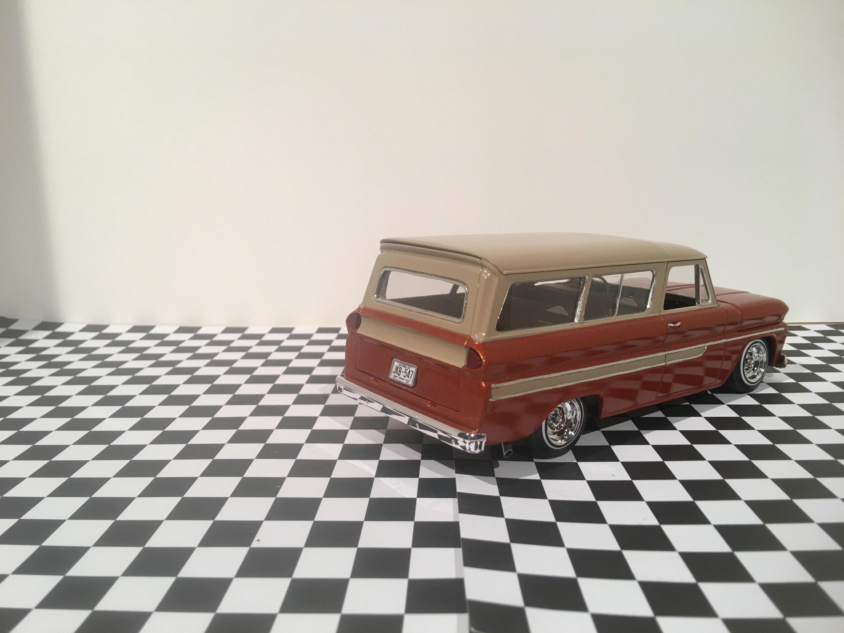

espo Posted January 8, 2021 Posted January 8, 2021 I used a combination of 1.5 and 2 mm half round Plastruct to create side trim on the Suburban. They also offer flat stripes that may better represent the side trim you're trying to make. The scale is such that the black colored stripe my not be visible anyway.
