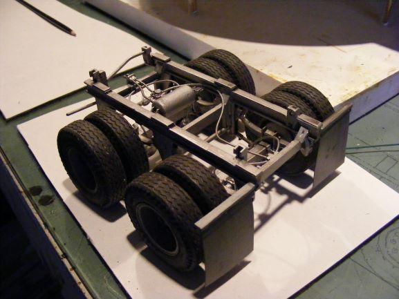

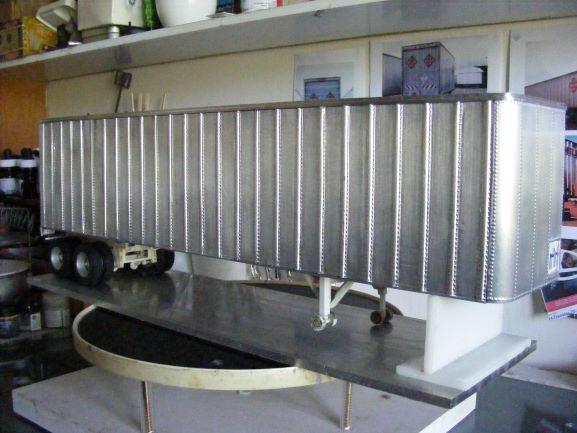

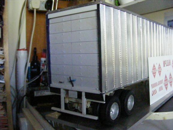

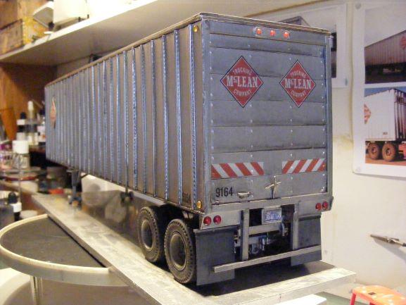

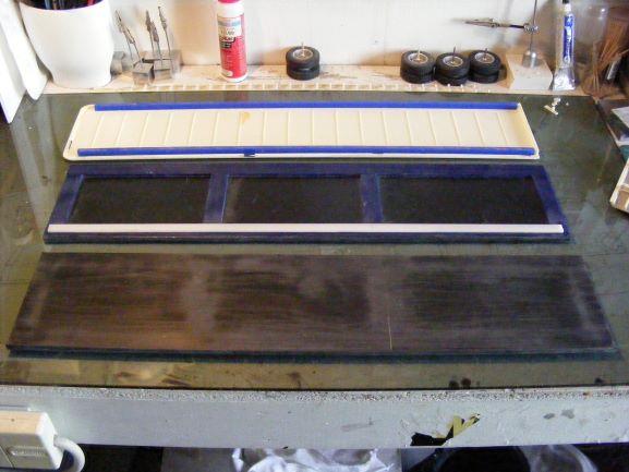

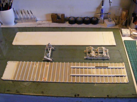

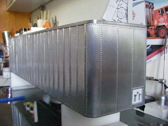

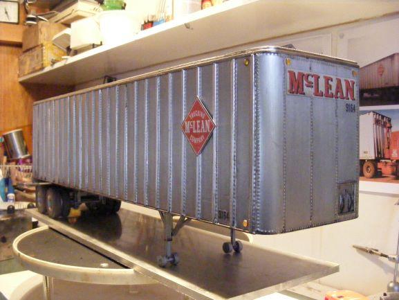

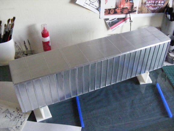

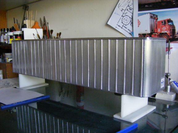

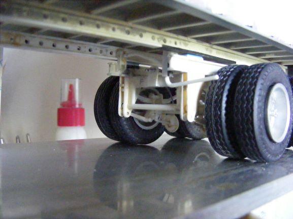

The Brush Posted January 20, 2021 Posted January 20, 2021 Hi, Some build pics of the trailer, made from AMT parts for the frame & axles etc. the box was made from perspex & plastic card covered in thin aluminium pressed on a side panel from the 27ft trailer kit, the rivets then added with a dress makers pounce wheel & a compass pin, these ali panels are stuck on with double sided tape, washed & weathered then finished in satin clear, Mud flaps are thin rubber sheet, Also a picture of the decals i printed on white decal paper. Fleet numbers are on clear decal paper.
doorsovdoon Posted January 21, 2021 Posted January 21, 2021 Looks amazing! Some seriously nice work there, very nice.
hct728(Bob) Posted January 21, 2021 Posted January 21, 2021 Amazing detail on that! You say “thin aluminium pressed on a side panel from the 27ft trailer kit, the rivets then added with a dress makers pounce wheel & a compass” now that’s an inventive way of duplicating an improving upon a kit piece! I’ll be trying that myself! Love your authentically weathered Mcleans tractor too, keep up the creativity!
