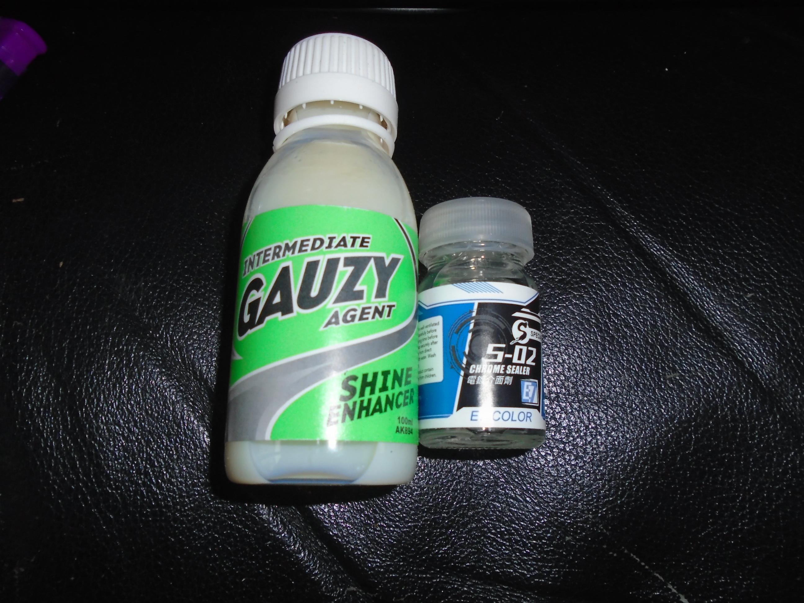

try these for protecting item you've used molotowe on. The gauzy stuff is good but I haven't tried the s-02 version yet. just be sure to leave the items a few days before coating
Funny you brought up S-02 Les,  I actually bought a bottle on ebay a few days ago and it's on its' way.  I just looked on Amazon for the intermediate Gauzy and see they have another Gauzy product called Glass Coat.  I haven't searched the forum yet for info on this stuff.
The gauzy stuff I have works for the molotowe, I used it on the fuel rail for my escort and its been handled loads since with no ill effects. Its self levelling too so you can put it on with abrush. I'll be trying the s02 later tonight and will update on it tomorrow
