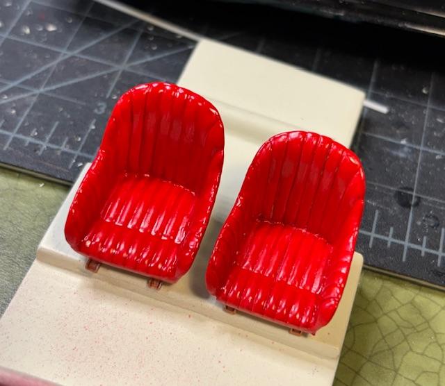

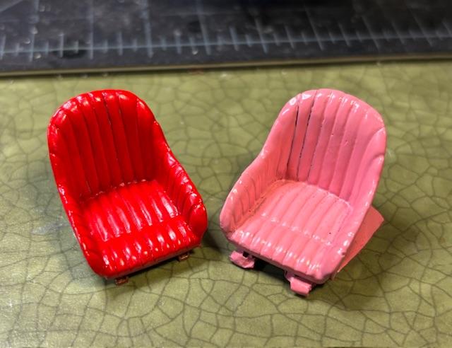

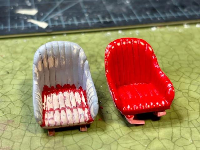

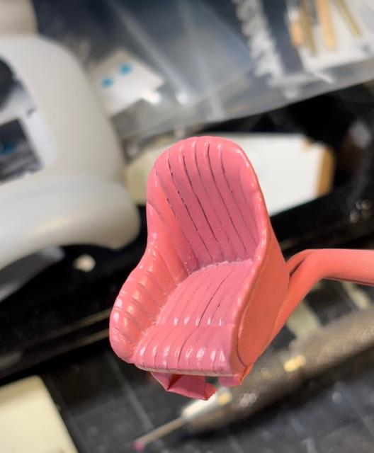

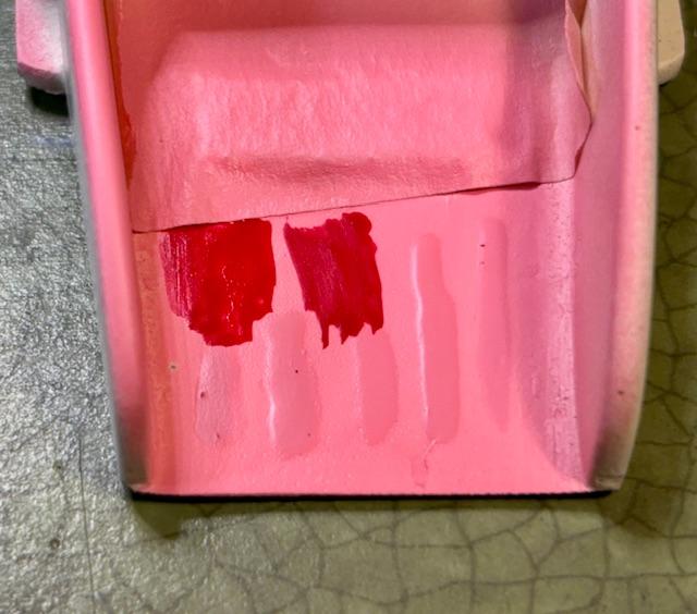

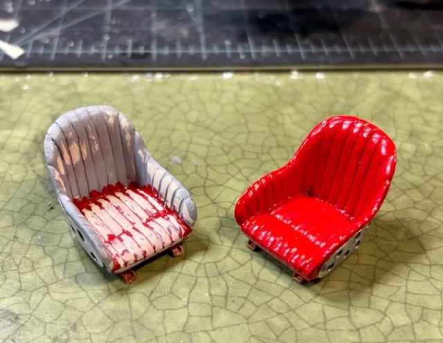

absmiami Posted November 14 Author Posted November 14 Removed some of the color coat - and sprayed on some Tam Ferrari pink primer …

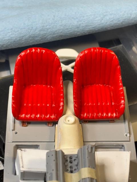

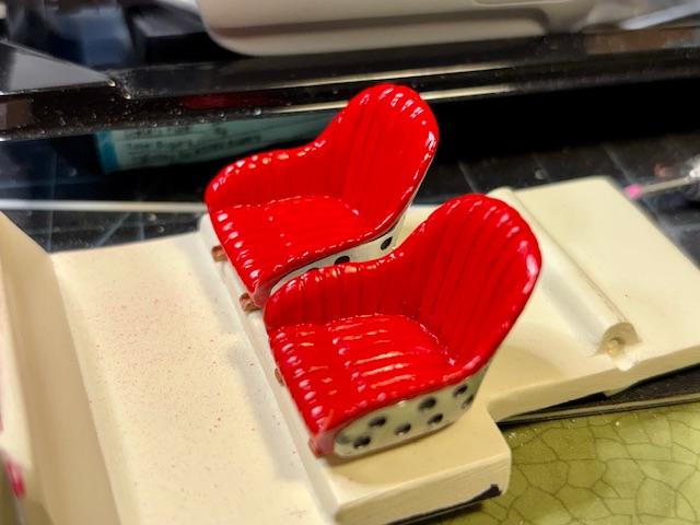

absmiami Posted November 14 Author Posted November 14 Adding some more flattening agent as i go - this is close - but think ill add another color coat w some more flattening additive - i want sheen instead of shine - hate painting leather - makes my head hurt - 1

AmericanMuscleFan Posted November 14 Posted November 14 1 hour ago, absmiami said: AMF - did your first snow melt? I caught a flurry in Calgary spending time w relations in early October - No, still on the ground, good news for the northern model car builders! 😁 Playing with paint is what I like the least, I think you're doing rather well, my dear!
Pierre Rivard Posted November 15 Posted November 15 Amazing seats, but yeah, I agree, too much gloss. May I suggest a wash (dark brown or oiled earth) to bring up some contrast, then a flat varnish, then after it's cured rubbing it off with a cloth?
absmiami Posted November 17 Author Posted November 17 Pierre - what is your go-to fl varnish ? Does Vallejo have it in their line ? How bout a coat of 50/50 tamiya fl clear and semi gloss clear ?

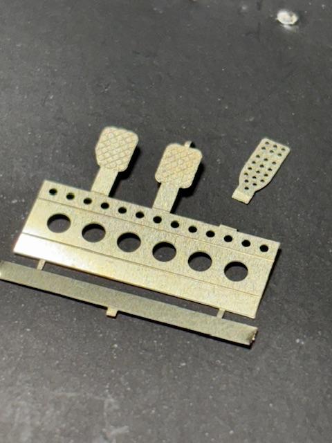

absmiami Posted November 17 Author Posted November 17 The kit had several photo-etched frets - including a pedal assembly - i’ll use the pedals - with some mods - 2

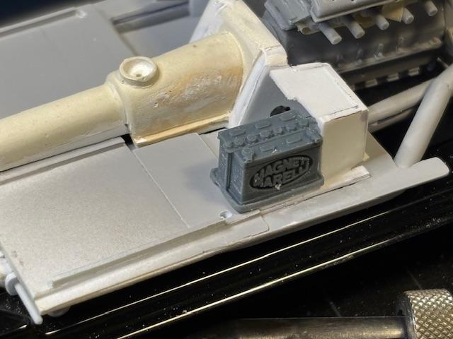

absmiami Posted November 17 Author Posted November 17 Battery courtesy of Mr William Cunningham - his 3D design fr his world class birdcage project - 2

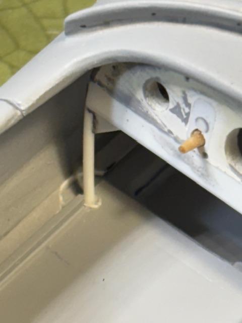

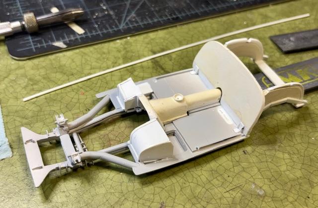

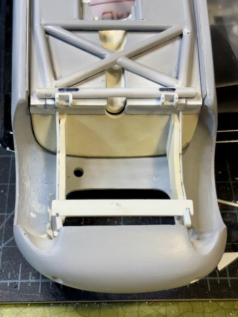

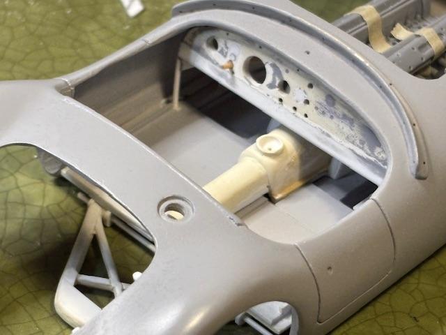

absmiami Posted November 17 Author Posted November 17 Fitting the dash - figured out that if removed a small section of the L strip on both sides of the body i can attach the dash and frame to the chassis -before attaching the body - so i’ll be able to make the sub frame that is visible in the driving compartment 3
absmiami Posted November 17 Author Posted November 17 Now time to glue the rear bulkhead and frame to the rest of the chassis - with some brackets and some mods to the bulkhead - the completed chassis - someday - will slip into the completed and painted body - i hope - 3
Pierre Rivard Posted November 17 Posted November 17 9 hours ago, absmiami said: Pierre - what is your go-to fl varnish ? Does Vallejo have it in their line ? How bout a coat of 50/50 tamiya fl clear and semi gloss clear ? I use Vallejo varnishes, sold in small 0.6oz dispensers and easy to brush on. You can use the 70.520 matt or 70.522 satin. If you are interested in washes, my go to is Vallejo Oiled Earth 76.521 (1.18 oz). All these products are water-based and very easy to use.
absmiami Posted November 17 Author Posted November 17 Gracias - for those of you new to the forum - Pierre brush paints - everything - so he is the paint finish oracle -

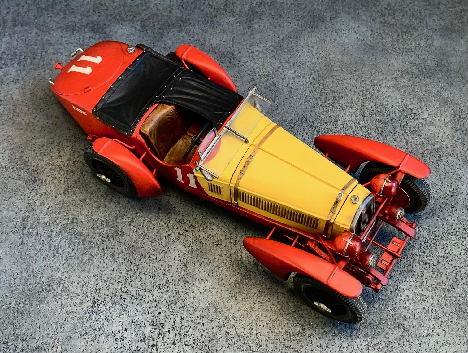

Pierre Rivard Posted November 17 Posted November 17 Andrew, I hope you will be ok with me posting a picture on your thread to help explain these finishes. On this Alpha 8C I wanted a weathered race look. The seat has received the oiled earth wash and then a satin varnish. The black tarp has a satin finish and the body was also weathered with a wash, mattress varnish and dry pigments in specific areas. 1
absmiami Posted November 17 Author Posted November 17 any time Pierre ! my Maser seats will have a fresh fr the factory look - but your great brown leather seats will be an interesting contrast your Alfa has just finished racing 24 hrs - over 750 miles - on the pre-war French Lemans course - and you nailed it ...
MarkJ Posted November 17 Posted November 17 Pierre, I still can't get over how wonderfully that whole build came out but that seat was one for the ages. It looks like you took a real leather seat and miniaturized it to 1/24 scale. Simply amazing.

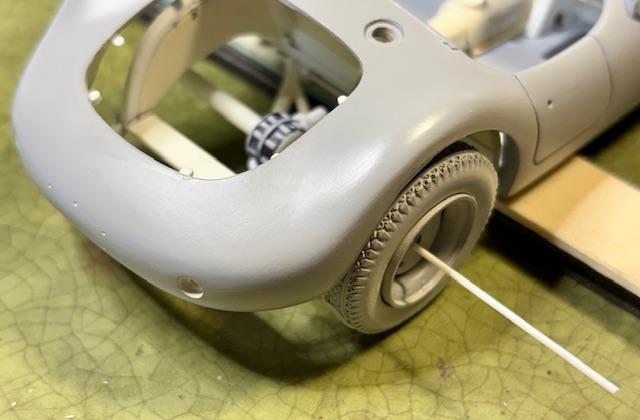

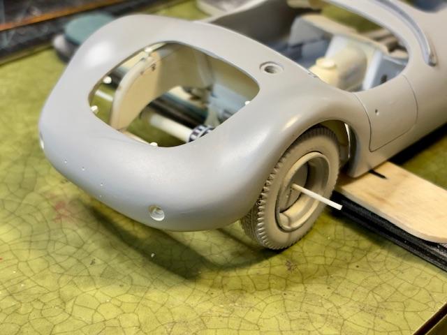

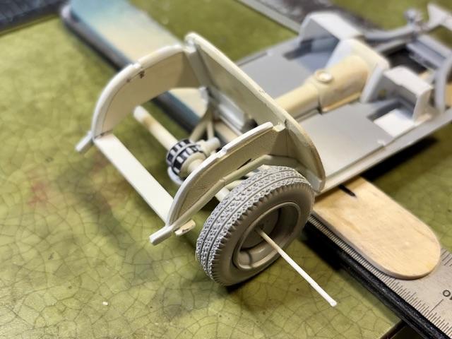

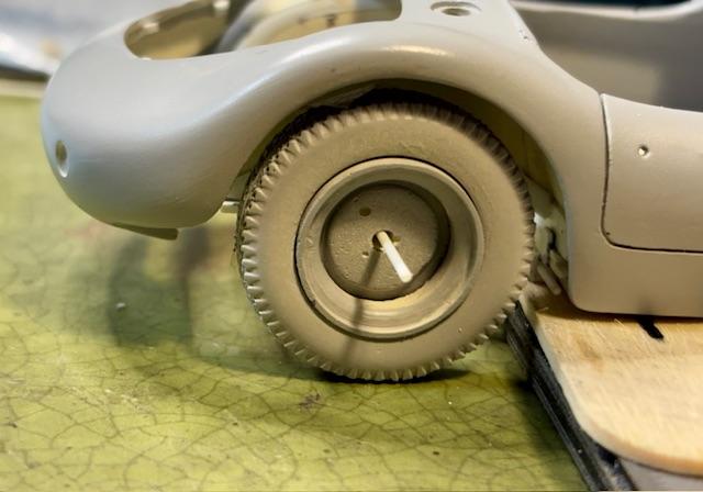

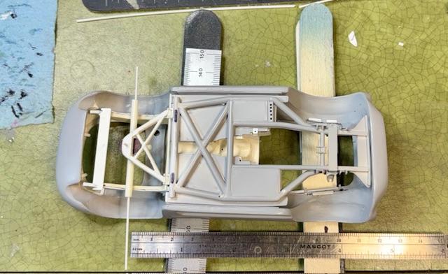

absmiami Posted November 18 Author Posted November 18 (edited) Some mock ups to see what fits where - wheelbase still checks out - can now measure and file the rear axle to correct length - this is too wide - but i thought that i’d have to make a few changes - Edited November 18 by absmiami 2
absmiami Posted November 18 Author Posted November 18 Ride height not yet correct - but i’m getting there - pondering how to secure the rear axle - think i mite want to add something to the springs and trailing arms to secure it - 2

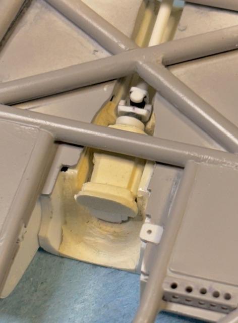

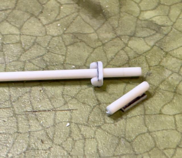

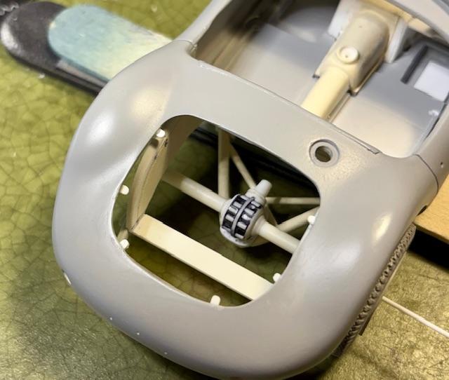

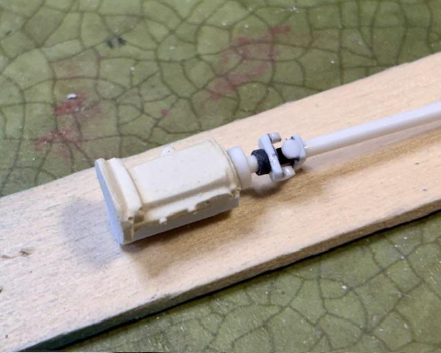

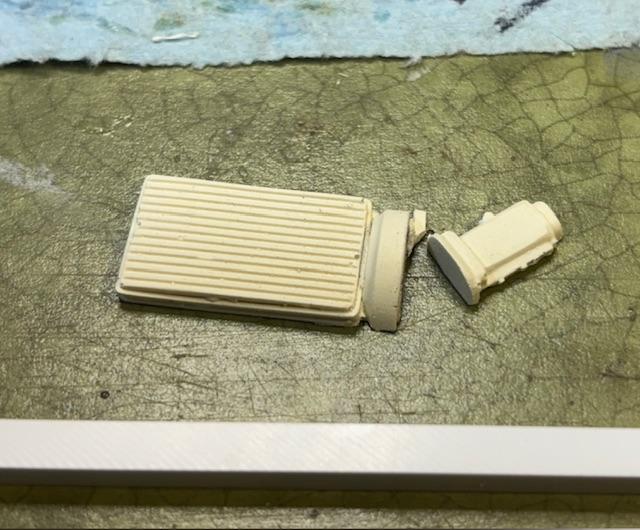

absmiami Posted November 19 Author Posted November 19 The kit had a curbside style casting combining the sump and the base of the transmission - i sawed off the “tranny” - added some Evergreen strip - and then made some U joints - again fr Evergreen strip and rod - 1
absmiami Posted November 19 Author Posted November 19 The assembly just squeezes into the transmission tunnel - barely - ill have to remember to install this before the engine block and crank case - or else I’ll be sorry - 3
Moparman18064 Posted November 19 Posted November 19 That sure is a tight fit, Andrew! Nice u joint, you make it look easy!
absmiami Posted November 19 Author Posted November 19 Believe it or not M Man - Maserati sent two oil lines from the oil tank behind the fuel tank through the trans tunnel and forward to an oil pump located at the fr of the engine - they were routed not more than an inch or two from the dr shaft - no idea whether i can pull that off in scale - and was this really a good idea ?
Big Messer Posted November 19 Posted November 19 1 hour ago, absmiami said: Maserati sent two oil lines from the oil tank behind the fuel tank through the trans tunnel and forward to an oil pump located at the fr of the engine - they were routed not more than an inch or two from the dr shaft - no idea whether i can pull that off in scale - and was this really a good idea ? Wonder what the mechanics servicing the cars said... probably aloud... and most likely sailors around would have blushed.
