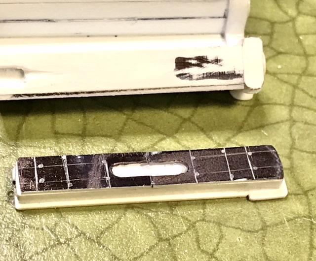

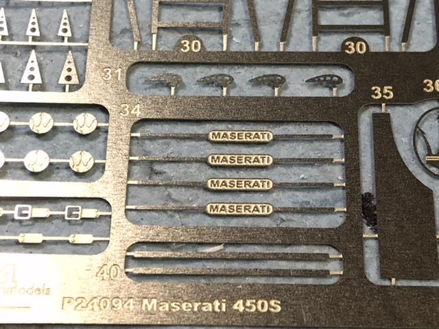

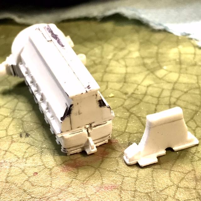

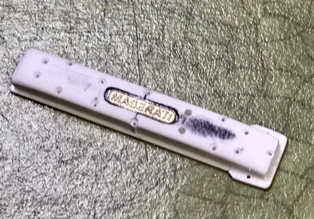

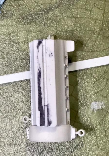

absmiami Posted May 1, 2024 Author Posted May 1, 2024 This is a part that would really be perfect for 3D drawing and printing - note to Andy …. As i am still stuck in the last century - I’m “borrowing” 2 photo-etch scripts from the Profil24 Maserati 450S kit - so what will i do when i get around to building my 450S kit ? Dunno …

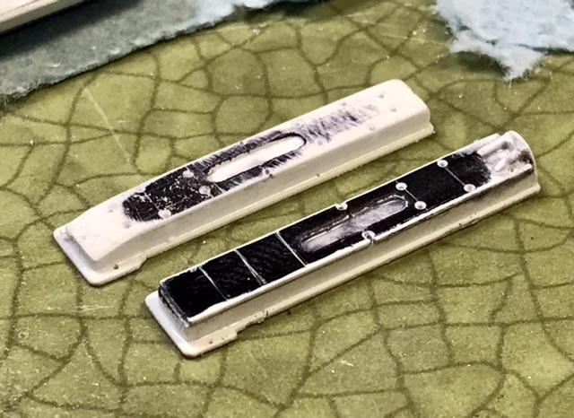

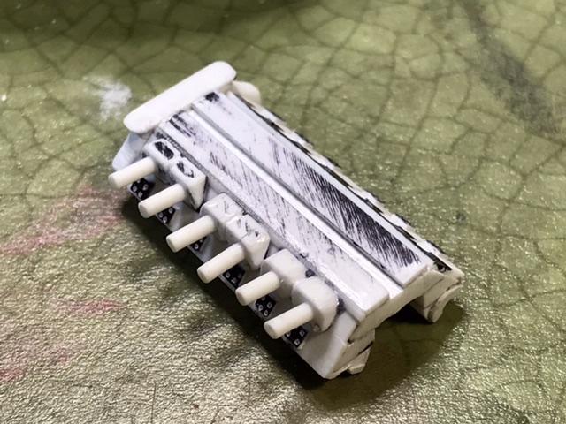

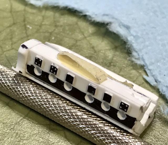

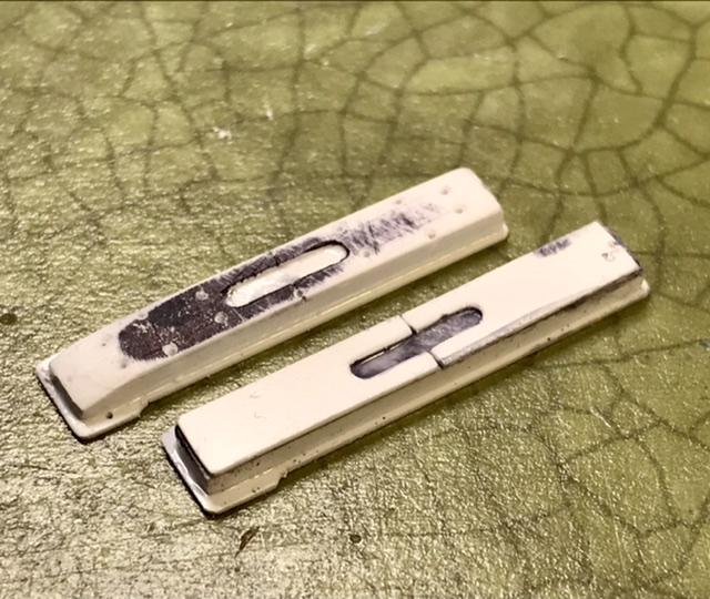

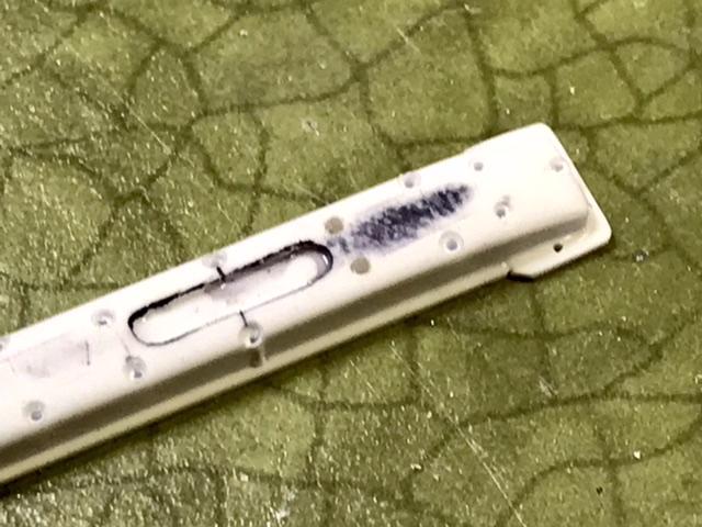

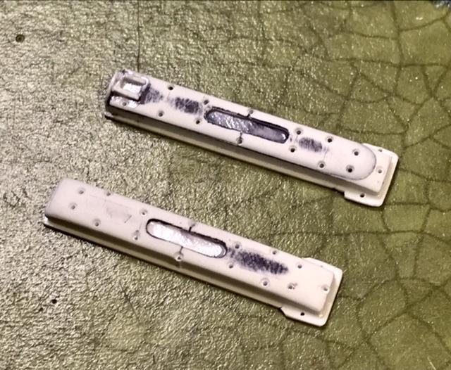

absmiami Posted May 2, 2024 Author Posted May 2, 2024 You’ll notice on the last eng bay pic that the valve covers are tapered at the front and sport staggered securing bolts - PITA - and although the part has two layers - the Tamiya liquid glue effectively welds the strips together - so I’ll end up with a part that looks like it was caste - the bolts need to be really small - will use .020 or .018 if I can source them … 1
Pico Posted May 3, 2024 Posted May 3, 2024 You reallyreallyreally need to download a cad program like Fusion; learn it - I know, it's not easy - and get a quality 3d printer. You've seen the astounding work that Bill Cunningham has been doing on the ACME Facebook page. You will be amazed at what you can do.

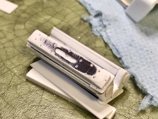

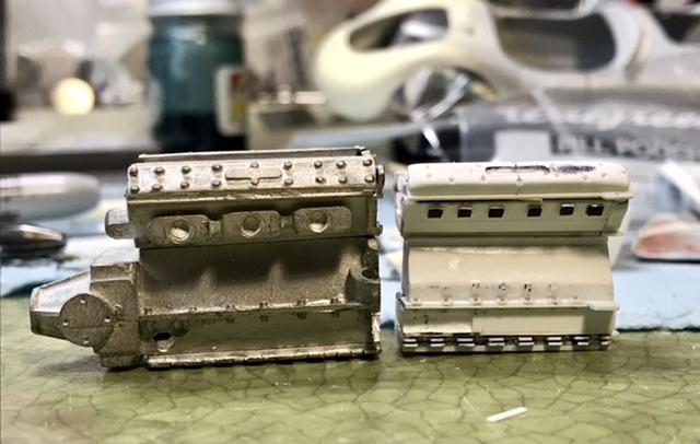

absmiami Posted May 3, 2024 Author Posted May 3, 2024 So now that i’ve gotten the cam covers mostly done - I’ll circle back to the block and crank case and add all of the …. Stuff …. Tried a couple of Master Club .05 bolts - they’ll look good -but ill paint them before attaching … 1

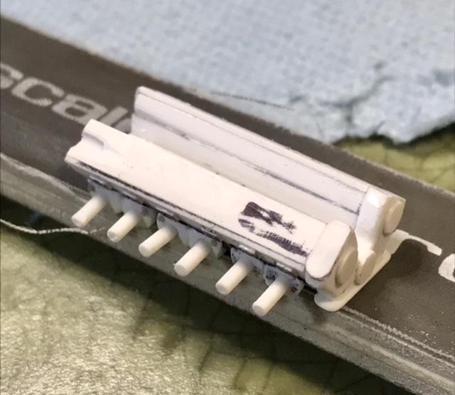

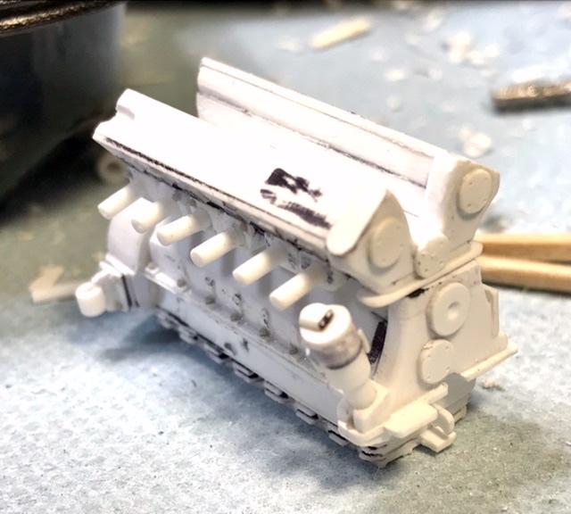

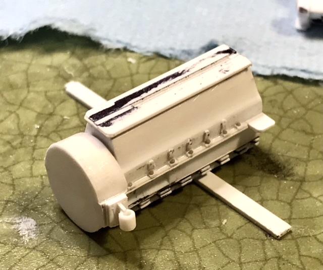

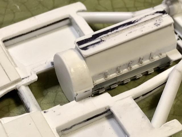

absmiami Posted May 4, 2024 Author Posted May 4, 2024 So ive grown the engine - it’s shorter than the Western wh metal engine and will fit under the bonnet …
absmiami Posted May 5, 2024 Author Posted May 5, 2024 The right engine side motor mount attaches to the clutch housing because of the location of the starter …

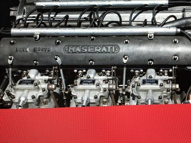

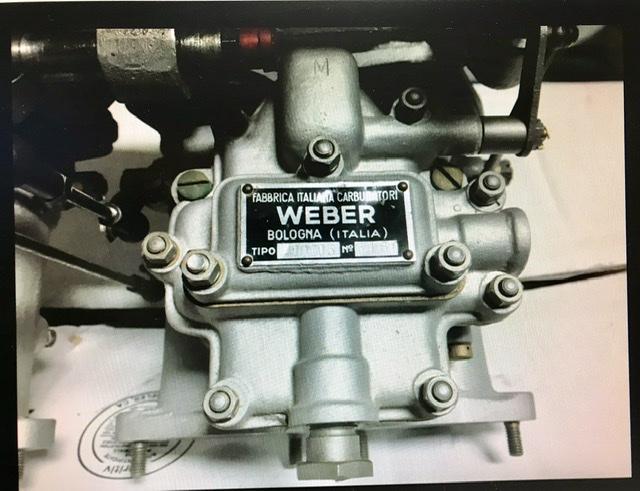

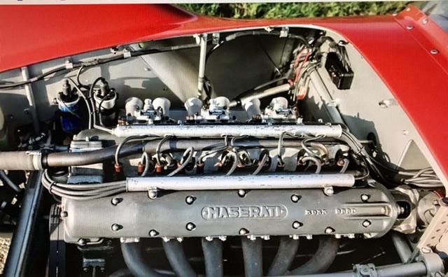

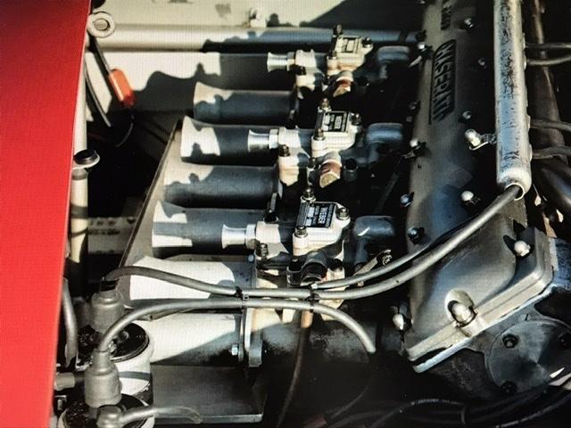

absmiami Posted May 9, 2024 Author Posted May 9, 2024 So i’ve been obsessing over Webers …. These pix are fr the Orsi Maserati bible …. The A6GCS sported Weber 40 DC03 side drafts ….
absmiami Posted May 9, 2024 Author Posted May 9, 2024 The carefully restored 2053 has the correct set up …
absmiami Posted May 9, 2024 Author Posted May 9, 2024 And fr the BAT site - this is a side draft 45 DC03 - which is the Weber more frequently used on production sports cars like 50’s Alfas ….

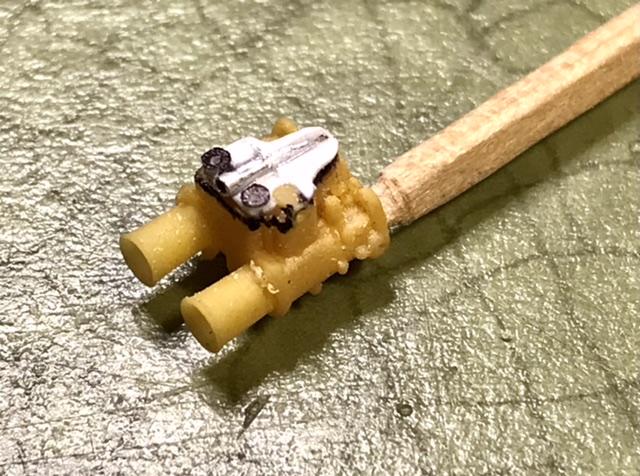

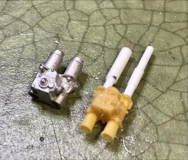

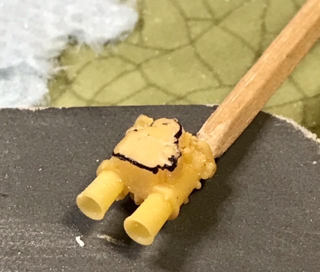

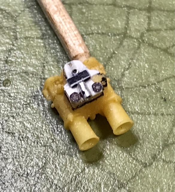

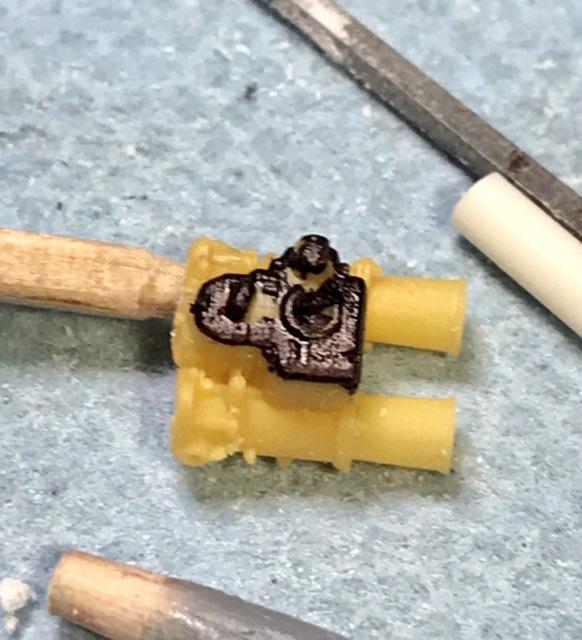

absmiami Posted May 9, 2024 Author Posted May 9, 2024 Scale Production makes a pretty good 45 DC03 Weber - no one yet makes the correct 40 DC03 side draft in 24th scale - although a good 3D printed one will be made sooner or later - William Cunningham has shown us the way here …. But ill use the Scale Production Webers with some mods for the engine on 2053 … Ill check the size - but they appear to me to be scale accurate …. The posts are 1/16 Evergreen rod turned down to .054 to fit into these Webers …

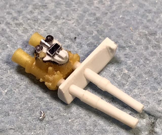

absmiami Posted May 10, 2024 Author Posted May 10, 2024 Model factory hiro’s Webers on its Aston Martin DBR GT kit are quite good - but once again - they are the 45’s - not the 40 DC03 … so ive removed the detail outlined in black on top of the Scale Production carb …. What could go wrong …
absmiami Posted May 10, 2024 Author Posted May 10, 2024 So after spending a few hours w my trusty Optivizer I’ve got something that looks like a 40 DC03 - some bits and peices of Evergreen plastic, some alu tube - the small dia stuff - and I’ll add some RB MOtion .015 bolts - the ones that don’t seem to want to stay on you zirconium encrusted tweezers ….

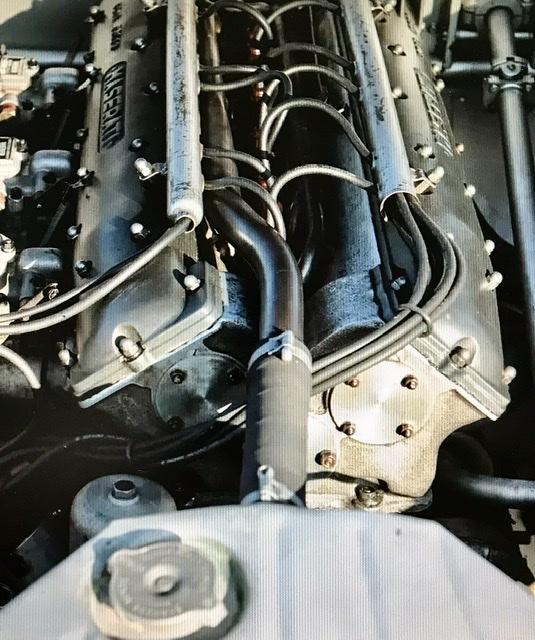

Pierre Rivard Posted May 11, 2024 Posted May 11, 2024 Man... what a gorgeous engine! No pressure Andy... but now that we have seen the real thing...?

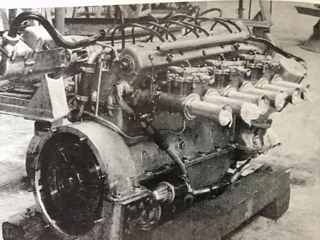

absmiami Posted May 11, 2024 Author Posted May 11, 2024 Thank you Pierre and John - i think the eng bay shots are 2078 - which has also been auctioned in recent years - you’ll notice some differences between 2053 and 2078 - 2053 uses a different distributor and crosses the plug wire feeds … and dresses up the cam cover a little
absmiami Posted May 11, 2024 Author Posted May 11, 2024 One distr is located at the eng front and the exhaust side distr is tucked into the bulkhead - these were twin plug engines - got a good shot of the distr on 2053 - but not on my phone - ill add it later …
absmiami Posted May 11, 2024 Author Posted May 11, 2024 Come to think about it - think John’s eng shots are from a 300S - which sported a 250F derived engine - the cam covers are the giveaway - don’t apologize John - the 300S is my next Maser project …

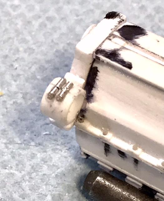

absmiami Posted May 19, 2024 Author Posted May 19, 2024 Shaped and attached the timing chain cover - more Evergreen …

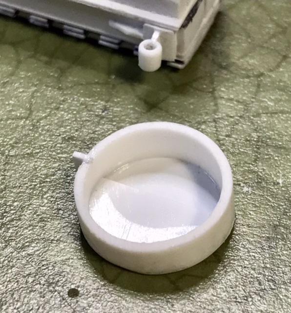

absmiami Posted May 19, 2024 Author Posted May 19, 2024 T shirts ! What a great idea ! I need more T’s !! this is the collar that holds the alternator and behind it - the water pump - there’s a good shot of this at the top of this page …
