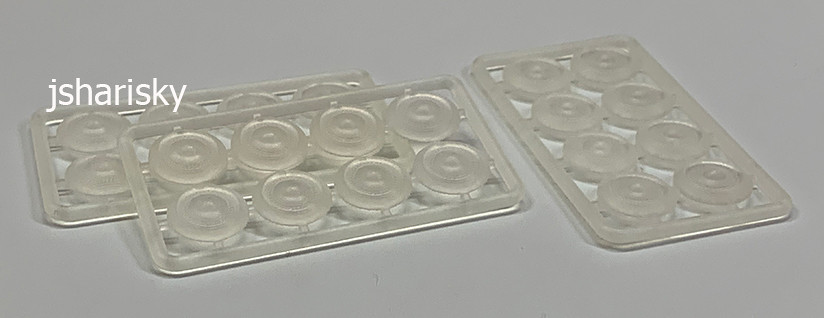

I've purchased three racks. Eight hub caps on each rack. I purchased the more expensive "Smoothest Fine Detail Plastic" printed media. Translucent, I can't effectively photograph the caps themselves. Here are the racks that I purchased:

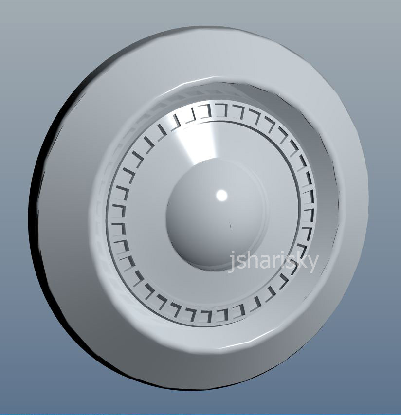

Here's the final 3D file image that Rico sent me:

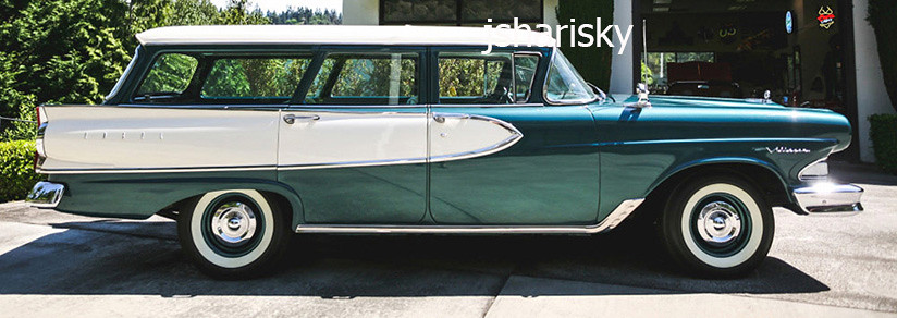

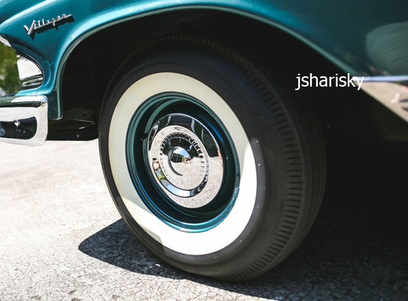

Here are 1:1 examples of the Edsel caps on a 1958:

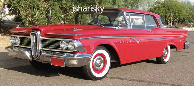

...1959:

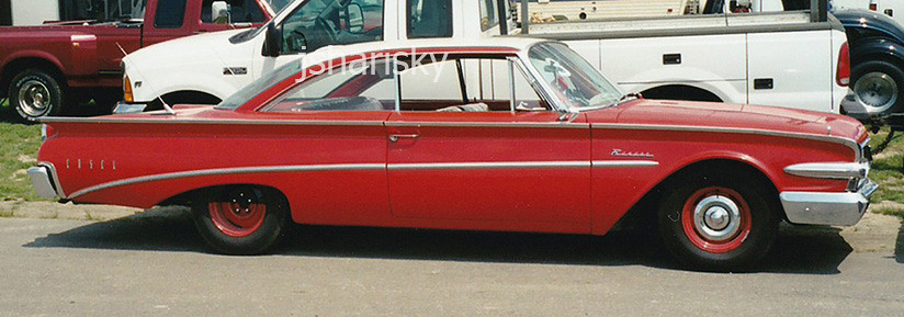

...1960:

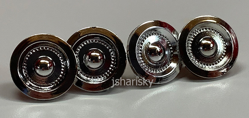

These new caps give us another choice for the "look" of our Edsel projects for 1958:

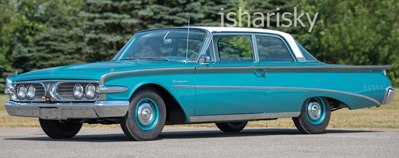

...1960:

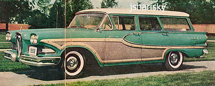

The term "poverty caps" can be a misnomer. Here's a top-of-the-line '58 Bermuda four-door station wagon in the Ford styling courtyard. I put this image together from a Popular Science article on the Edsel introduction (Ford called the light-colored wood panels "Driftwood"):
