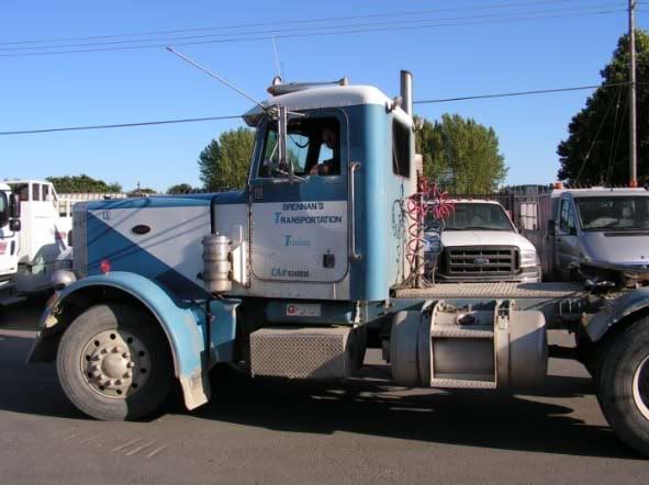

This is my Brother's truck, I'm considering building a model of one for him for his birthday. I want it to be a surprise so unfortunately I can't ask him too much about it without giving my plans away.
I got my dad to send me a couple of pics of the truck, but he didn't get one from the front.
I think this is a 359 but not positive, confirmation or correction welcome. Also if you can tell the approximate year and which kit out there would be my best option that would help as well.
Thanks
Id Say its a Peterbilt 359. The Cab and Hood are Different for the 379. The AMT kit would proabaly be your best bet for it. Mayb the AMT 359 since you dont have to cut the bunk off. Somebody here will have better info

I would say a 359 119" BBC if it is a tandem drive tractor. If it is a single drive axle tractor a 289. But Tim will confirm. Year at a guess 1976 to 1978 (Look at the headlights). Engine Cummins 400 Big Cam 3 with RTO 12513 transmission. Just a guess? Not an expert.
The AMT T501 California Hauler (The one with the Cummins NTC 350) would be the base kit for this. For me anyway.

I'll go one step further..
Pre '76 (smaller back window than the '76+ cabs).
Fiberglass hood (no step on fender, no panel seam and raised lip at the beltline, deeper grille crown).
The best kit to build this:
AMT 359.
Sand off all the rivet and the panel seam detail. Leave the center of the top of the hood fluted ribs.
OR.. the Revell of German 359. This kit has the correct grille crown/shell for a fiberglass hood, but has the aluminum hood in the kit.
The truck looks like it might have originally been a Redwood Construction logger.
Is the truck a single axle? If so, given the vintage it would be a 289. This also could have been an ex T&T tractor.

Thanks I knew I could find out here. The truck is a single axle so I guess that would make it a 289. I don't know its history as he has only had if for a couple of years and it apparently had been through a few owners before him. I think he has a Cummins in it, which I think will work for the AMT kit, or is that a Cat in there I don't remember.
I have the AMT kit already which makes that part easy. So do I sand the rivet and panel detail off the whole cab or just the hood?
For the single axle will a swap with the White Freightliner SD work? If so that works nicely since I want to build a W-FL DD daycab later.

The fiberglass hood first appeared as an option on the narrow-nose 358 tilt hood then available for the 359 (119" and 113" BBC) around '73.
The fiberglass hoods were considered upgrades at the time.
As for sanding rivets, the cab would keep all the rivet detail. Just the hood would be smooth. If memory serves, the dipstick door on the right side would be filled in too. Be sure to keep the fender corner marker lights, but eliminate the rear of fender steps. (if someone is using a Revell snap or Revell of Germany 359 and making it fiberglass hood, remove the front of fender bracket/steps too).
No front brackets - like the AMT hood

I did get a little more info over Christmas, it is a 1980 with a Cummins Big Cam.
