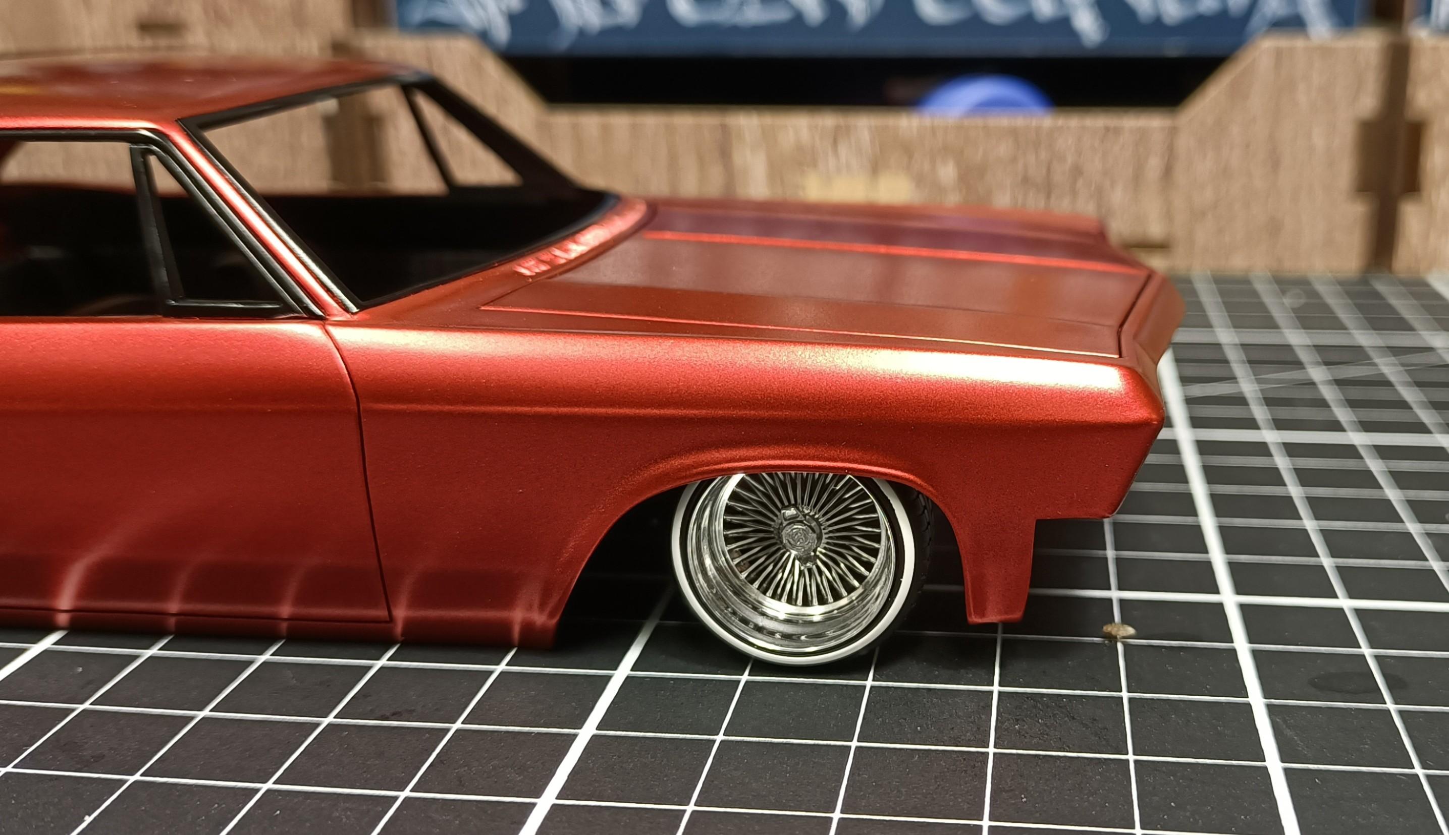

Salt work done and wheels chromed 😁
As per usual for me its seems I need to go back in and do some sponge work adding more rust to specific locations.

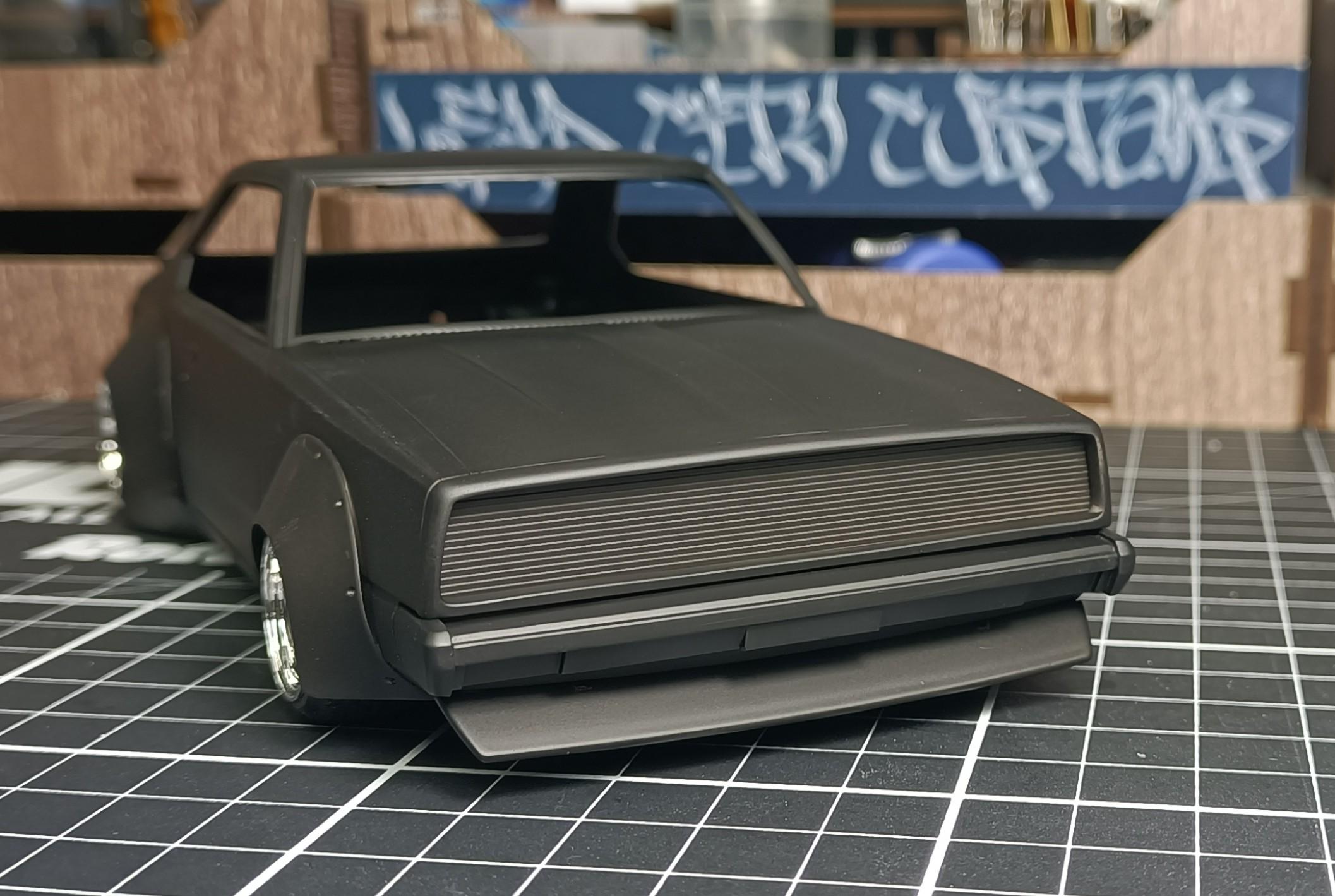

Hidden headlight grill roughed in and applied the usual check coat of surfacer. Full prep of the body next.

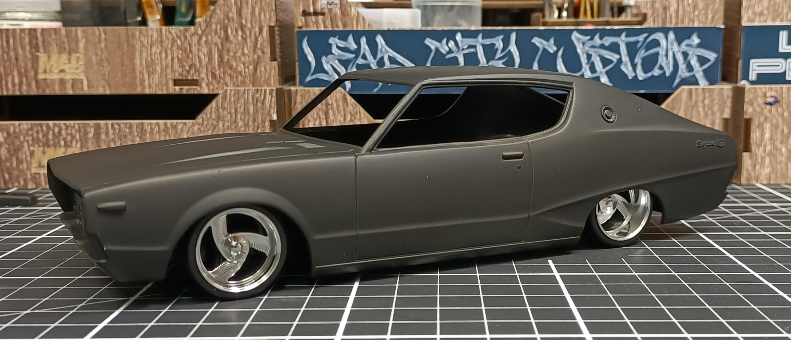

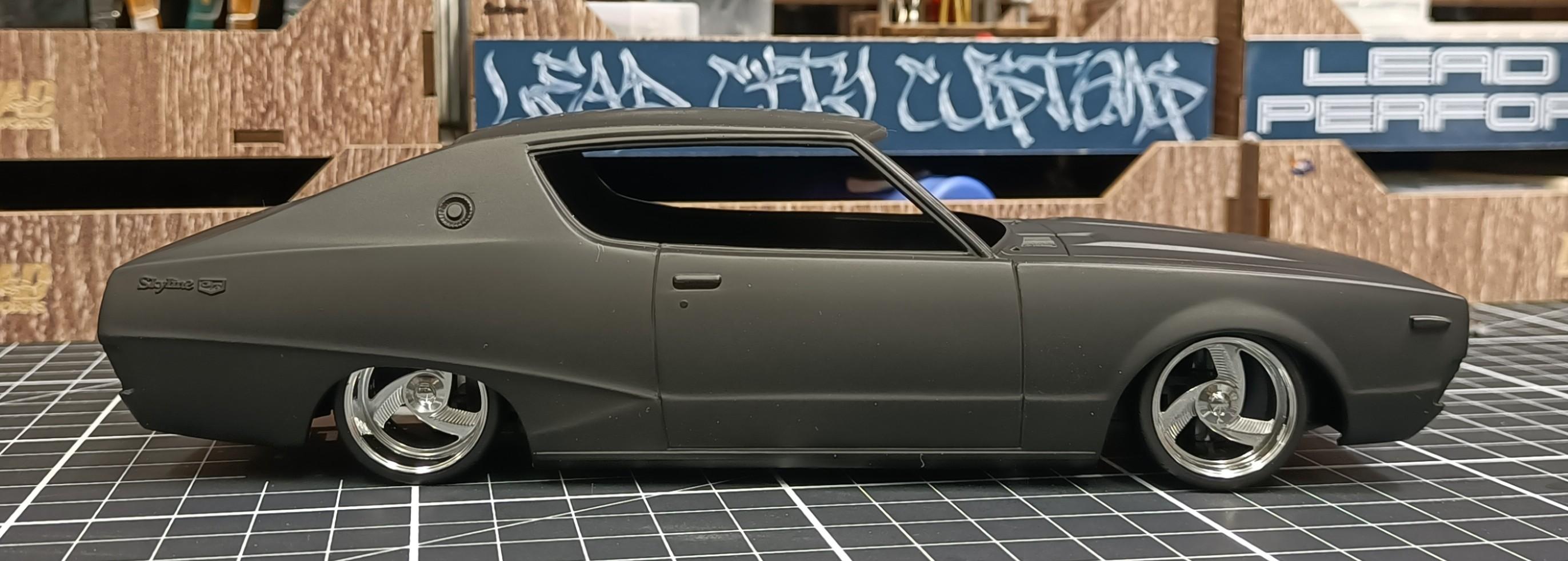

Sorted out the look I wanted for the billet tri blades, also changed over to lower profile tyres and applied the SMS paints Hyper Chrome Cold Tone. Happy now, so il get the body prep done as well.

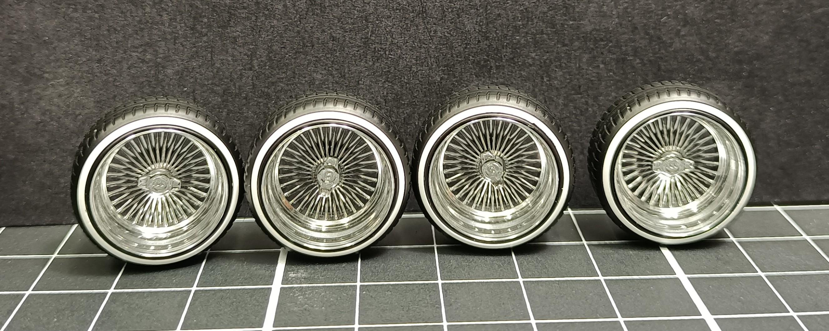

Also while I was doing some chrome painting, I dug out some wires wheels that I 3D printed and done some testing to see if my current chrome painting technique would work on them.
  • Like 4
