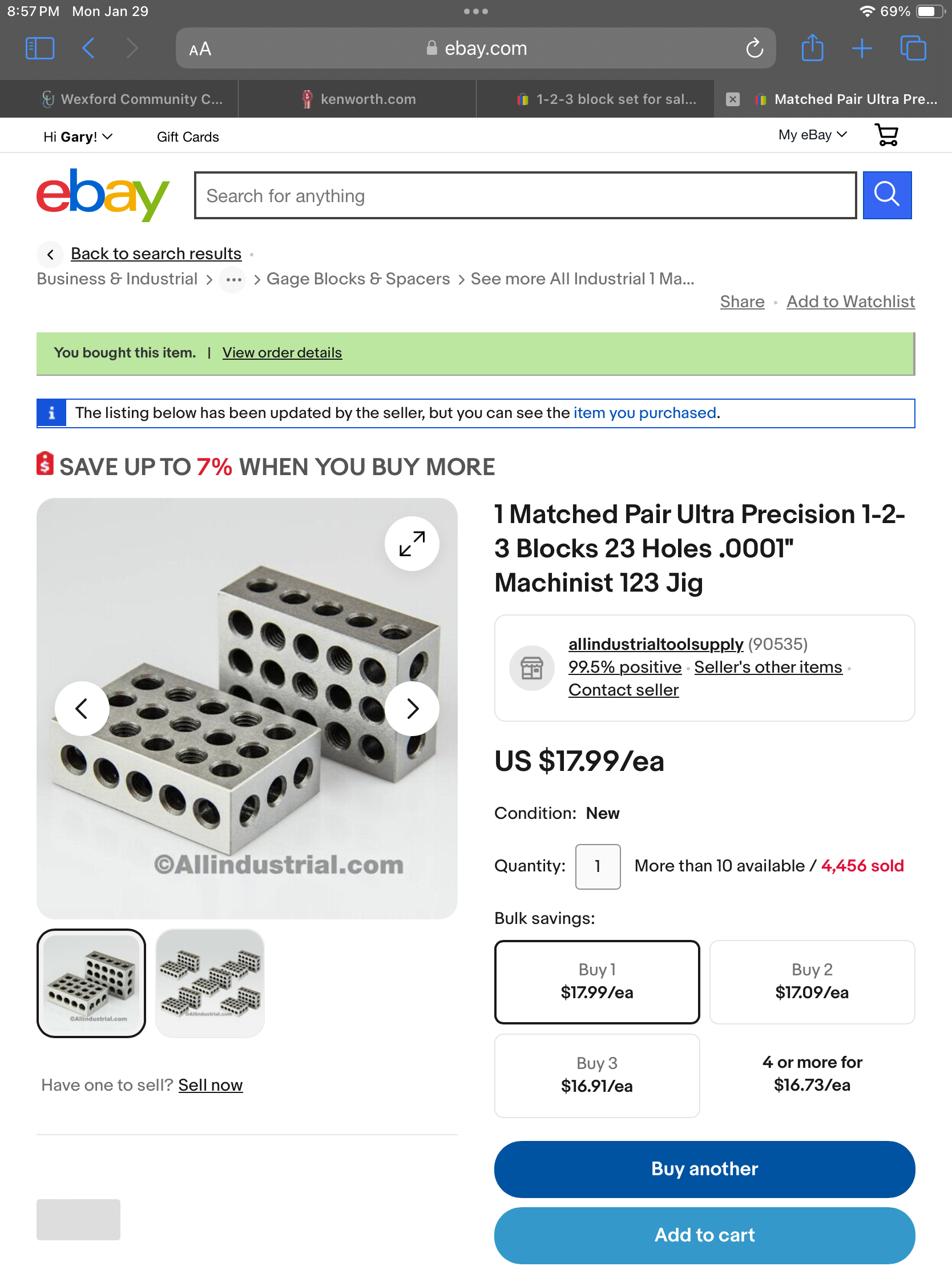

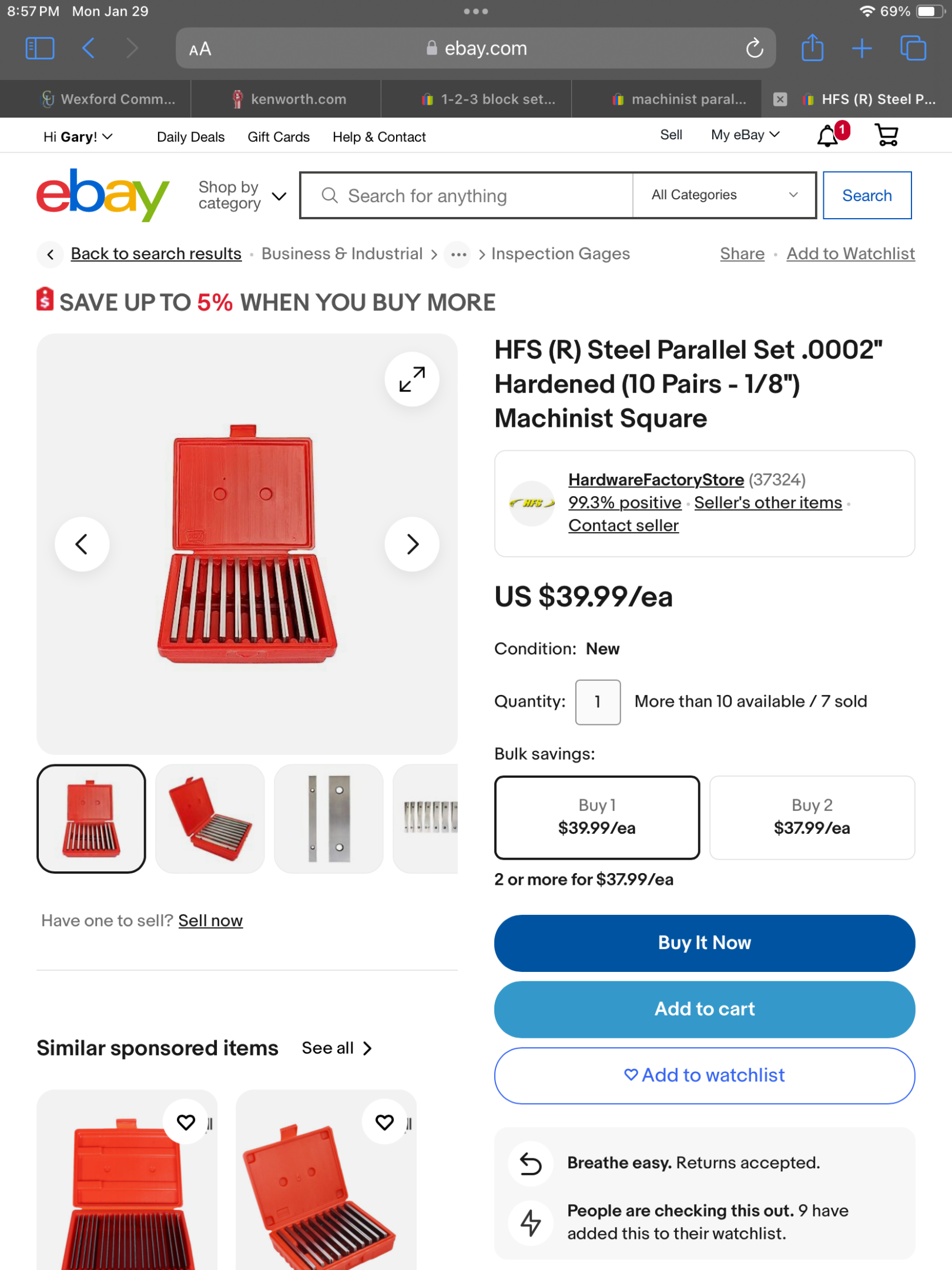

Goodwrench3 Posted January 30, 2024 Author Posted January 30, 2024 8 hours ago, Gary Chastain said: Noticed that you use V- blocks for your mockups, I do exactly the same and just purchased a new set of 1-2-3 blocks and a set a precision parallels. They really help set up a mock-up. Hi -- what are these ? " 1-2-3 blocks and a set a precision parallels. " ?? Can you send me a link for these ? Thanks !
Gary Chastain Posted January 30, 2024 Posted January 30, 2024 I have two sets of 1-2-3 blocks, here I am using them to square the backing plates on a rear axle, the parallels are used to fixture a mockup. You can get these on eBay or Harbor Freight. 2
