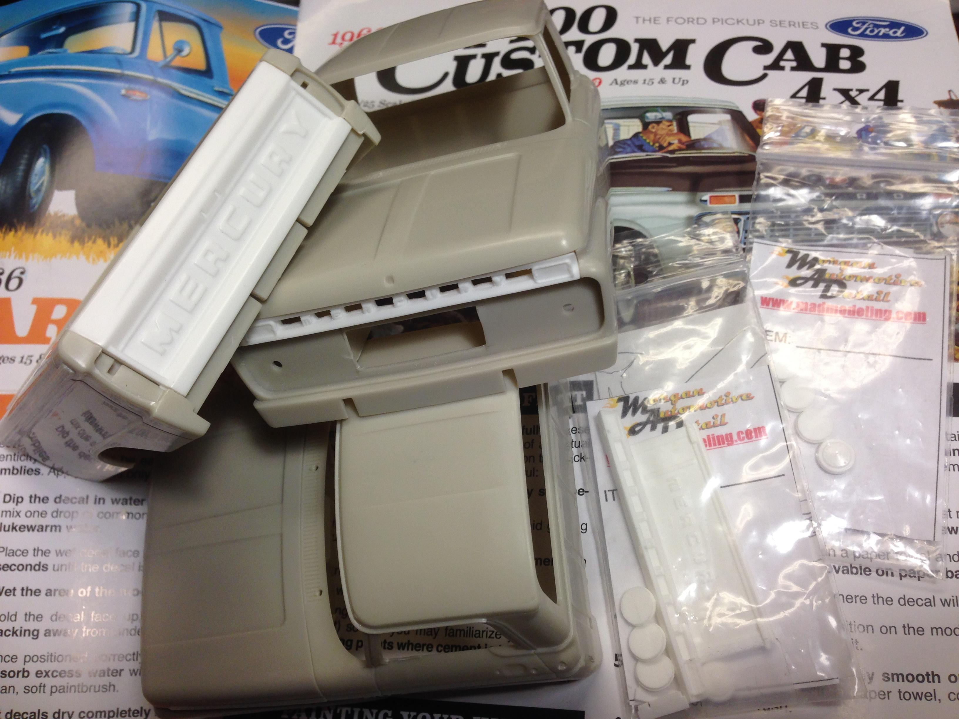

hct728(Bob) Posted February 25, 2022 Posted February 25, 2022 Can't find info on the Morgan Automotive Detail website on prep for their small resin parts, any suggestions on things that work?
yh70 Posted February 26, 2022 Posted February 26, 2022 6 hours ago, hct728(Bob) said: Can't find info on the Morgan Automotive Detail website on prep for their small resin parts, any suggestions on things that work? i use Comet or Ajax® Powder Cleanser..just wet the part and with a old tooth bush scrub the parts lightly until the water does not bead off. once the water runs off the part u will know all the mold release has been removed..you may have to scrub the parts a few times..
DRIPTROIT 71 Posted February 26, 2022 Posted February 26, 2022 7 hours ago, yh70 said: i use Comet or Ajax® Powder Cleanser..just wet the part and with a old tooth bush scrub the parts lightly until the water does not bead off. once the water runs off the part u will know all the mold release has been removed..you may have to scrub the parts a few times.. This is the only thing that I find works. I usually soak in Westley’s Bleach White first because that is the old go to method, but the mold release is never removed until I scrub the part with Comet and a toothbrush. 1
