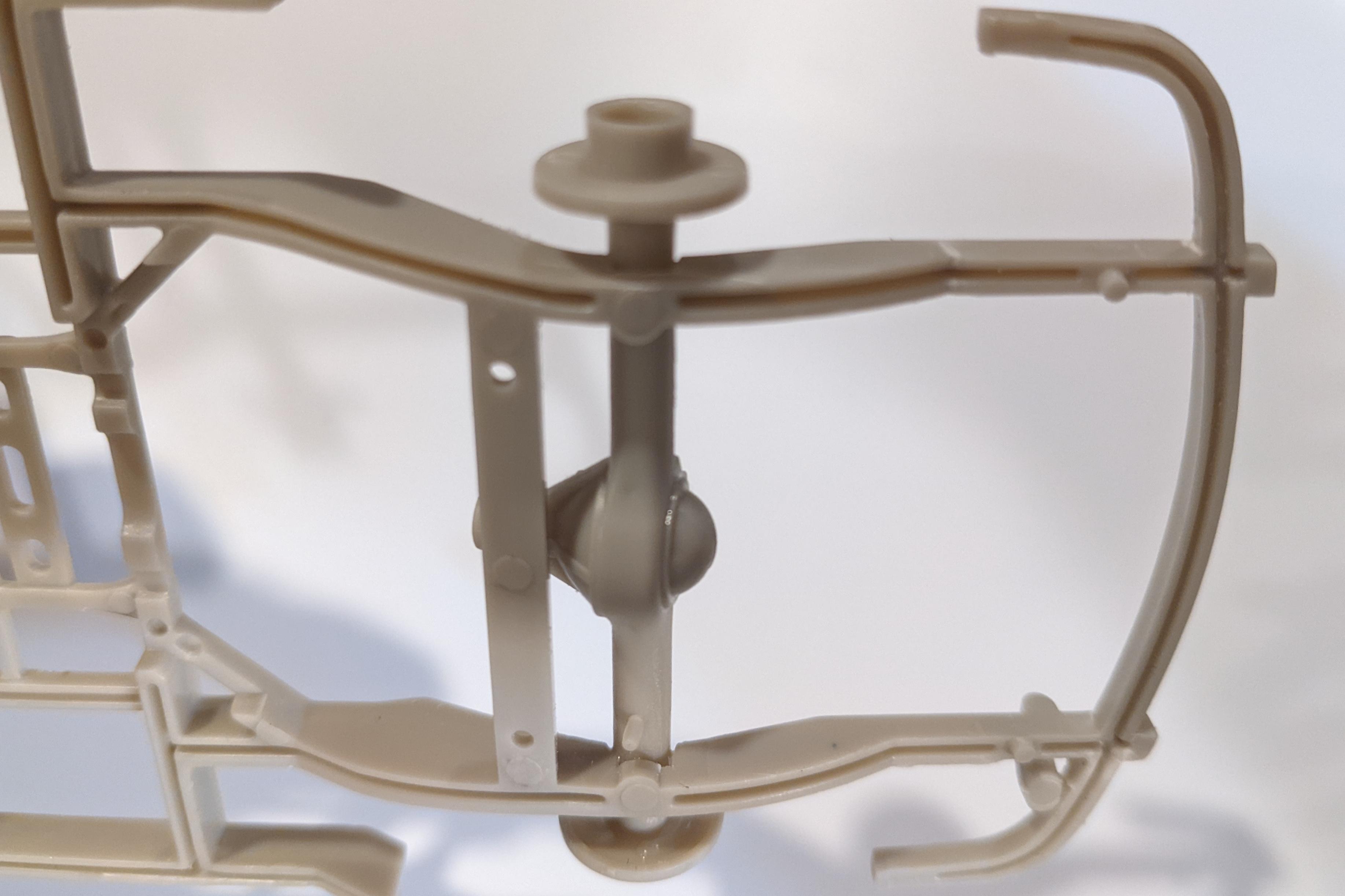

I've built models off & on since I was a kid, but now I'm retired, I can put effort into modifying them.  Here is how I'm lowering a Moebius 1952 Hudson Hornet coupe.  The technique should work on any of their kits that share this chassis.  I'm lowering the rear 3mm & the front 5mm, to also achieve some rake.  I plan to use the chrome steelies from the convertible kit, which I also have.  I'll show the rear, which is as far as I've gotten, then add the front later.  Hope this post is useful to folks & comments are welcome.
First, I notched 3mm from the frame rails to raise the rear axle relative to the body.
Then, I cut out a portion of the floor to clear the driveshaft, and another to provide clearance for the differential.  I added styrene sheet to fill in the holes.
Finally, I added 3mm tall blocks to the leaf springs, made from square styrene tube.  This mod provides an eventual connection to the axle, & allows the shocks ti remain unmodified.
20220227_5.jpg.6cf5e8c74e724d7f1b93b17e9848367d.jpg More to follow...

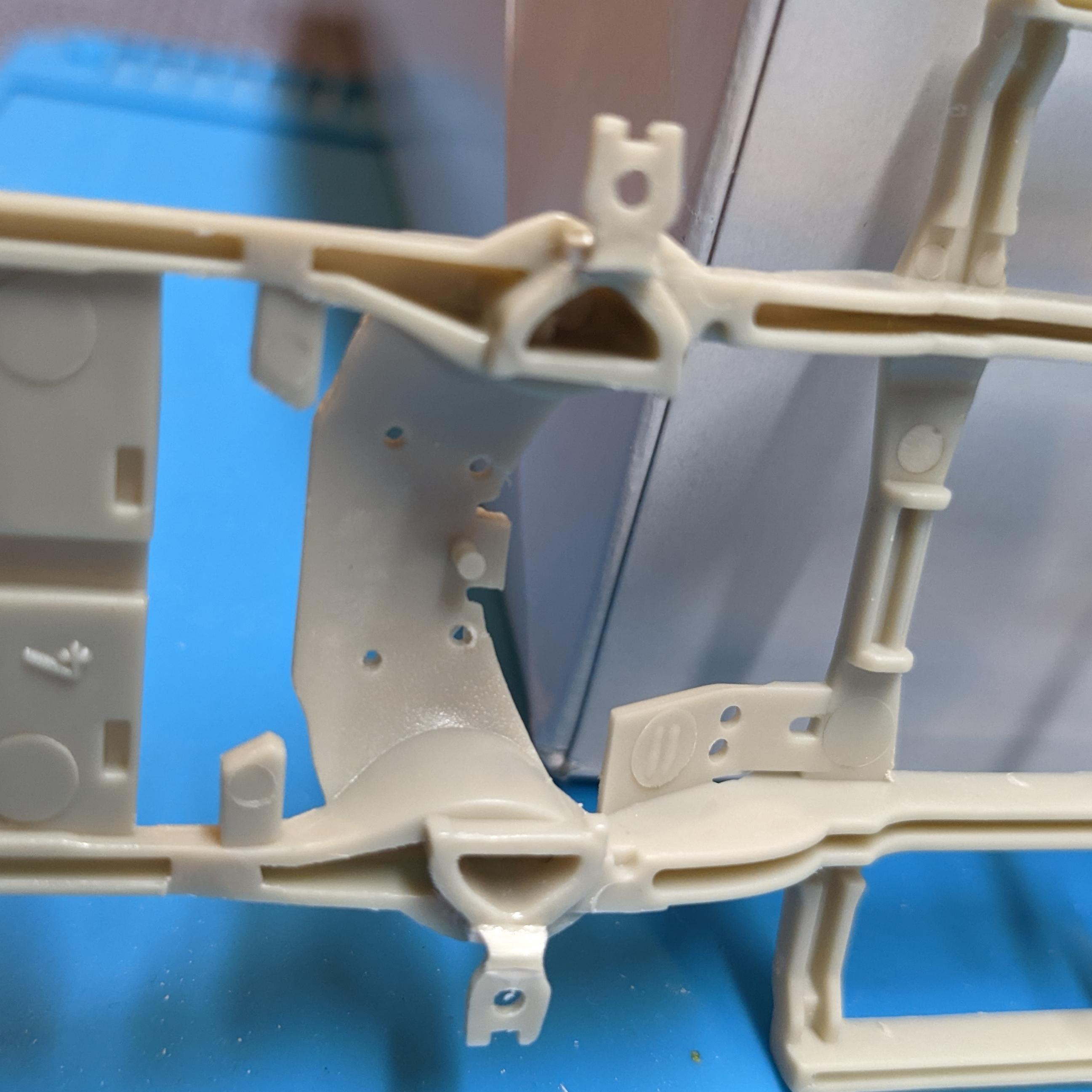

UPDATE:
By the way, this model is NOT intended for competition, so I am not refining the appearance of the suspension modifications.  I could clean things up with putty and sanding (except for the slip mentioned below), if I was going for a better appearance.  I'm new to this level of work, so maybe someday I'll take things that far.
I've completed the front lowering.  I was cutting the upper control arms from the chassis and the knife slipped.  I should have used a razor saw.  So I hogged out the portion still on the chassis, added a 2mm thick sheet styrene block, and glued the cut-off arm portion atop the block.  Originally, the block was going to raise the entire control arm.  I reversed the arm so the taper from the knife slip on one side allowed more cementing area.
20220312_1.jpg.a7cbd3b1d144f07fe4994212e5547171.jpg20220312_2.thumb.jpg.daaf1f91bbdce2dce421395dbf57c70d.jpg
This mod fits within the openings on the engine compartment fender wells.  Then I sawed (I learned!) the spindles, and reversed the portion with the axle location holes.  I added a 2+ mm square block between the two pieces.  The axle locator reversal lowers the front 3mm.  The added block makes a total of 5mm.  The block is "2+ mm" to account for the kerf of the saw.  Then I glued in the stub axles.
I drilled locating holes in the spindle tops and added locators, made from the attachment locators for the stock exhaust, which I'm not using.  Stretched sprue or the right size tube would also work.  The original locators are inside the hollow square tube portions I added (white in photos).
I assembled the front suspension and here's how it looks:
20220312_5.jpg.0f557ac959d8044341e98a260983d50a.jpg20220312_6.jpg.8ceba6e27a260a2e0c6f3abe4926fe9f.jpg
Here's a shot of the stance I achieved.  I'm not using these wheels, but I am using the tires, reversed to show the black sides.  I'm happy with it, including the VERY slight rake.
Again, this modification allows use of unmodified front lower control arms, springs, stabilizer bar, and tie rods.
