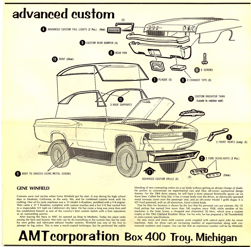

chris chabre Posted March 13, 2022 Posted March 13, 2022 Were the custom parts in the AMT Impalas available in any other reissues etc? Ive lost out on 2 65 convertibles this week (one unbuilt and the other a VERY clean survivor), and I cant seem to find a hardtop I can afford. Ive been searching but no luck. Both times Ive been sitting there while the auction winds down with a HIGH max bid (well above what my set limit is) only to get outbid in the last minute few seconds. Really aggravating.
Snake45 Posted March 13, 2022 Posted March 13, 2022 AFAIK, those parts were only in those two kits. They weren't in the '66s to my knowledge.
chris chabre Posted March 13, 2022 Author Posted March 13, 2022 41 minutes ago, Snake45 said: AFAIK, those parts were only in those two kits. They weren't in the '66s to my knowledge. the 66 kits I've seen are different.
Exotics_Builder Posted March 13, 2022 Posted March 13, 2022 (edited) 4 hours ago, Snake45 said: AFAIK, those parts were only in those two kits. They weren't in the '66s to my knowledge. Correct based on my check. 66 custom pieces a lot lighter than 65 (same with coupe). 66's did not come with the advanced custom pieces as depicted for this 65 I went down and checked my original unbuilt 65's (convertible and coupe) and 66 (coupe) to confirm Edited March 13, 2022 by Exotics_Builder 1
Mark Posted March 13, 2022 Posted March 13, 2022 '65 was pretty much the end of the line for the advanced custom parts. The '66 kits' custom versions were for the most part designed so as not to require the use of putty. In some cases the parts would look better molded in, but they could be built without it. The '65 Impalas, with that radical front end treatment, was by far the most ambitious one though. Finding a set of the parts without a kit, or in a started kit, would be one of those lucky deals. I did that awhile back with the '62 Corvette parts, finding the leftovers from a kit that apparently was built stock (and without the engine). All of those parts will fit any of the reissue '62 Corvettes.
