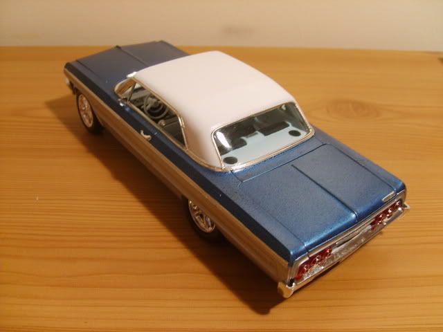

Simon Posted January 12, 2009 Posted January 12, 2009 Hi Will, I have had some success using a mixture of Johnson's Future (called Klear in the UK) and food colouring. You can just brush it on, one light coat at a time, and it pretty much levels out. Just don't go to mad with it, as I recently ruined a set of glazing by applying heavy coats, leaving an uneven tint which looked terrible and wouldn't come off. Also if you brush it on, you can end up with little particles stuck to the glazing, so a clean brush is essential. I did this Impala with this method. I don't think it would be ideal for a darker tint, as I think any unevenness would become more obvious, giving light and dark streaks, but I could be wrong. I'lll have to try spraying it and see how that goes.
935k3 Posted January 13, 2009 Posted January 13, 2009 (edited) Simon said: Hi Will, I have had some success using a mixture of Johnson's Future (called Klear in the UK) and food colouring. You can just brush it on, one light coat at a time, and it pretty much levels out. Just don't go to mad with it, as I recently ruined a set of glazing by applying heavy coats, leaving an uneven tint which looked terrible and wouldn't come off. Also if you brush it on, you can end up with little particles stuck to the glazing, so a clean brush is essential. I did this Impala with this method. I don't think it would be ideal for a darker tint, as I think any unevenness would become more obvious, giving light and dark streaks, but I could be wrong. I'lll have to try spraying it and see how that goes. Simon, did you know Johnson's Klear is just Future by another name and can be easily stripped with ammonia, which will not harm the plastic at all? I f you have an airbrush, decanting Tamiya's laquer clear red,orange,yellow,blue and smoke work very nice for tinting windows and can be stripped with 91% or higher alcohol which also does not hurt plastic. Edited January 13, 2009 by 935k3
