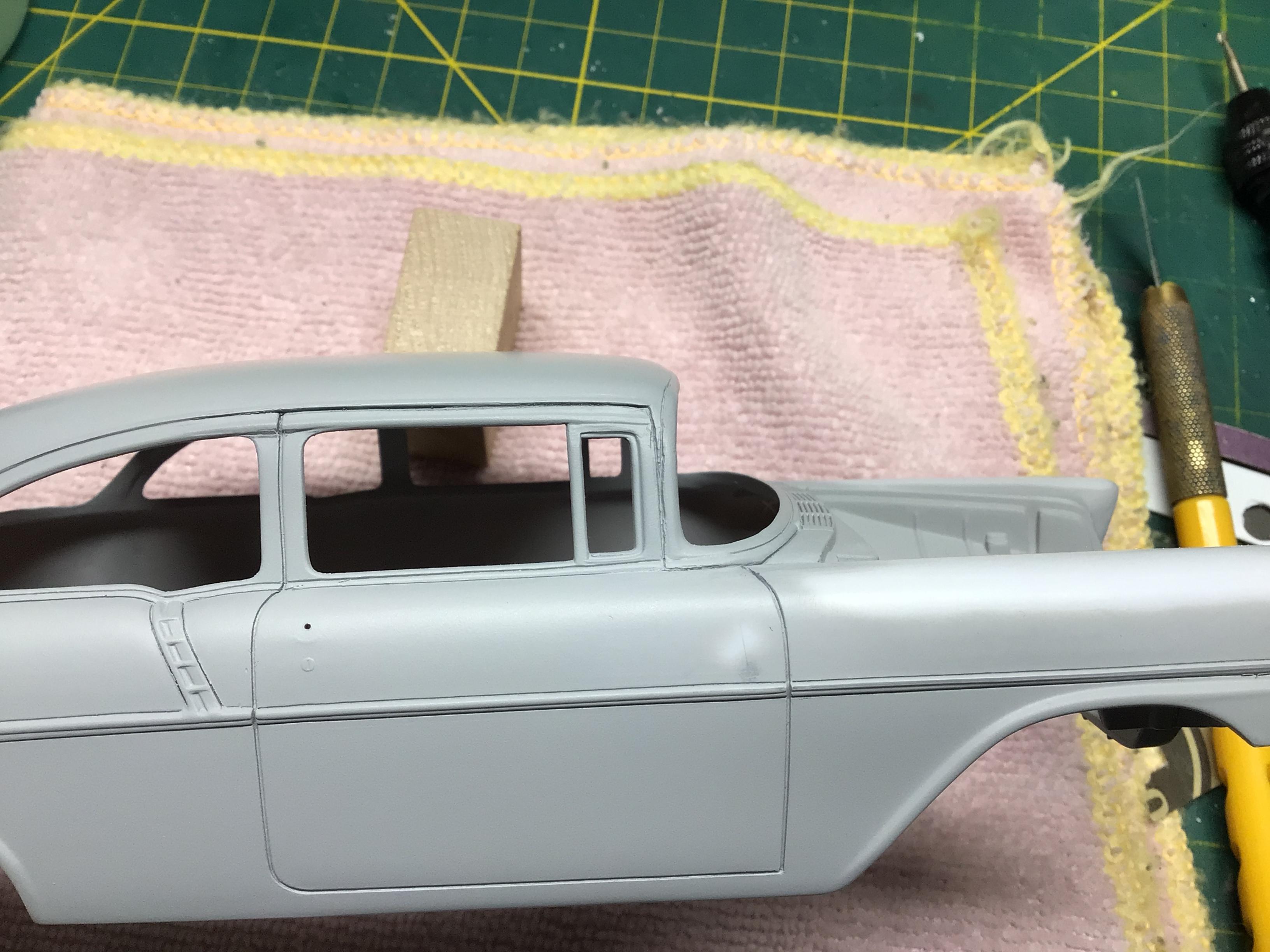

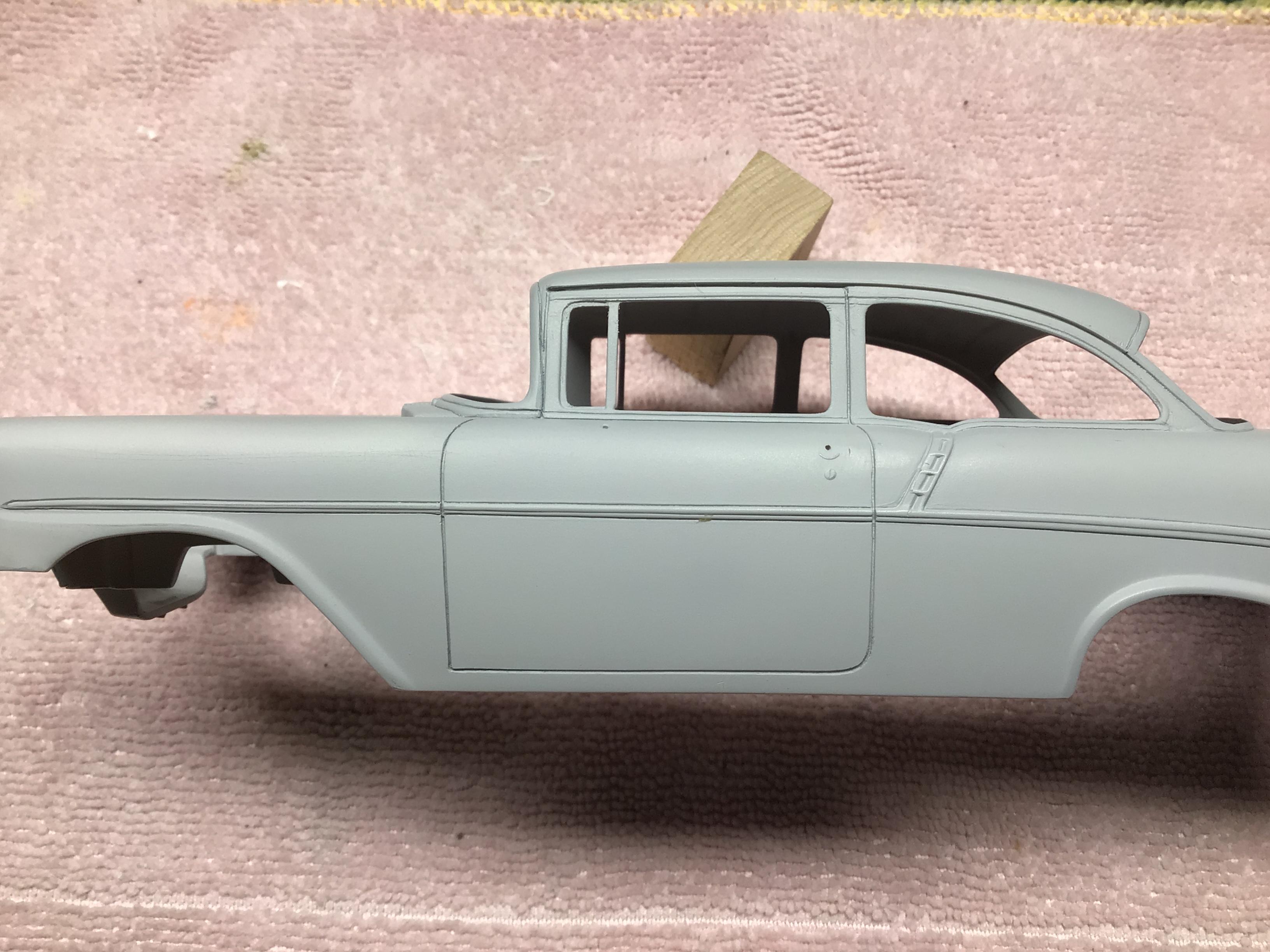

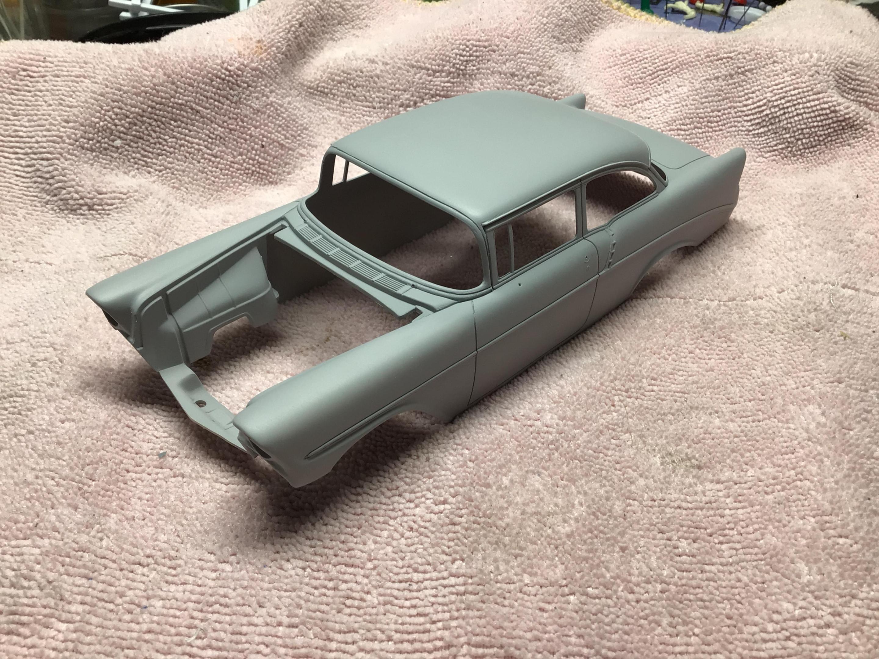

I started this one a while back. I thought I had it prepped well enough, so I masked it and shot the black. Well a big sink mark showed up so I stripped it down and hopefully filled it (and a few others) well enough. While looking at it with better glasses on, I decided I didn’t like the way the vent windows looked. I wound up filing off the bead just above the window and replacing it with some .020” half round. It needed to be raised a tad in order to get the vent window big enough. It should be about 1/3 of the way up on the door frame…not flush with the window opening.? Once that was done the drip rails looked a bit small, so I filed them off too and replaced them with .015”x.020” evergreen. All comments good or bad welcome.?

2 hours ago, oldnslow said:
looks great , please add the line at the back of the fender from the door line down . ( my little pet peave ) ?
Thanks for reminding me Robert. ?
