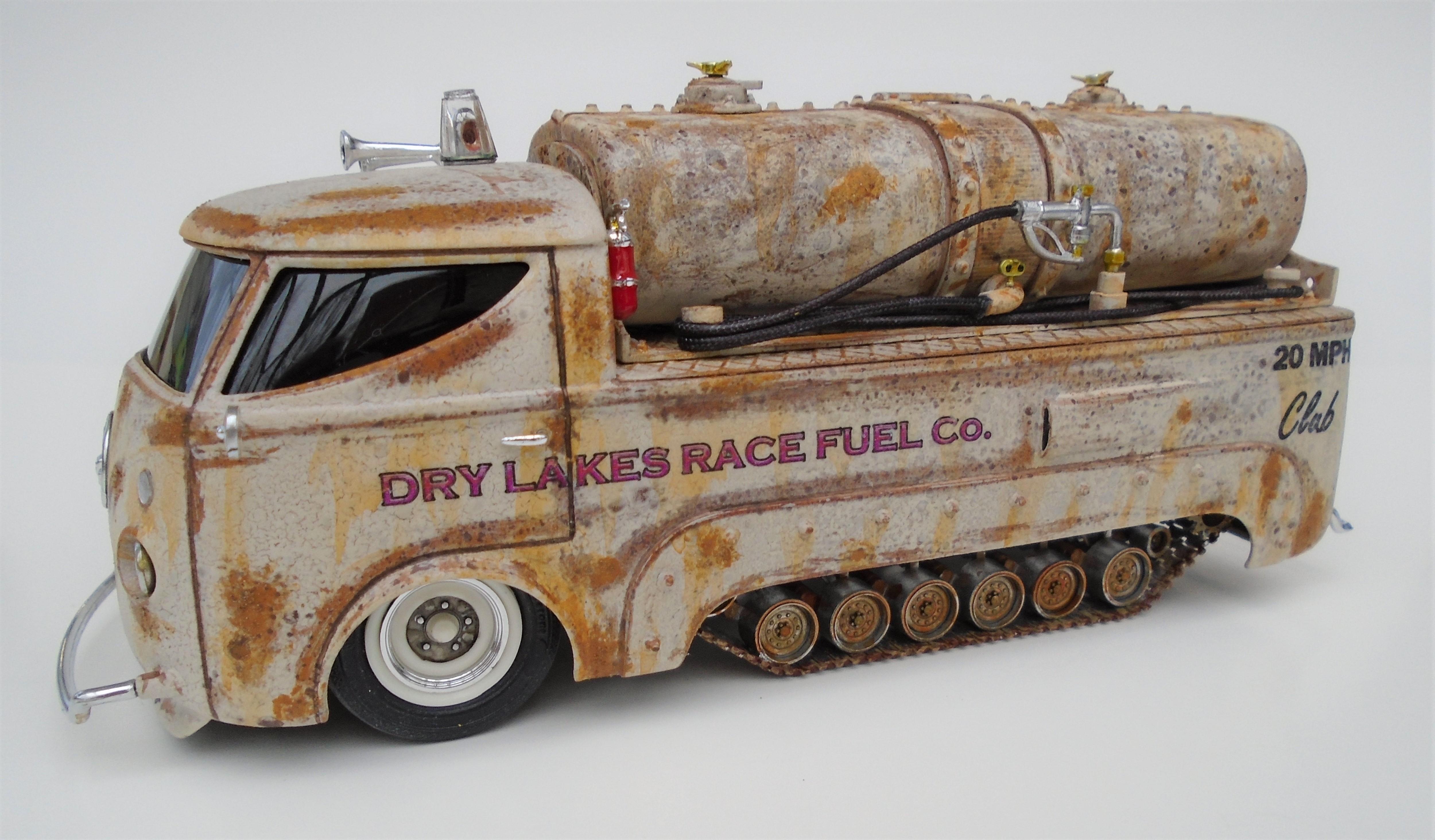

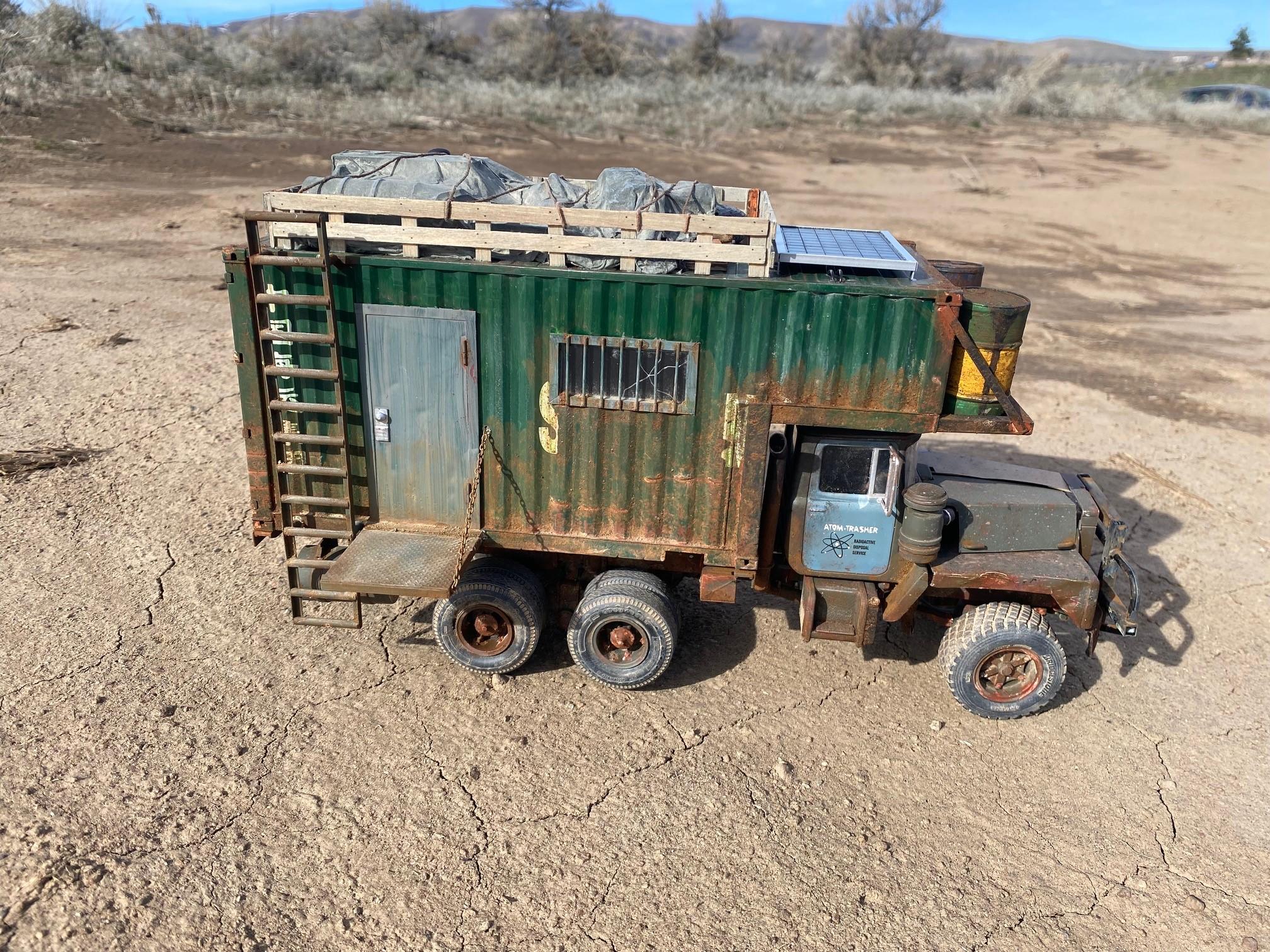

Oldmopars Posted June 1, 2022 Posted June 1, 2022 (edited) This is great, thanks for sharing. I have found the best resources for weathering tutorials (YouTube) is from the guys that built Armor, Tanks, planes, military and Dioramas. Scale Creation World, Night Shift, Scale-a-Ton, and many more. I learned a huge amount from them and I have been fairly successful in recreating weathering with their help. While these are my creations, all of the weathering that I used I learned from these very helpful YouTubers. Edited June 1, 2022 by Oldmopars 2

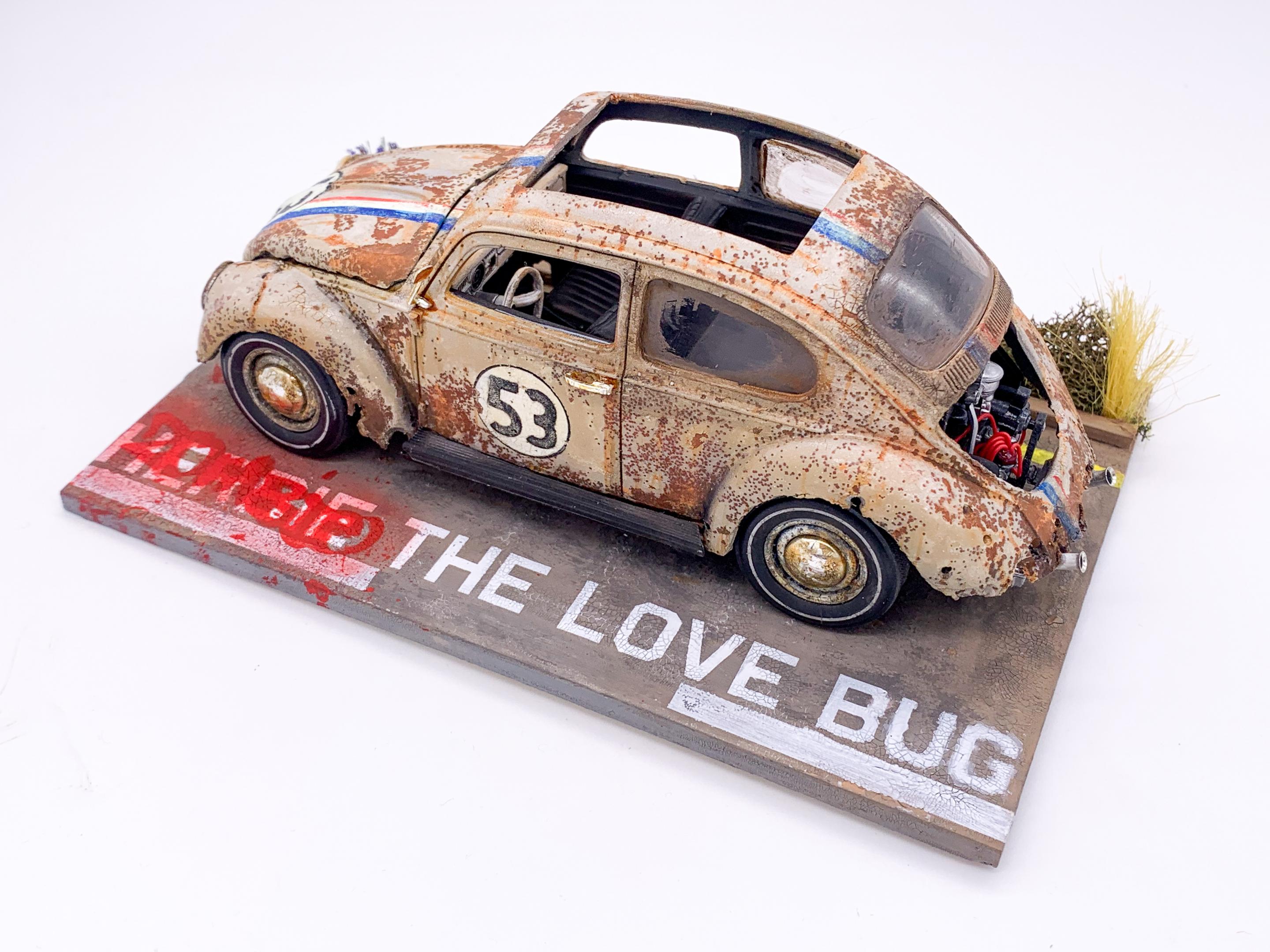

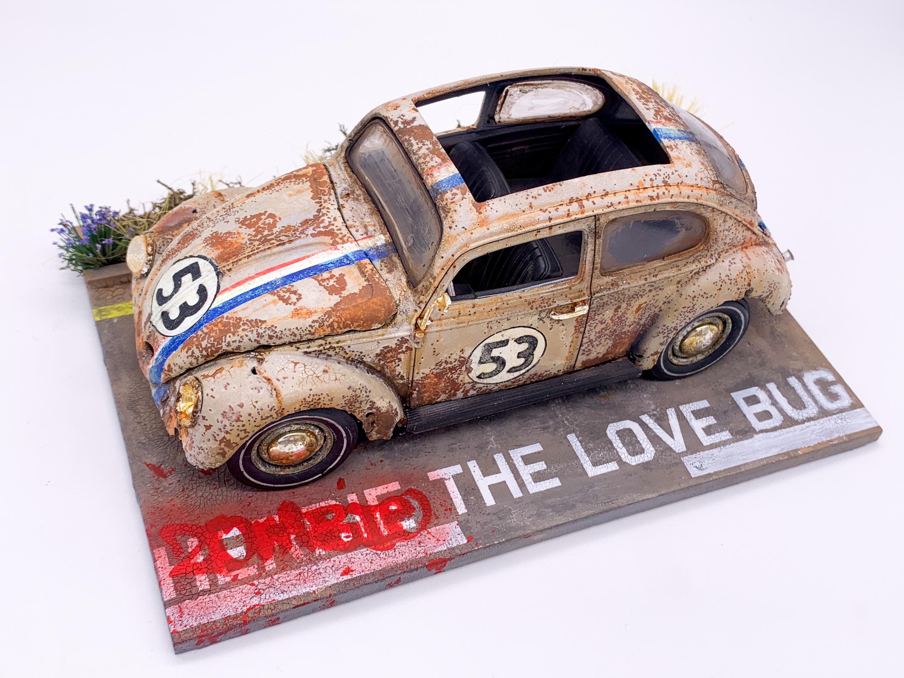

OldNYJim Posted July 26, 2022 Posted July 26, 2022 I did a similar project last year - it's fun to beat up on Herbie! 2

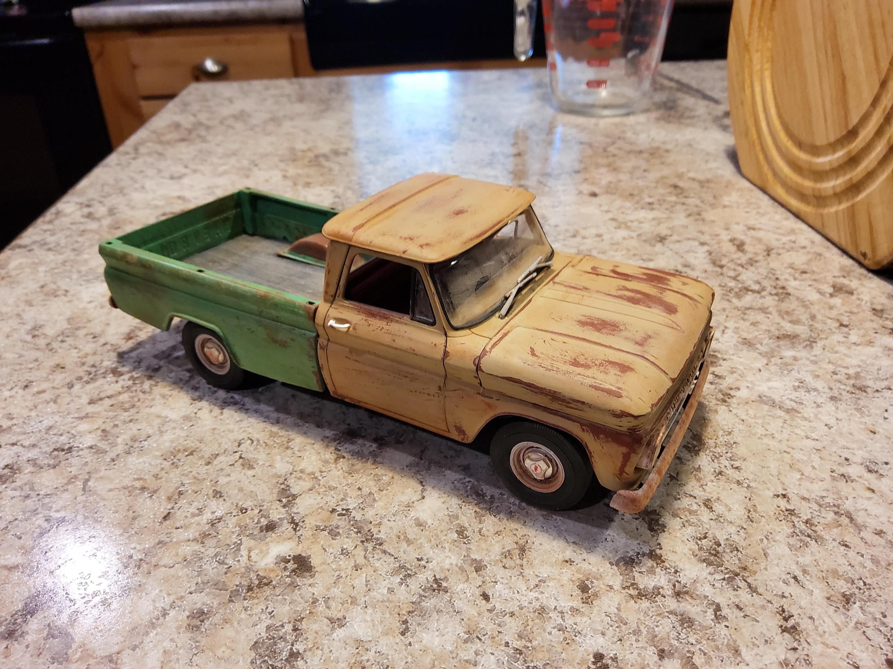

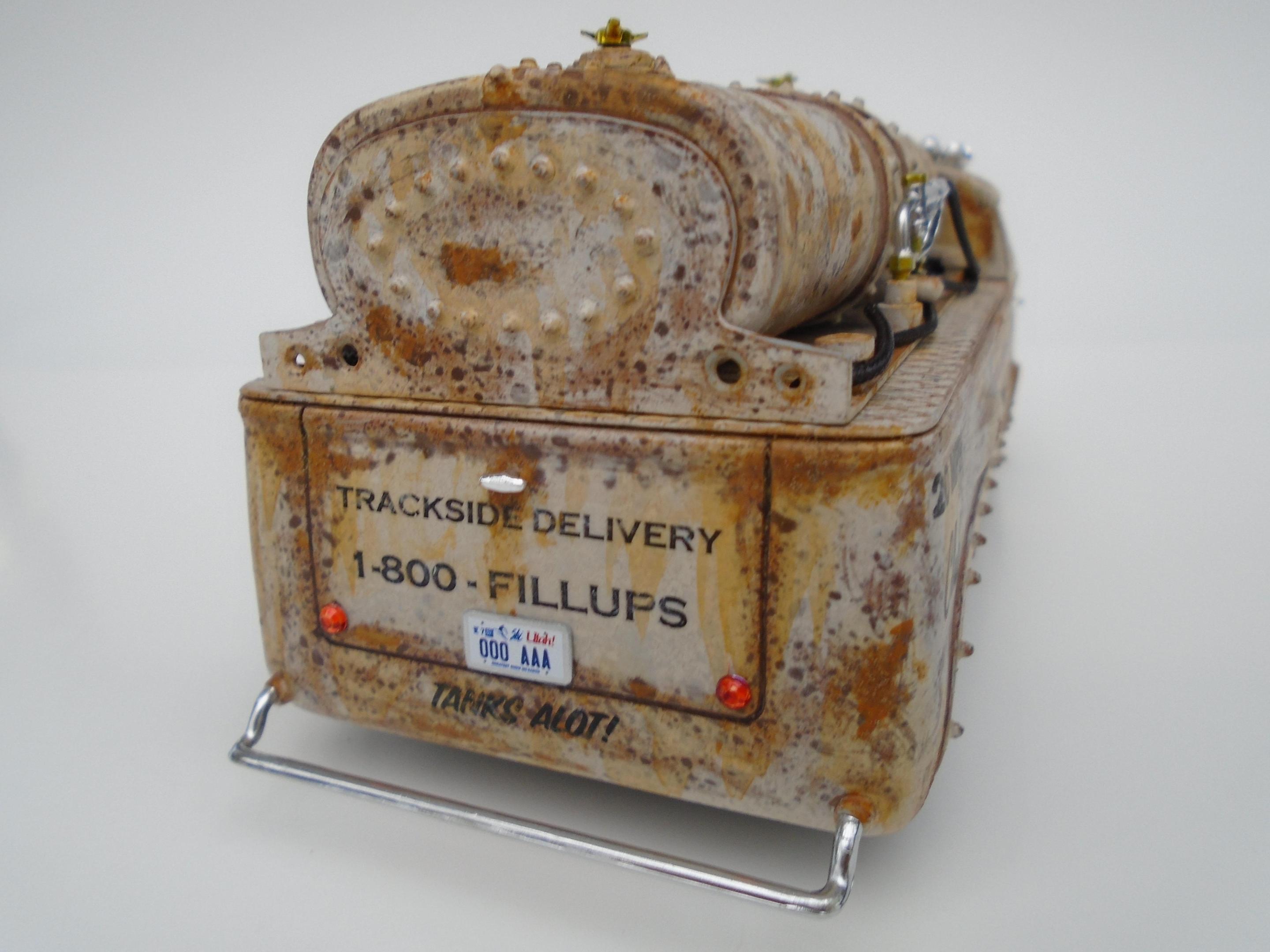

Claude Thibodeau Posted July 26, 2022 Posted July 26, 2022 HI! here's overall rust, done with the "air spray" method, using Tamya's brown lacquer base, then the air spray, then Tamya's acrylics, later scraped with a wet,short bristle cheap Dollar store paint brush. Vallejo washes for the rust "runs". Good luck with your project! CT 2

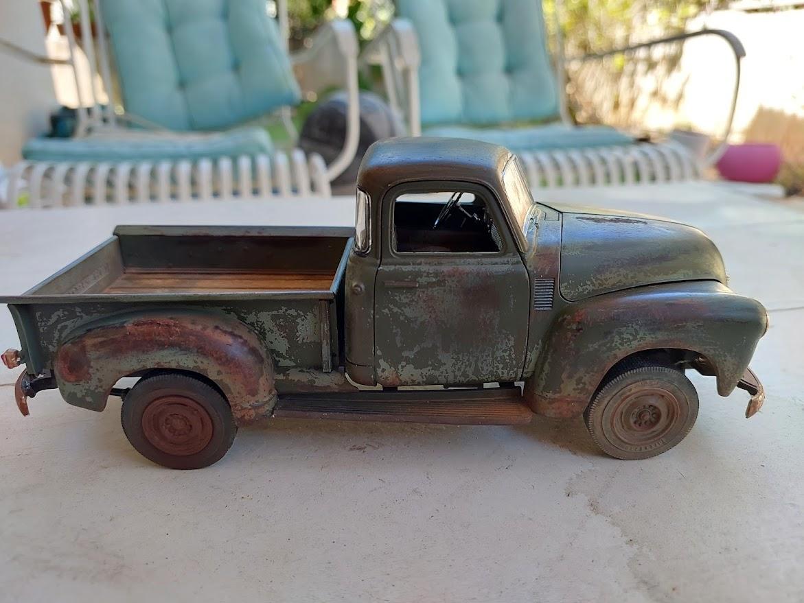

eran_k Posted June 2, 2024 Posted June 2, 2024 here i used a combination of technics: first the entire body was sprayed with dark brown next layer was light green, once dry i went over most of the body with 1000 wet sandpaper, gently exposing the dark color underneath next came a layer of "chipping" medium followed by a darker green layer, once the chipping is activated, it created the effect i was after of layers of older and newer paint and rusting and flaking paint. after that came applications of washes of various rusty shades, pigments and some brush strokes here and there. 1
