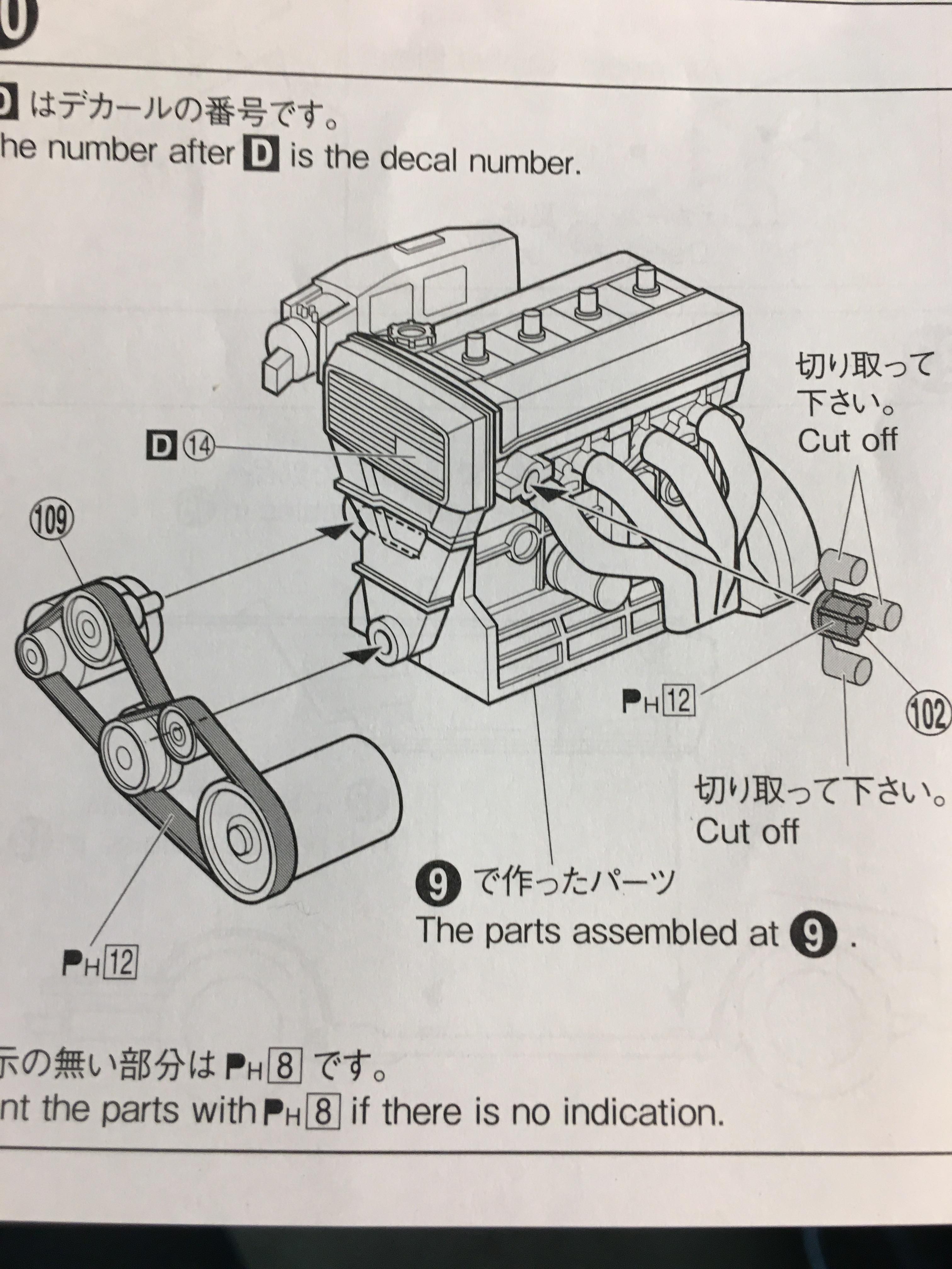

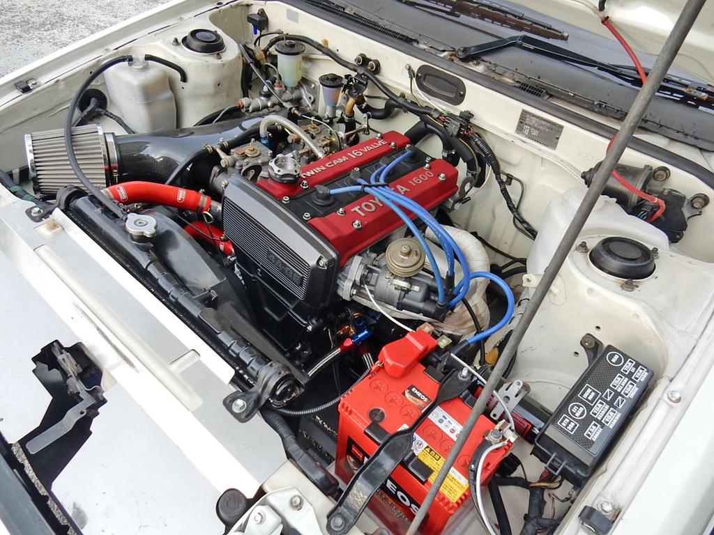

Saltie Olds Posted June 2, 2022 Posted June 2, 2022 Does anyone know how I’d wire the distributor, on the 4A GE engine? I know the firing order is 1-3-4-2, but where does the wire from the middle of the cap go? Thank You
peteski Posted June 2, 2022 Posted June 2, 2022 The middle wire on any distributor goes to the high voltage (center) terminal on the ignition coil (often mounted off-engine on a wheel-well or firewall).
Saltie Olds Posted June 3, 2022 Author Posted June 3, 2022 39 minutes ago, peteski said: The middle wire on any distributor goes to the high voltage (center) terminal on the ignition coil (often mounted off-engine on a wheel-well or firewall). Great, Thank You. I just need to decide if I want to wire it and see if I have an extra coil to mount behind the battery.
Fat Brian Posted June 3, 2022 Posted June 3, 2022 The ignition coil on the 86 is between the battery and shock tower on the (US) drivers side of the engine bay.
Saltie Olds Posted June 3, 2022 Author Posted June 3, 2022 2 hours ago, Fat Brian said: The ignition coil on the 86 is between the battery and shock tower on the (US) drivers side of the engine bay. Thank You. I also realized that I’ll have to move the brake master cylinder to the left side of the car as well.
