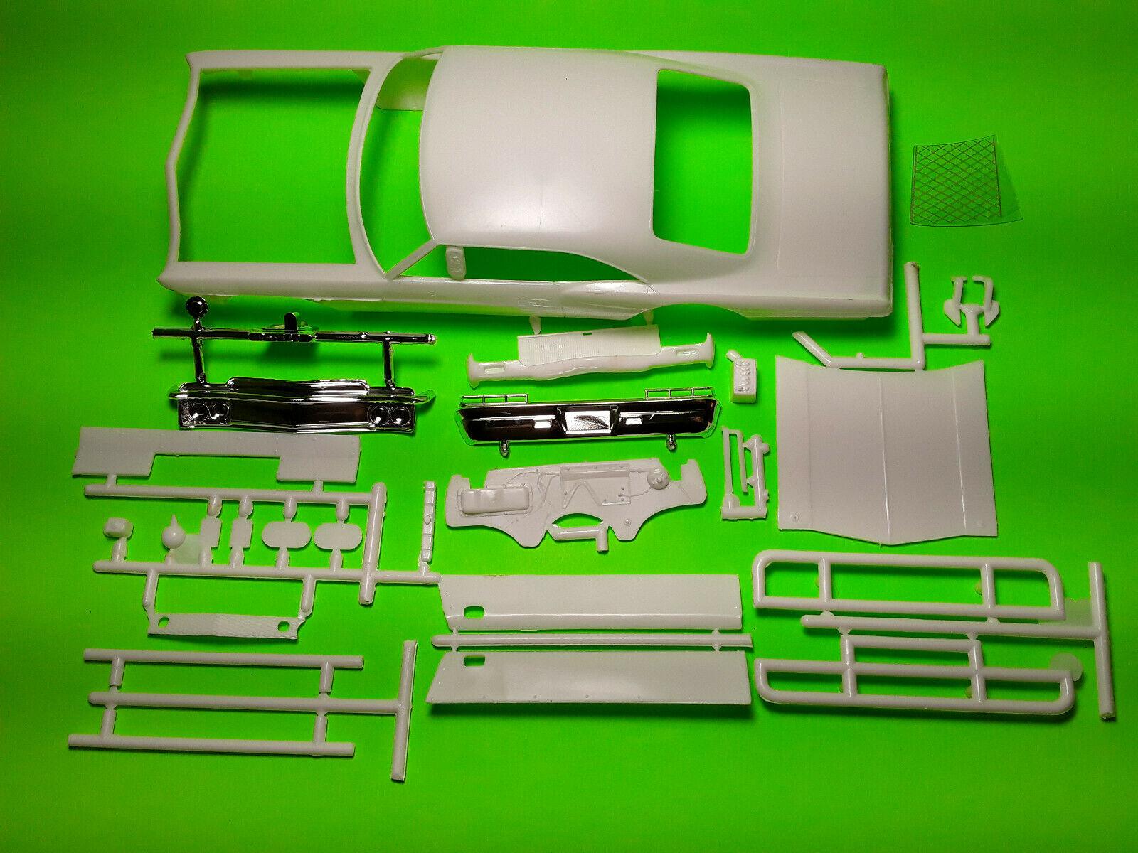

blizzy63 Posted July 6, 2022 Posted July 6, 2022 It appears that the grille/front bumper unit has definately been, um, modified... The hood has gained a pair of hood pins. The separate hood hinges are still in the kit. The rear bumper/taillight bezels appear untouched but there are no clear red taillight lenses. 1
Carmak Posted July 7, 2022 Author Posted July 7, 2022 22 hours ago, blizzy63 said: It appears that the grille/front bumper unit has definately been, um, modified... The hood has gained a pair of hood pins. The separate hood hinges are still in the kit. The rear bumper/taillight bezels appear untouched but there are no clear red taillight lenses. Thanks Robert! this is perfect!

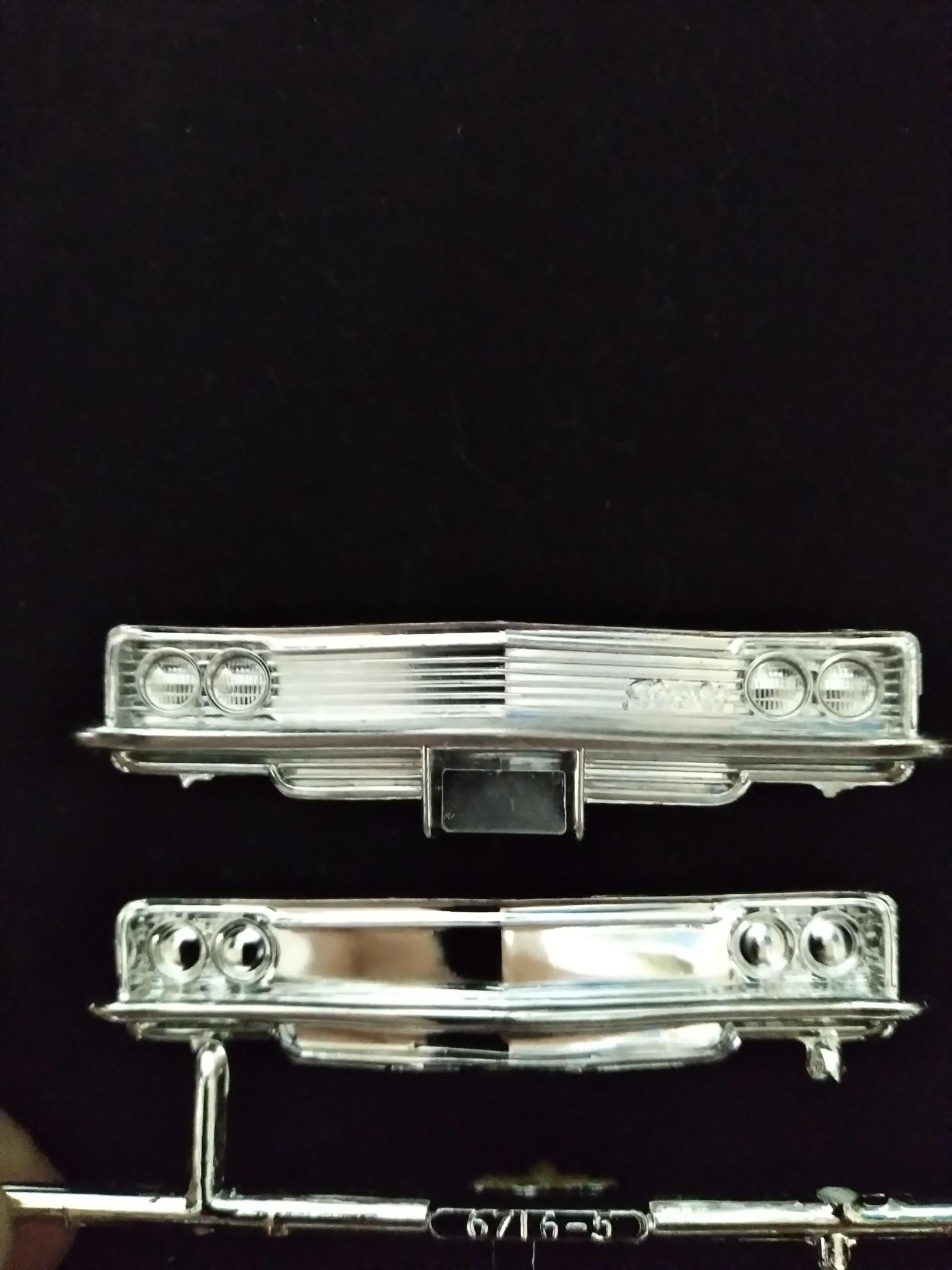

Snake45 Posted July 10, 2022 Posted July 10, 2022 I think you could get away with the grille, if you could replace the headlights. 1
Carmak Posted July 11, 2022 Author Posted July 11, 2022 On 7/10/2022 at 12:21 PM, Snake45 said: I think you could get away with the grille, if you could replace the headlights. Although it's currently packed I think my parts box has an original front bumper grille. If I can't find my original I agree that the Modified stocker grille could be made to work since the 66 grille pattern is basically horizontal ribs.
jokar124 Posted July 12, 2022 Posted July 12, 2022 On 7/10/2022 at 1:21 PM, Snake45 said: I think you could get away with the grille, if you could replace the headlights. The modified stocker grille (bottom) is missing the Chevrolet Impala SS emblem, licence plate and guards, lens pattern and grille elements compared to the annual grille above.
Carmak Posted July 12, 2022 Author Posted July 12, 2022 15 hours ago, jokar124 said: The modified stocker grille (bottom) is missing the Chevrolet Impala SS emblem, licence plate and guards, lens pattern and grille elements compared to the annual grille above. After seeing tis pic I really hope I can find my original issue grille
