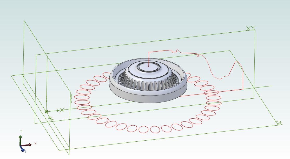

Repstock Posted September 25, 2022 Posted September 25, 2022 This is my first 3D drawing. Will all the extra surrounding lines affect the use of the model? I'm still learning, But I'd like to use this if I can. I waited to the end to scale it, and if I try to erase the extra lines, It returns to too large.
my66s55 Posted September 25, 2022 Posted September 25, 2022 If they don't have a face and are just lines they won't print. I use the Meshlab program to check my files for correctness. It will show you what the file will print.
MeatMan Posted September 25, 2022 Posted September 25, 2022 11 hours ago, Repstock said: This is my first 3D drawing. Will all the extra surrounding lines affect the use of the model? I'm still learning, But I'd like to use this if I can. I waited to the end to scale it, and if I try to erase the extra lines, It returns to too large. Hey Tom, I think you did well for your first drawing. I may have to give that a go myself. My recommendation is to redraw it in the correct scale, or leave it in the original size and rescale the stl.
Repstock Posted September 25, 2022 Author Posted September 25, 2022 1 hour ago, MeatMan said: Hey Tom, I think you did well for your first drawing. I may have to give that a go myself. My recommendation is to redraw it in the correct scale, or leave it in the original size and rescale the stl. I redrew it in the correct scale. Now I don't have to worry about it.
Repstock Posted September 25, 2022 Author Posted September 25, 2022 1 hour ago, my66s55 said: If they don't have a face and are just lines they won't print. I use the Meshlab program to check my files for correctness. It will show you what the file will print. I redrew it before I saw your reply. Nice to know the lines won't print. My program analyzed the drawing and saw no issues. 1
