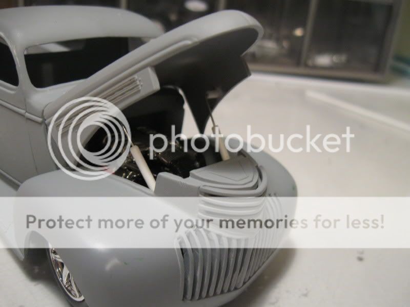

Hey bro Looking Great so far :) . A forwadr flip hood isn't nearly as hard as it looks, and since ol CB referenced my build (thankx for the compliment CB) I fugured I'd post the link to it incase you want to use it as a reference so here it is , the hood operation is about 3/4 the way down page 3 (posted Feb 1). Hope it helps (not that you need it).
thanks guys for the input for the flip front ,but it won't work on the truck. I need to go up and over the grill area. I did a flip like that on the "COUPSTER". this hood needs to go up about 1/4 inch straight up and then flip forward. thanks alot and please keep on with the input.

Here's a little something you may want to try that's a little challanging, and could work as you say the engine sit's pretty low, so may not interfere with this sliding/ tilting/pivoting shock type hinge design, mounted on the inside of the fender panels.
This design allows you to pull the hood straight up, pivot forward, and tilt to whatever angle you want, with 2 pivot points.

hay dave thanks for the input, diagram is great. question though, what stops the wire from comming out of the tube?
Making the 1/32 upper rod longer than it's movement.
You can paint everything seperately, hood and body, then just slide the shocks together.
As you can see in the drawing the alum. tube is mounted off center, so if necessary the pivot fitting can be drilled all the way through so the rod can be most any length you want and slide past the screw that the unit pivots on. That's what i did on the "Retro-Vette".
To center the hole for the 1/32 rod to pass through, I cut a short length of alum. tube and glued it in for a drill guide, drilled the hole, then replaced it with the full length tube.

HAY DAVE IT WORKED! I took your diagram and turned it sideways and ran with it. tweeked the design a little and found a new item to keep around the tool box ( himming pins ) from the fabrick shop. there skinny and moore rigged than wire and don't snap when bent. ;) and the head on them looks like a large carage bolt. thay were used as the pivot bolt and the push rod in the actuator. drilled a large hole in the round plastic almost all the way through then finished the hole with a smaller bit so the head of the pin could not come through and I think it looks like a hydrolic ram.

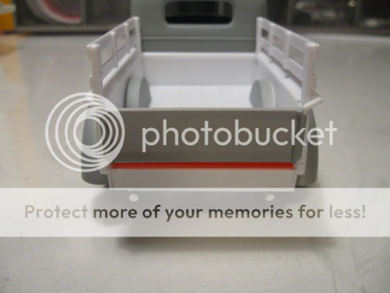

bed floor is painted and gas cap installed.
rams made and in place.
thay actually worked. I can flip it forward also.
don't the pins look like large carage bolts. I'm happy :P
don't the pins look like large carage bolts. I'm happy B)

Your "hydraulic ram system" looks awesome.
That's exciting to see you take a risk and have it work. VERY, VERY KOOOOL!!! :(

I have a VEWY SEEKWATIVE HINT :P for you.
If you bend the sliding pin ever so slightly in the right place, it create's the right amount of "Friction", so your hood is "Poseable" in any position, without a brace to hold it up :P . Worked great on the "Retro-Vette".
Do it first on a sample piece to experiment with. It doesn't take much, and it'll drive "Your Bud's" crazy :blink: trying to figure it out :blink: , and they'll love it.

hay guys thanks for the tips and will definatley try the clear orange on the wood. and Dave thanks for the bending tip ,but I used the himming pins and the head is inside the tube and drags the walls enough to keep it still.
but still want to play with the geometry with spacers to get the flip just right. :P
