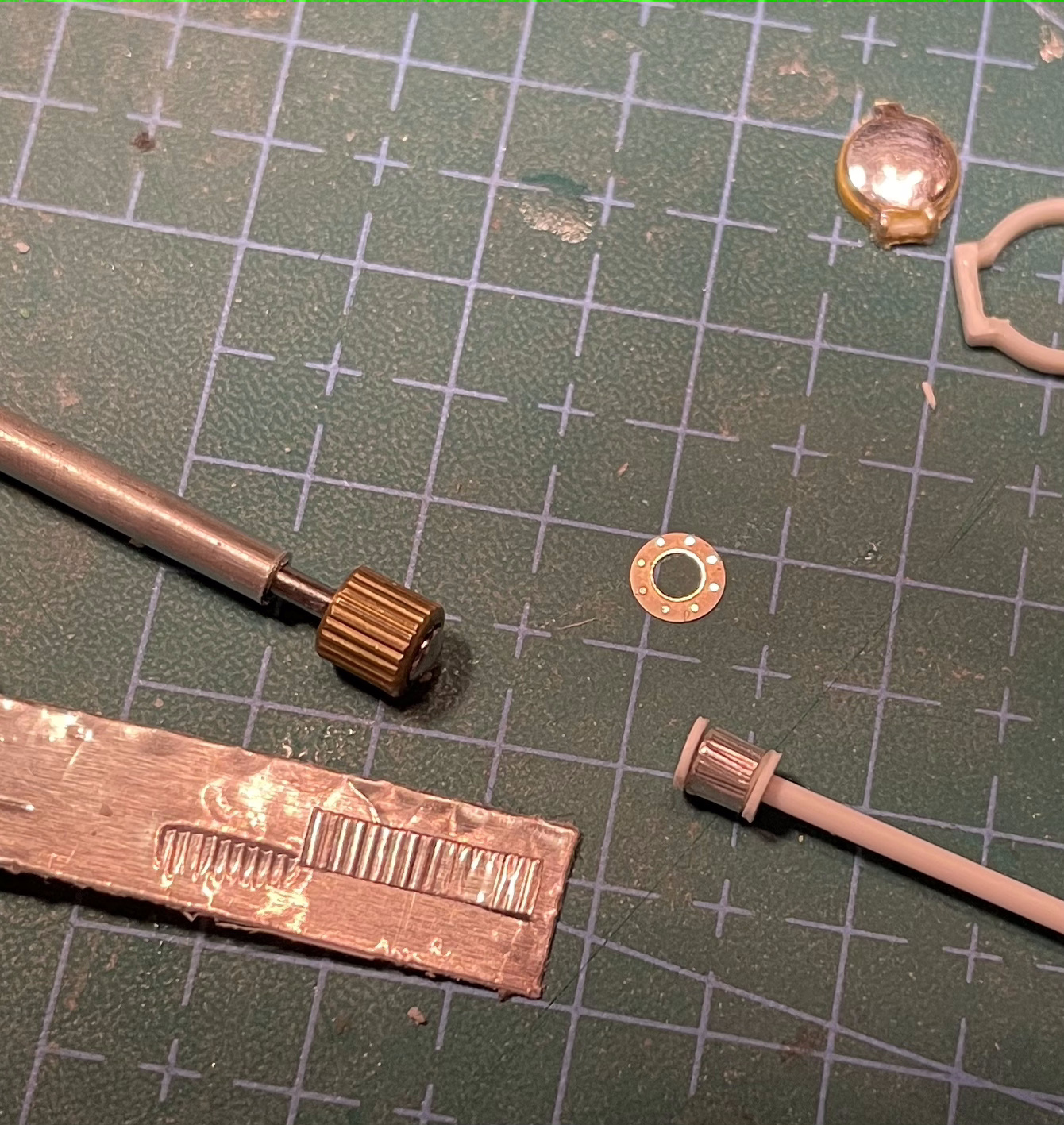

I needed a small air filter element, so I found a picture hanging nail with a brass gear on the end slid it into a good fitting K&S tube then rolled it over some aluminum ducting tape. Then I wrapped the adhesive backed variegated foil around some styrene rod. It will get painted and shaded later. I might make another run at the "element" part because I pulled on it a bit and pulled out the pattern a little.
Anyway, it's easy, cheap, and does not take any special tools.

Sometimes you just have to keep your eyes peeled for ever day items that can double as parts.
I recently found that the "thumb wheel" from the bottom of a lip balm tube makes a pretty good air cleaner element once you hollow out the center and add a seal to each side.
