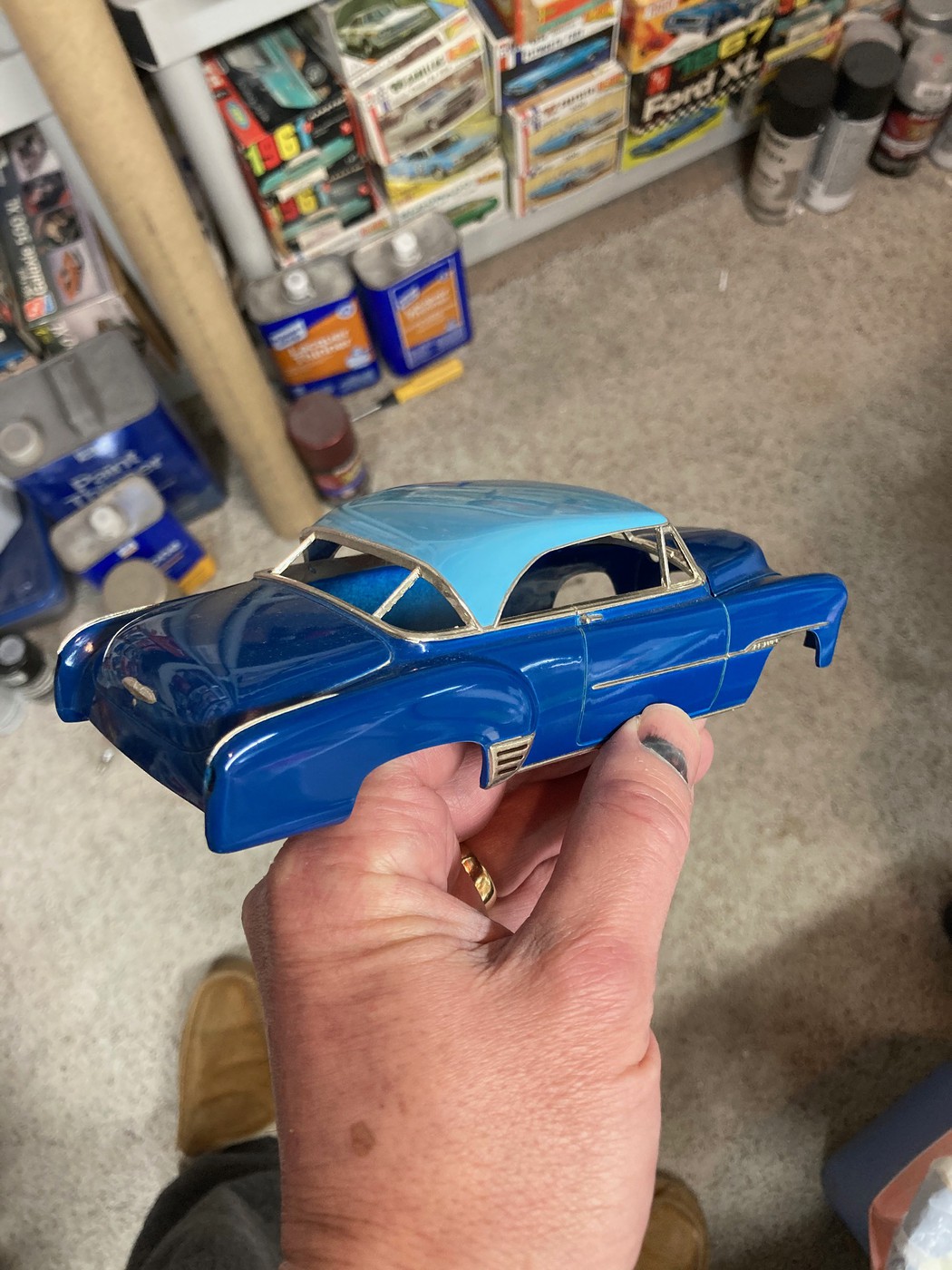

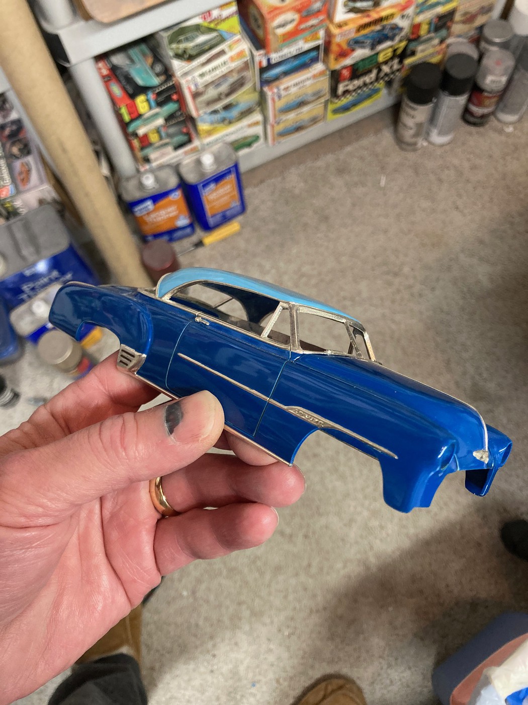

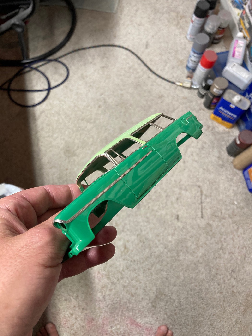

Dpate Posted June 4, 2023 Posted June 4, 2023 (edited) Only enamels I use is Tamiya X & XF line for detail work etc. once you get into the hobby good, wanna use enamels id recommend MCW along with their hardner. I’m strictly auto lacquers for 90% of anything model related. MCW enamels can gloss up really nice, and be sanded, and compounded, and polished up really nice without a separate clear coat. Edited June 4, 2023 by Dpate
Bills72sj Posted June 4, 2023 Posted June 4, 2023 Enamels can give great results. The cure time is the biggest drawback. If you are using rattle cans then 2-4 weeks. If you are airbrushing the little bottles thinned with lacquer thinner then just a few days.
