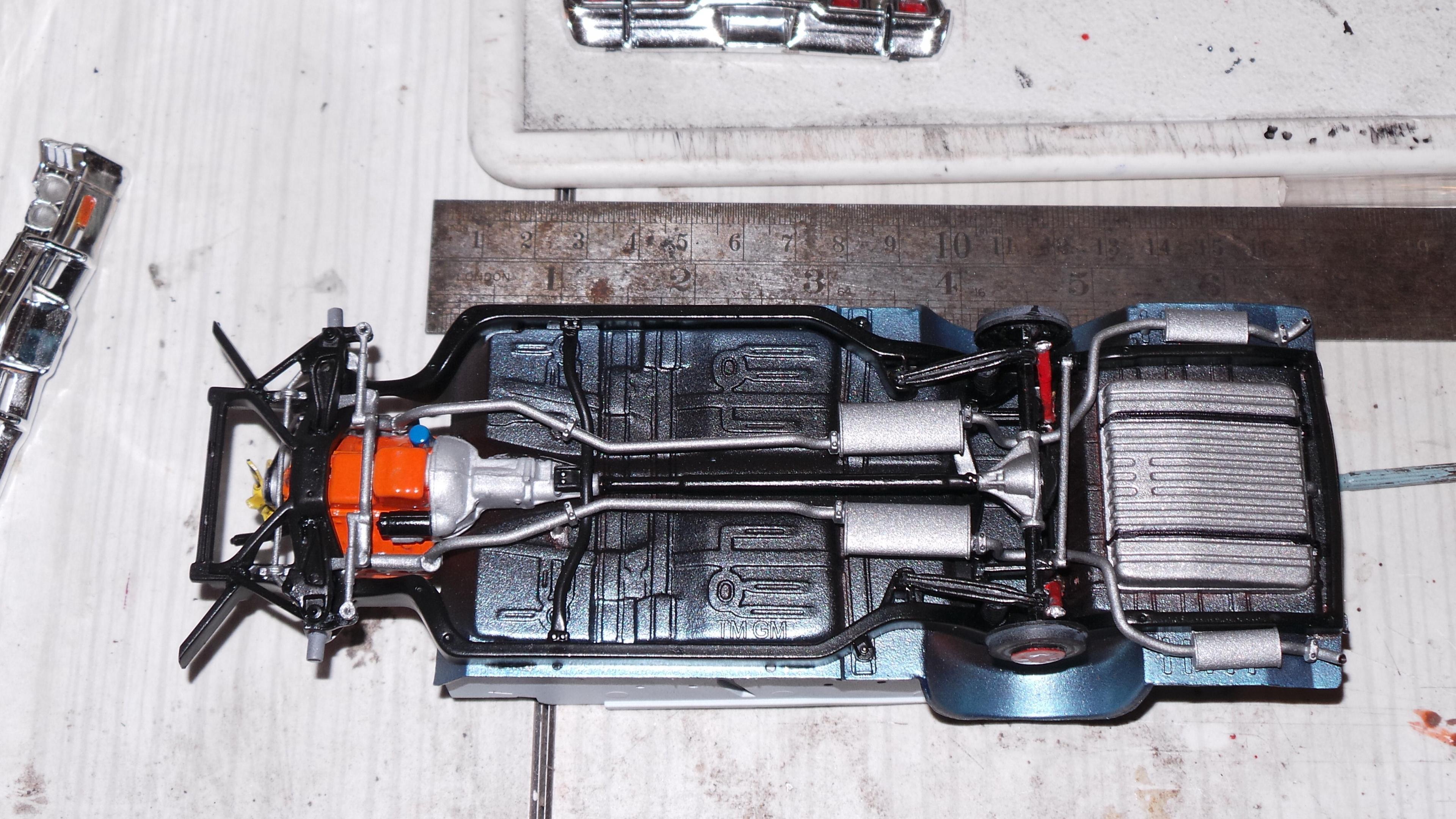

Ace-Garageguy Posted June 11, 2023 Posted June 11, 2023 (edited) Part of your problem is that the steering linkage on the model is kinda kludgey, and takes up more space than it does in reality. The big-block pan in the kit may have been creatively "adjusted" by the kit designers to compensate. This photo, sourced from a build on this forum by doorsovdoon, shows what I mean... Edited June 11, 2023 by Ace-Garageguy 2
