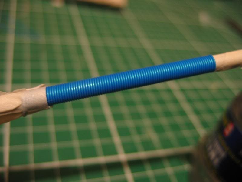

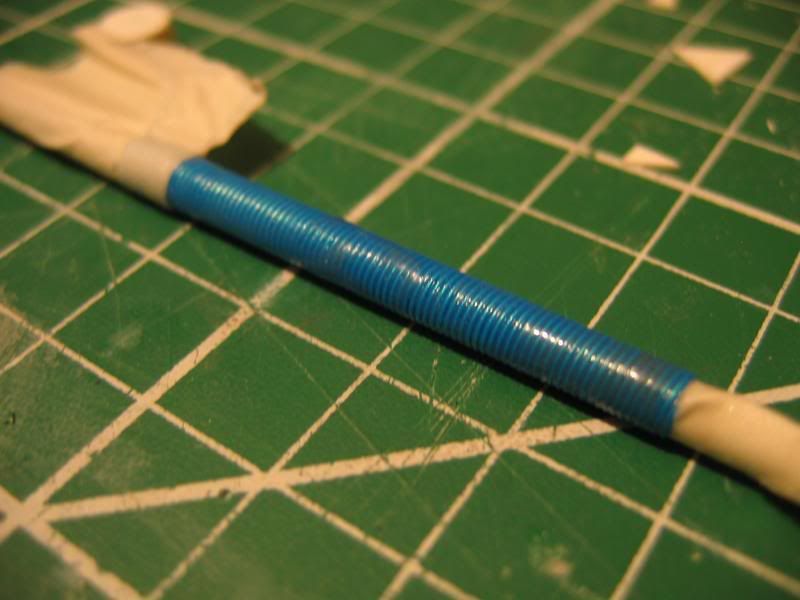

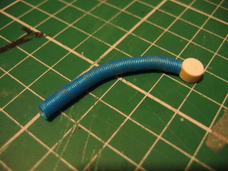

bobcrozier Posted February 28, 2009 Share Posted February 28, 2009 I needed intake ducting for my Warbucks Mustang. I racked my brains and then recalled an old tip from years ago - from where I cannot recall - I came up with this: It makes use of Revell's Contacta Liquid Special. I had a bottle given to me and decided I would find a use for it! Well - its good for gluing in small chrome parts and clear parts to painted surfaces - winscreens, lenses, wing mirrors etc. its a bit like Microscale's Kristal Klear and Humbrols Clearfix. You could probably use either of these or even just some good old PVA glue. First I took some fine plastic coated wire approx 0.5mm (20 thou)dia. and wrapped it round some 3.2mm ali tube, anchoring it with some tape at each end. I used wire wrap wire: If you can't get hold of it the scale ignition wire sold by the like of Detailmaster and others is identical (another tip there!) Then I painted on a fairly liberal coat of Contacta and let it dry (approx 1hr). Then I removed the tape and pushed the spiral off the end of the tube. At this point it may stick, the four I made came off OK after a bit of pushing, but I can imagine it being a problem, so maybe a little wax on the ali tube before wrapping on the wire might be a good idea! At this point the "tube" is still floppy but quite firm in cross section. If handled carefully it can be "moulded to fit" around the engine bay.After some time it becomes more rigid, but still remains somewhat flexible. Here it is mated up to the little airboxes that mount on the carbs Paint it to suit! Should work for larger radiator hoses and brake cooling ducts etc. Bob Quote Link to comment Share on other sites More sharing options...

Olle F Posted March 3, 2009 Share Posted March 3, 2009 That looks great! I have been experimenting with different ways of making those hoses but have never been able to make one that looks as good as yours. You might want to try thinned Plasti-Dip instead of that Contacta stuff next time. I used this to make a wire harness, and it came out pretty good. You can thin it to the consistency you like, and it will give you a nice, even coat that is also very flexible and durable. I couldn't even scrape it off with my fingernail, so it was very easy to install the harness without damaging it. Quote Link to comment Share on other sites More sharing options...
