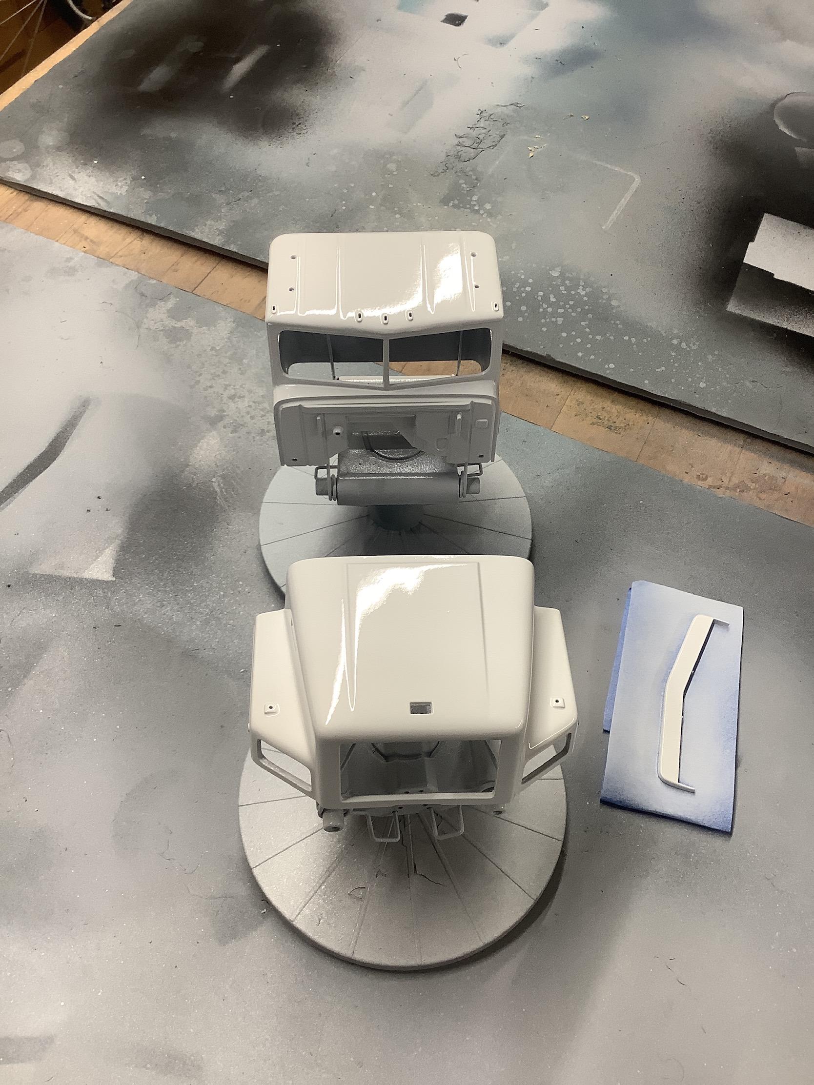

Gary Chastain Posted October 8, 2023 Author Posted October 8, 2023 I need some help guys. I am trying to paint some resin cast hood and fenders. I washed the parts in hot dish soap water, paint fish eyes, I soaked the parts in the purple pond and washed, paint fish eyes. Wiped it down with lacquer thinner, paint fish eyes. Not sure what to do. Using Tamiya primer.

Gary Chastain Posted October 8, 2023 Author Posted October 8, 2023 Well this went from oh no, to oh BLAH_BLAH_BLAH_BLAH, to worse, to junk. Managed to save and remove the paint on all the resin parts that where actually causing the paint problems but the gray cab itself is now junk. Luckily I have another white cab. Tomorrow I will start over. A setback for sure
JamesBC Posted October 8, 2023 Posted October 8, 2023 Well you are not alone on problems like that. I have a half way build Caterpillar that the same thing happened,,,paint just would not lay flat. And when I tried to use purple bath to start over the paint and primer wrinkled and just refuses to come off. That is the last time I use Tamiya paint, I a lot of modelers use it but it just never does good for me. I am sure its not the paint but somethings I do but Tamiya went out the door and going to use Vallejo from now on. Had used Vallejo before with good results but I tried Tamiya for only one reason, only hobby paint I could buy in city where I live. So waiting on order of Vallejo. Sure do like the looks of that truck you are building,,
Gary Chastain Posted October 8, 2023 Author Posted October 8, 2023 37 minutes ago, JamesBC said: Well you are not alone on problems like that. I have a half way build Caterpillar that the same thing happened,,,paint just would not lay flat. And when I tried to use purple bath to start over the paint and primer wrinkled and just refuses to come off. That is the last time I use Tamiya paint, I a lot of modelers use it but it just never does good for me. I am sure its not the paint but somethings I do but Tamiya went out the door and going to use Vallejo from now on. Had used Vallejo before with good results but I tried Tamiya for only one reason, only hobby paint I could buy in city where I live. So waiting on order of Vallejo. Sure do like the looks of that truck you are building,, Same problem with my cab, just wrinkled up and with all the molded in detail of rivets and seams, you just can’t sand it down.
gotnitro? Posted October 9, 2023 Posted October 9, 2023 I've struggled w fisheyes on resin, no matter how much cleaning I've done. I spoke numerous times w Gary Wallace about it, and he always suggested Duplicolor sandable primer. Light coats then color. Its cut my issues in half Too bad you lost your cab, but having a backup plan keeps you moving.
Gary Chastain Posted October 9, 2023 Author Posted October 9, 2023 4 hours ago, gotnitro? said: I've struggled w fisheyes on resin, no matter how much cleaning I've done. I spoke numerous times w Gary Wallace about it, and he always suggested Duplicolor sandable primer. Light coats then color. Its cut my issues in half Too bad you lost your cab, but having a backup plan keeps you moving. Thanks Jeff, went to the automotive paint store today and talked to them. They recommended the Duplicolor sandable primer and suggested just what you said.

Gary Chastain Posted October 10, 2023 Author Posted October 10, 2023 The primer worked very well, no fish eyes or problems on the resin parts. Did a test piece to make sure I can spray Tamiya gloss paint over the primer and it looks good. Sit over night, light sand on primer then start applying base color paint 1
gotnitro? Posted October 11, 2023 Posted October 11, 2023 So glad the Duplicolor worked put for you ! Its my first line of defense working w resin parts. The primer might take a couple days to really cure, but my squirrels have enough projects going to allow me time lol Love the modern look of that hood, gonna be an awesome truck 1
