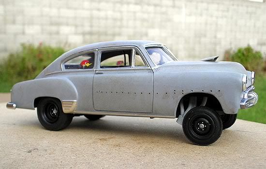

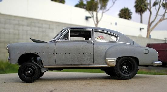

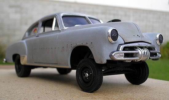

I'd suggest starting with your base primer, and adding washes and drybrushing the wear areas to weather it out a bit:
Afterward, I'd add patches of newer primer, some spotted in with no masking, and maybe one larger patch that actually looks like it's been taped out. Drill holes for missing trim, mirrors, etc. and maybe one off-color faded factory painted fender, door or tailgate to complete the patch-as-you-go appearance.
