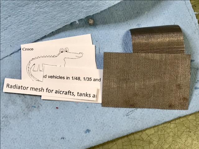

absmiami Posted September 8, 2023 Posted September 8, 2023 Scale - you know that i like to build your models - if you’re tempted to add some detail - try to fund this stuff - its perfect for the engine inlet screen - just sayin …
