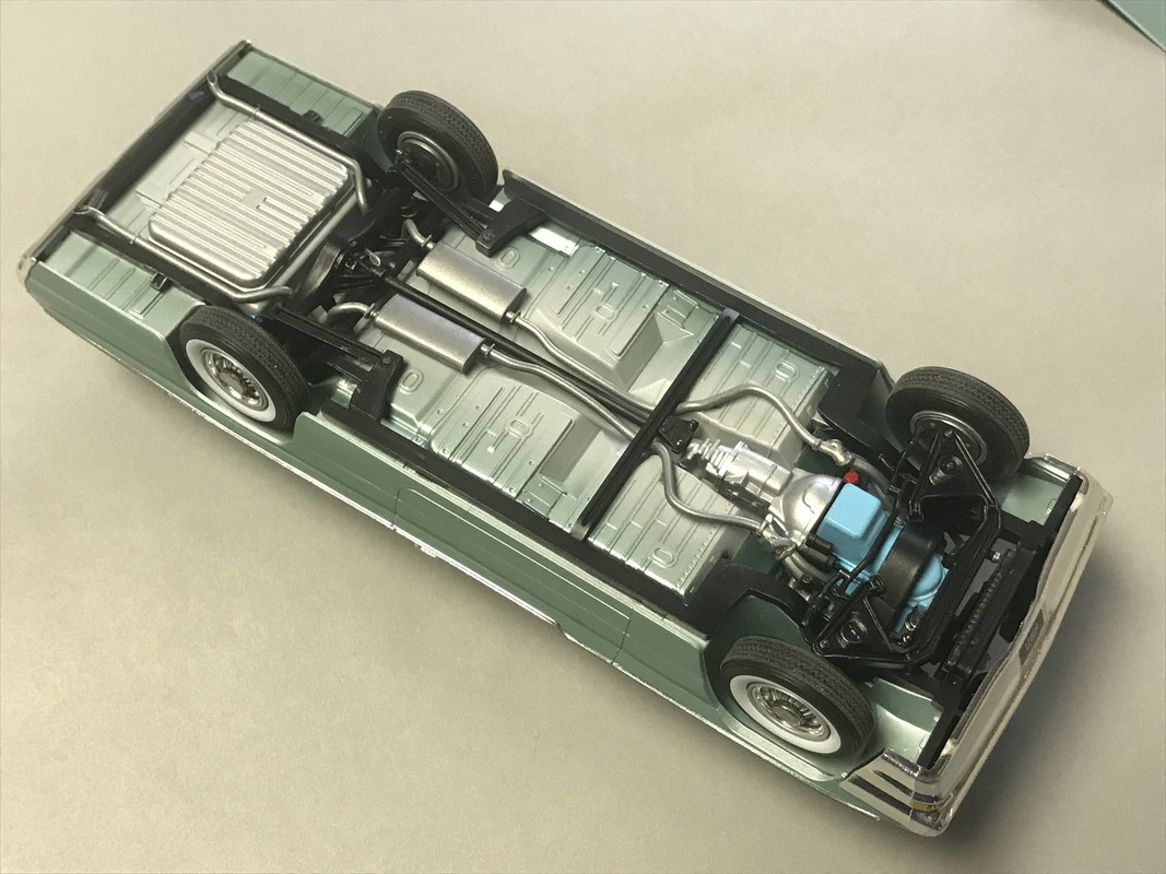

Mike 1017 Posted September 12, 2023 Share Posted September 12, 2023 I am starting to mock-up the car. The exhaust system is giving me fits. The guy on You-Tube just left the exhaust off. With Moebius reputation for quality, I am surprised that I can't figure out what the problem is. Mike Quote Link to comment Share on other sites More sharing options...
Ace-Garageguy Posted September 13, 2023 Share Posted September 13, 2023 (edited) Maybe these shots will help. Edited September 13, 2023 by Ace-Garageguy Quote Link to comment Share on other sites More sharing options...
Deathgoblin Posted September 13, 2023 Share Posted September 13, 2023 (edited) I'm actually working on this one too. There are indents on the inside of the chassis plate that look like they should be for a roll cage, those are for the pins on the exhaust. There are two holes under the rear seat, two over the differential and two at the rear on either side of the gas tank. You have to drill them out. Also, the best order to install is install the lower control arms to the frame since they go in from the top (left mine unglued so I could install the rest of the suspension), glue the frame to the chassis plate, and before you install the engine you should install the exhaust. The front part runs under the transmission crossmember and it's impossible to get it through once the engine is in place. The instructions are really vague on this. I had to rip out the rear seat and the engine once I realized this so I could get it installed properly. Edited September 13, 2023 by Deathgoblin Quote Link to comment Share on other sites More sharing options...
Mike 1017 Posted September 14, 2023 Author Share Posted September 14, 2023 Thank you, guys, for the info. I held the floorboard up to the light and I could see where I had to drill out some holes. Got it all mocked up. Today is engine mock up day. Mike Quote Link to comment Share on other sites More sharing options...
Mike 1017 Posted September 14, 2023 Author Share Posted September 14, 2023 On 9/12/2023 at 10:04 PM, Ace-Garageguy said: Maybe these shots will help. Yes it does. Thanks Mike Quote Link to comment Share on other sites More sharing options...
