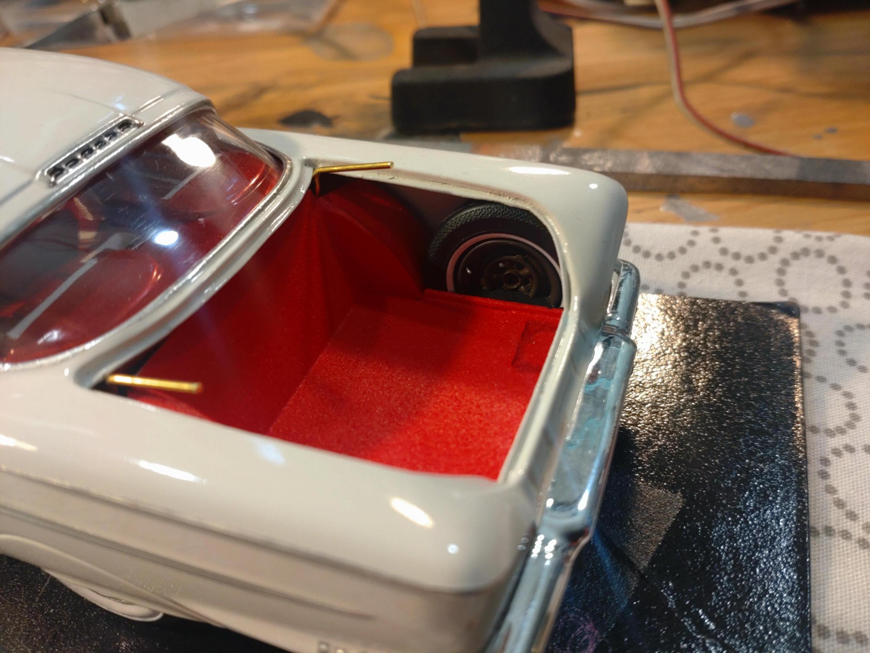

I am finished with the building process now and here are the last images. Connecting the body with the undercarriage was quite smooth and needed only minor cutting and sanding. Starting at the tail I added a tiny metal bead to the trunk for the press/key button. Only later did I realize that the middle lamp of the taillights on the original car were white. Oh well...
The trunk turned out fine. The surface is flocked red on red. Don´t get fooled by the spare wheel. I sliced it to make it fit.

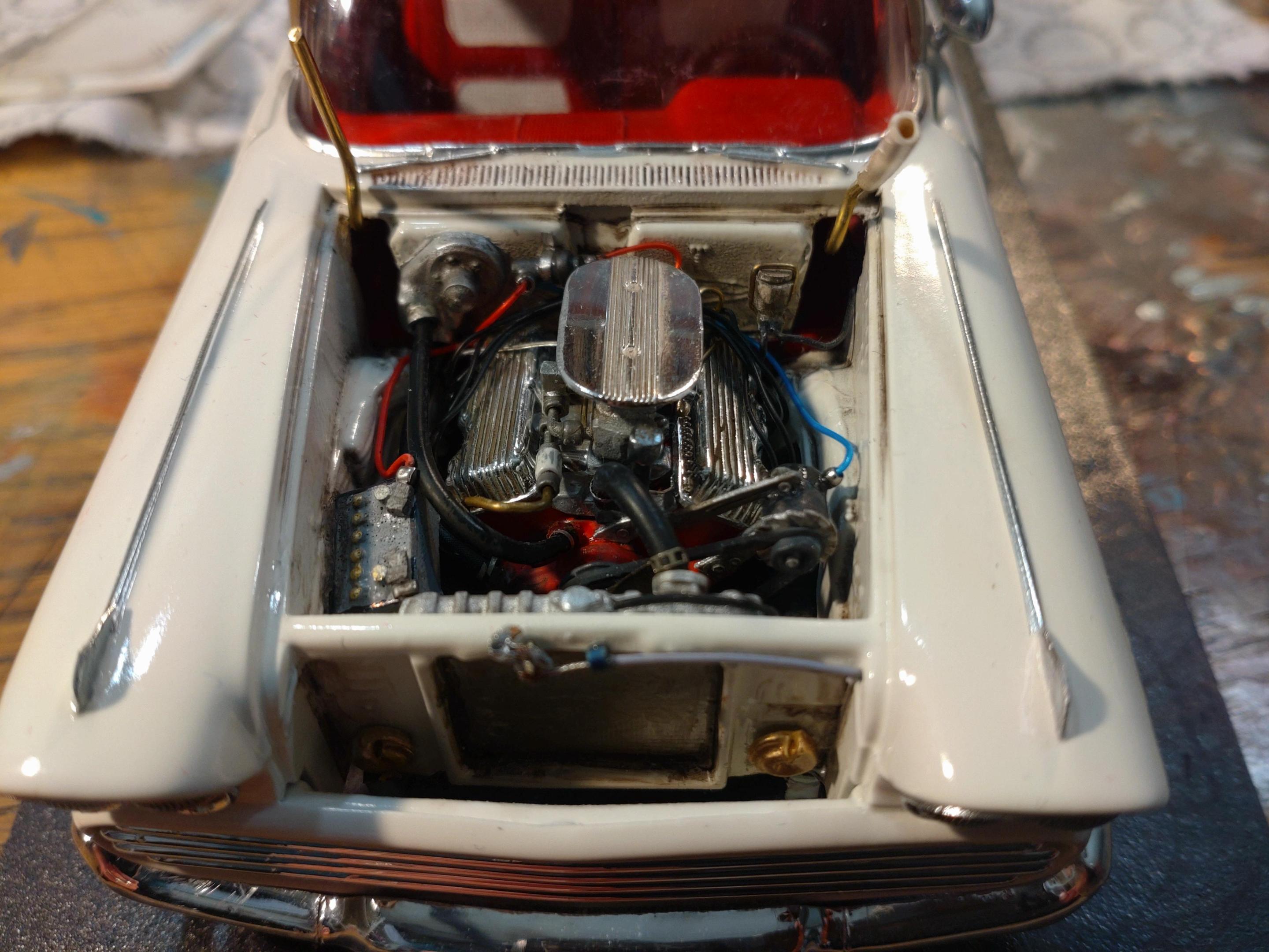

To the end I had the idea for a latch mechanism for the hood. Styrene hook set with a wire pin and piece of insulated wire. I filed the styrene to shape with diamond files. And a bit of rust too.
The engine bay is as crowded as the real thing. The coil and the brake booster are home made with different pieces of styrene and wire. They too are connected with 0.5mm brass pins. I feel much more comfortable now with this procedure. Once attached to the body with super glue, I can work the wiring much harder now without risking to break them off again.
