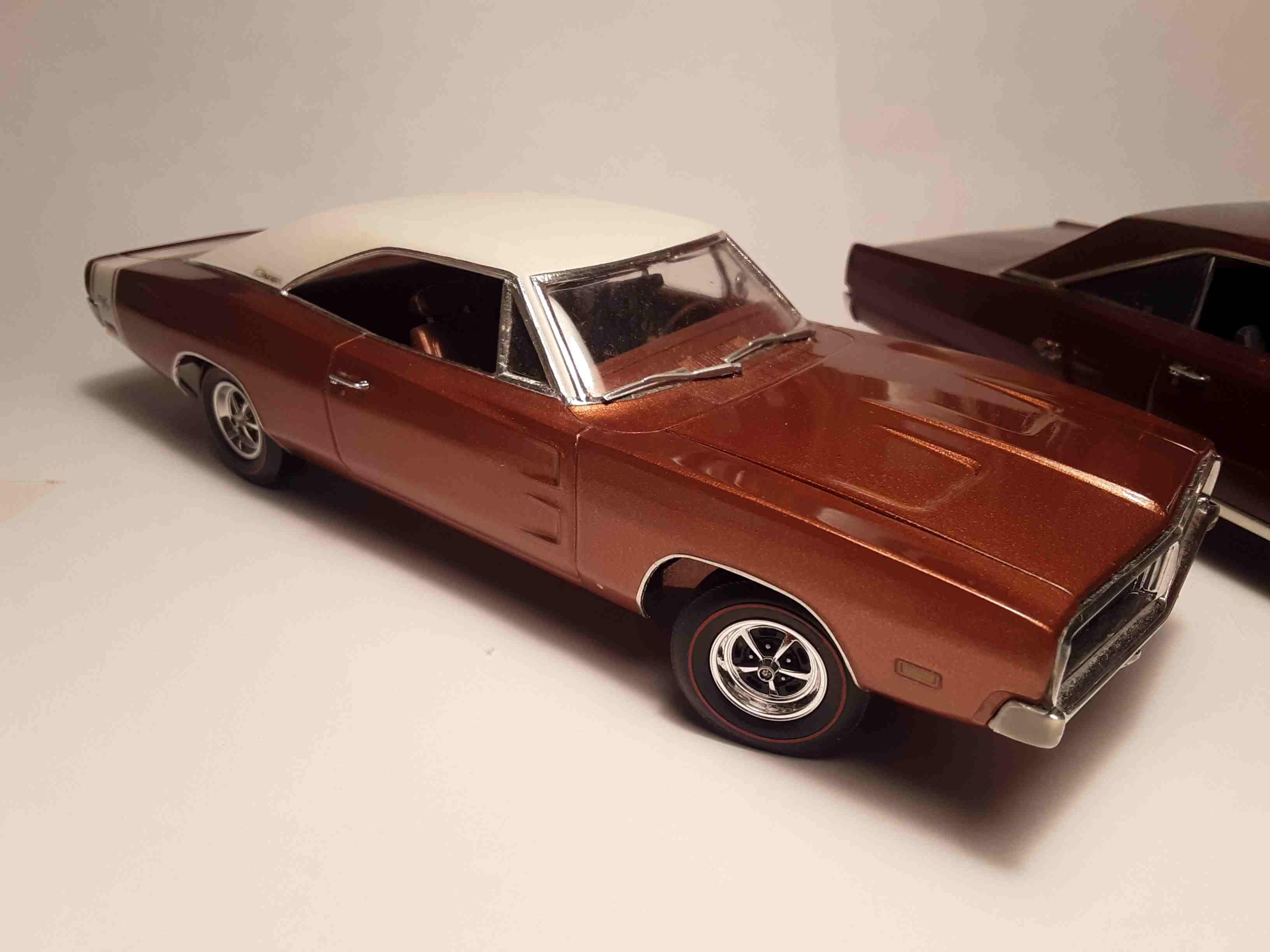

Have you got any pics of anything you shot with that Duplicolor clear?  I love the high gloss look you get with an enamel…

23 hours ago, GMP440 said:
Those look GREAT!  Have you had any issues shooting it over anything at all?  I assume it’s not particularly ‘hot’?
