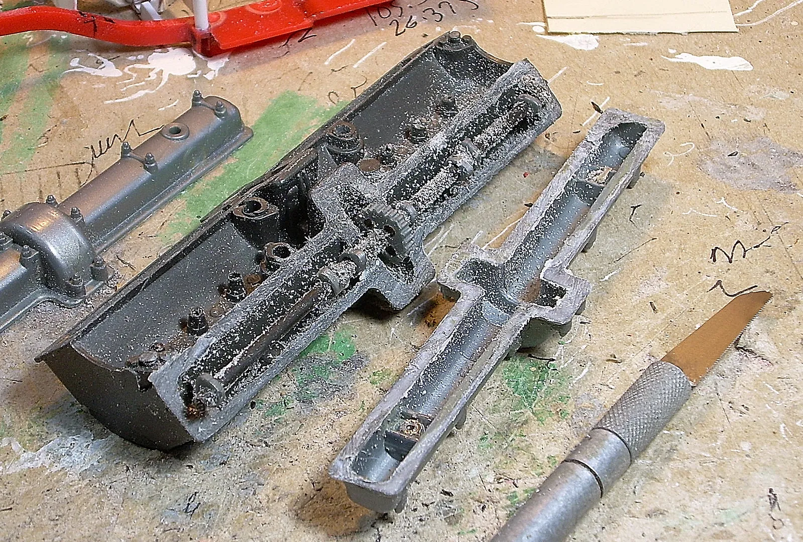

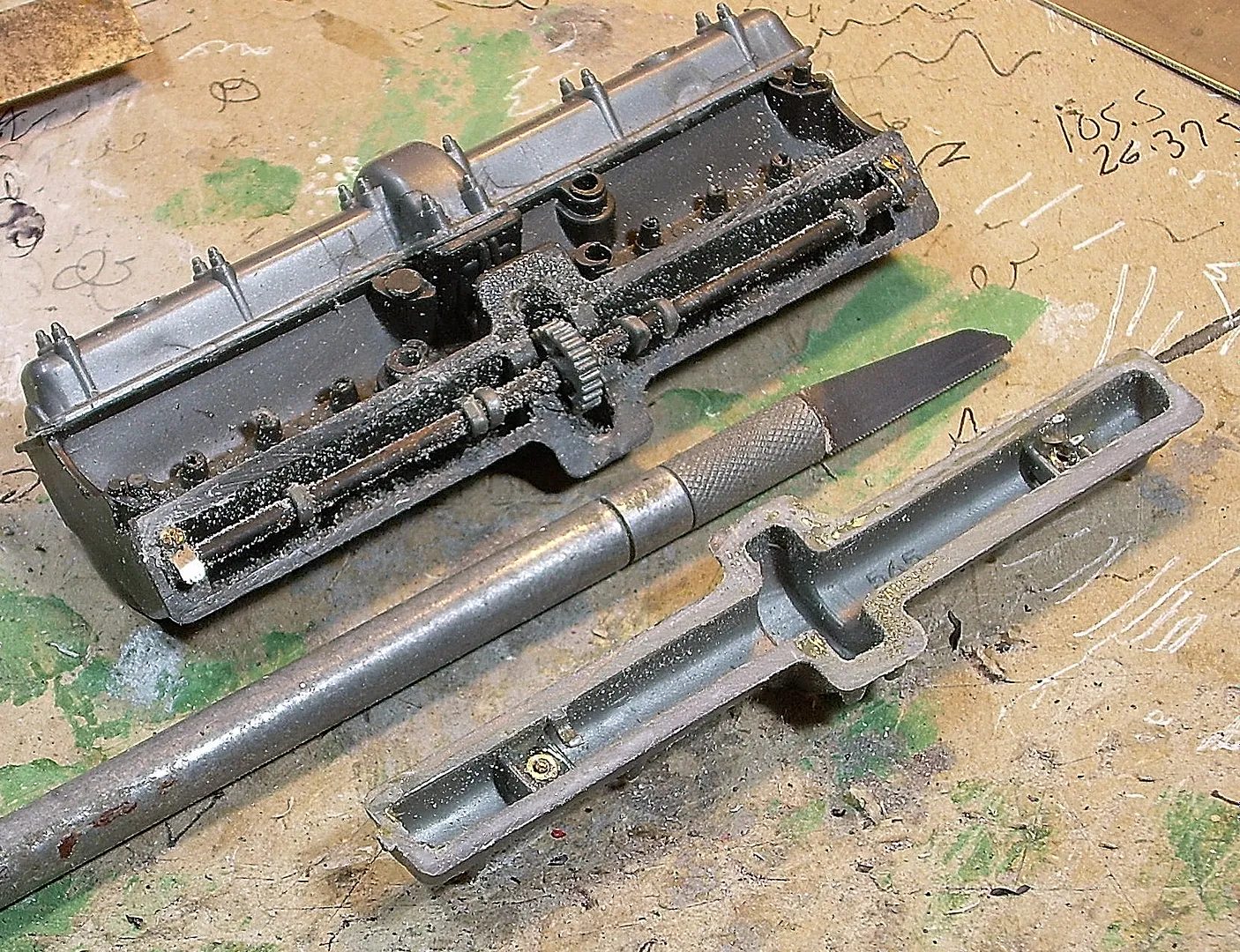

Ace-Garageguy Posted January 16, 2024 Posted January 16, 2024 (edited) I've had excellent results from the MCG 2238 PE saw blades. They are much thinner than razor saws, so they will do things conventional razor saws wont. HOWEVER...because they're very thin, they bend easily, but don't break, and can be straightened. They do take a delicate touch, and are not tools for the ham-handed who get in a hurry. Using an MCG blade, I was able to save an expensive 1/8 scale Pocher Alfa Romeo gloobomb head where the cam covers had been heavily glooed, one glooed on backwards, with very little damage...but it took a few hours of patient work. EDIT: The reason for cutting the cam covers loose was to facilitate finishing them as polished aluminum, where the head itself would remain rough as-cast aluminum. Edited January 16, 2024 by Ace-Garageguy 1
porschercr Posted January 16, 2024 Author Posted January 16, 2024 On 1/16/2024 at 11:16 AM, Ace-Garageguy said: I've had excellent results from the MCG 2238 PE saw blades. They are much thinner than razor saws, so they will do things conventional razor saws wont. HOWEVER...because they're very thin, they bend easily, but don't break, and can be straightened. They do take a delicate touch, and are not tools for the ham-handed who get in a hurry. Using an MCG blade, I was able to save an expensive 1/8 scale Pocher Alfa Romeo gloobomb head where the cam covers had been heavily glooed, one glooed on backwards, with very little damage...but it took a few hours of patient work. EDIT: The reason for cutting the cam covers loose was to facilitate finishing them as polished aluminum, where the head itself would remain rough as-cast aluminum. Expand Thanks, I was hoping you would chime in.
