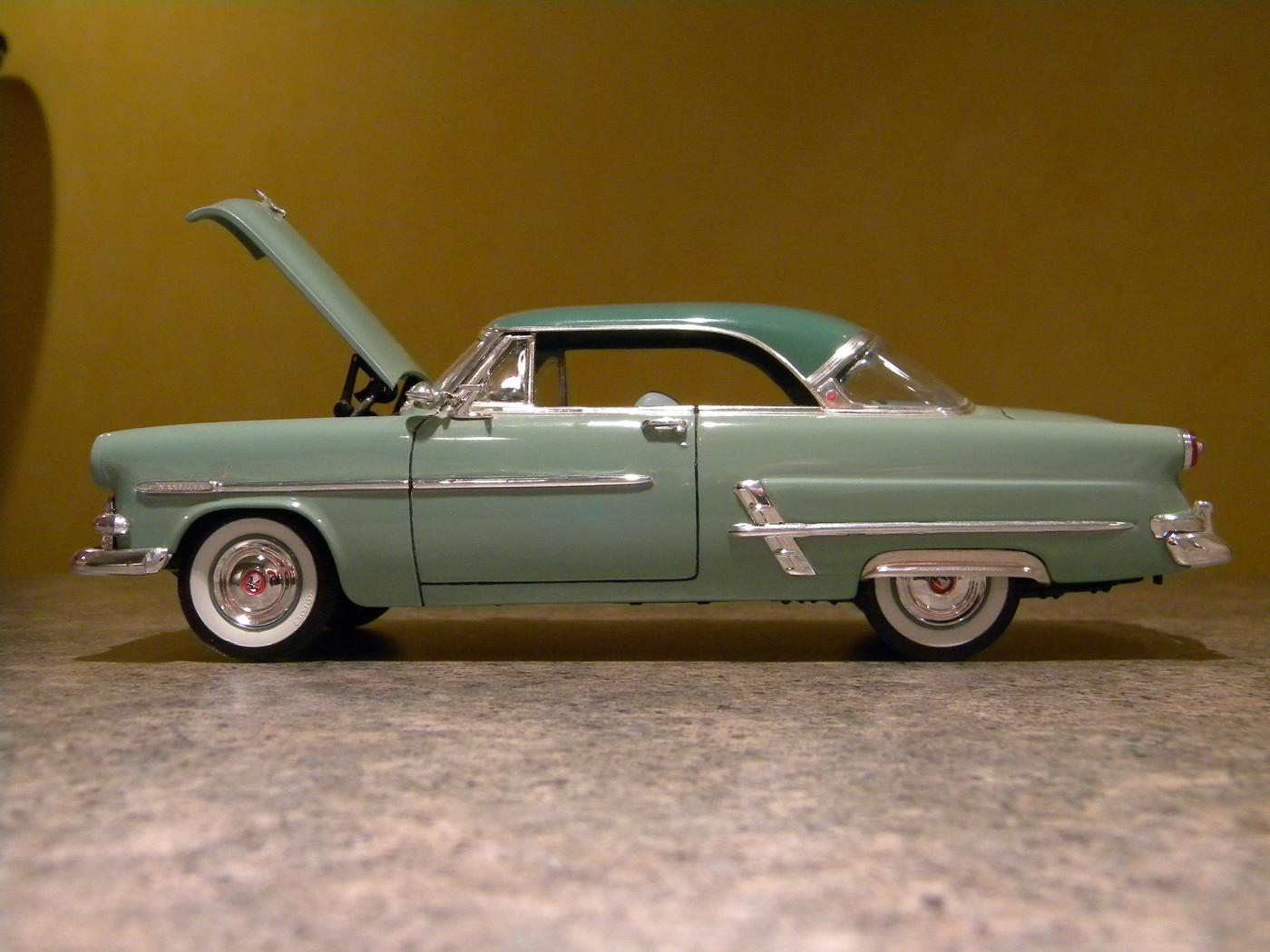

Absolutely!
As a matter of fact, this is a terrific way to begin practicing with painting and polishing.
This 1953 Ford was done many, many years ago by mixing the colors that I wanted with Testors flat enamels, airbrushed on, and then over coated with a single coat of Testors gloss enamel, and lightly polished.
A word of caution.
Should you decide to try this method, be aware that Testors clear enamel takes a loooooong time to completely cure, and has a slightly yellow hue directly from the can, so it’s not recommended to use over light colors such as white, and you might as well figure in putting it back in the box for a month or two to let it cure before attempting to polish it.
But yes, it is a very viable technique if you don’t mind the time involved.
Steve
  • Like 2

Is that BMF for the trims around the windows? How did you accomplish that level of brightness that so well matches the stock model chrome pieces?
Just by polishing rather vigorously after application.
Steve
  • Like 1
