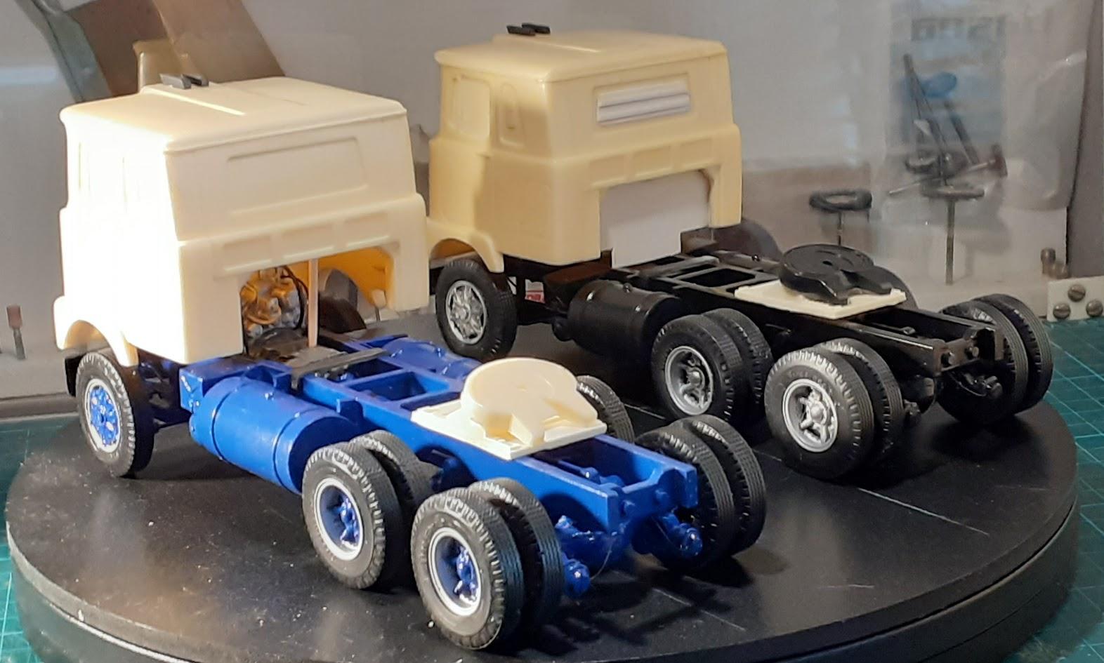

The Brush Posted April 28, 2024 Author Posted April 28, 2024 Hi, Heres the frames painted one is curb side the other has a D/D 8V 92 painted silver for a change & a few extra details added, Next job is the cabs. I have also made cab supports which i have made a mould of ready to cast 5
Rockford Posted April 28, 2024 Posted April 28, 2024 Excellent pair of frames there mate, they look great. Always impressed with your jobs. Is that Detroit the one I've discovered in the Ford LTL9000? I'm thinking of learning to cast pieces just to cast this engine or maybe even just the transmission because in cabovers their often visible. 2
cifenet Posted April 28, 2024 Posted April 28, 2024 So far so good, chassis work looks great and you have two going at the same time! 2
The Brush Posted April 29, 2024 Author Posted April 29, 2024 20 hours ago, Rockford said: Excellent pair of frames there mate, they look great. Always impressed with your jobs. Is that Detroit the one I've discovered in the Ford LTL9000? I'm thinking of learning to cast pieces just to cast this engine or maybe even just the transmission because in cabovers their often visible. Thanks for the kind words, Yes the motor is from the ford, cast in resin from homemade moulds, the gear box is mounted in both frames. It`s worth having a go at casting , I use 3 & 5mm foam board for the boxes, cheaper than plastic. mould & casting materials from DWR Plastics ltd. 2
The Brush Posted April 29, 2024 Author Posted April 29, 2024 18 hours ago, cifenet said: So far so good, chassis work looks great and you have two going at the same time! Thanks for the reply, I have another frame to make a mould & cast frames to save time on the next builds. 2
Rockford Posted April 29, 2024 Posted April 29, 2024 2 hours ago, The Brush said: Thanks for the kind words, Yes the motor is from the ford, cast in resin from homemade moulds, the gear box is mounted in both frames. It`s worth having a go at casting , I use 3 & 5mm foam board for the boxes, cheaper than plastic. mould & casting materials from DWR Plastics ltd. You've really got me thinking. I'll have a look at a few tutorials. 2

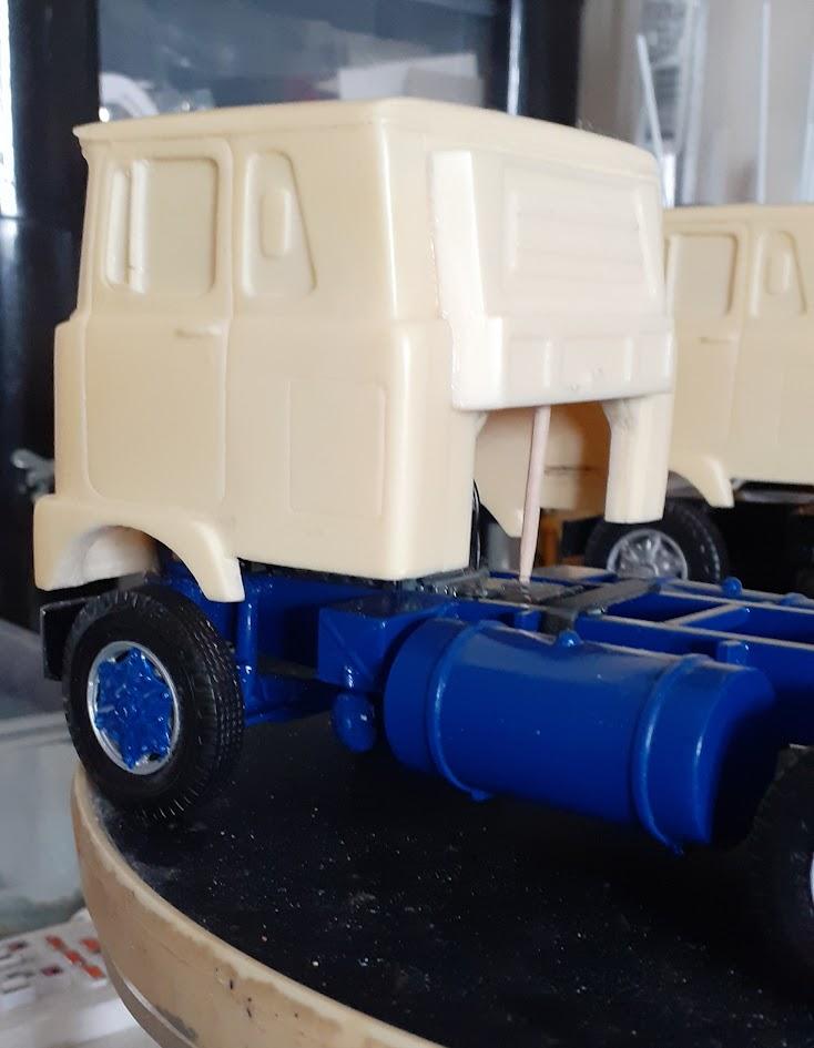

The Brush Posted June 15, 2024 Author Posted June 15, 2024 Hi, been doing other jobs painting ,decorating etc, But managed to fit in fitting the cabs & casting bits. The hinges are glasses repair type 3mm cut to fit, I made cab support from plastic made a mould & cast in resin same with the `bustle back` for the later model. i`m still working on the best way to make a grill. Thanks for looking. 2

Repstock Posted June 16, 2024 Posted June 16, 2024 I can't even see items in 1/32! Amazing work! I don't know if this will show up in 1/32, but the center vertical grille bar is a little thicker than the other two. I don't know if it's possible to do in 1/32, but I thought I'd throw it out there. I also agree with you...casting parts is a skill I couldn't do without! 2
The Brush Posted June 17, 2024 Author Posted June 17, 2024 (edited) 22 hours ago, Repstock said: I can't even see items in 1/32! Amazing work! I don't know if this will show up in 1/32, but the center vertical grille bar is a little thicker than the other two. I don't know if it's possible to do in 1/32, but I thought I'd throw it out there. I also agree with you...casting parts is a skill I couldn't do without! Thanks for the comments & info, I have 2 pics to work from, off the web , The front cab shows the vertical bar thicker. Edited June 17, 2024 by The Brush 2

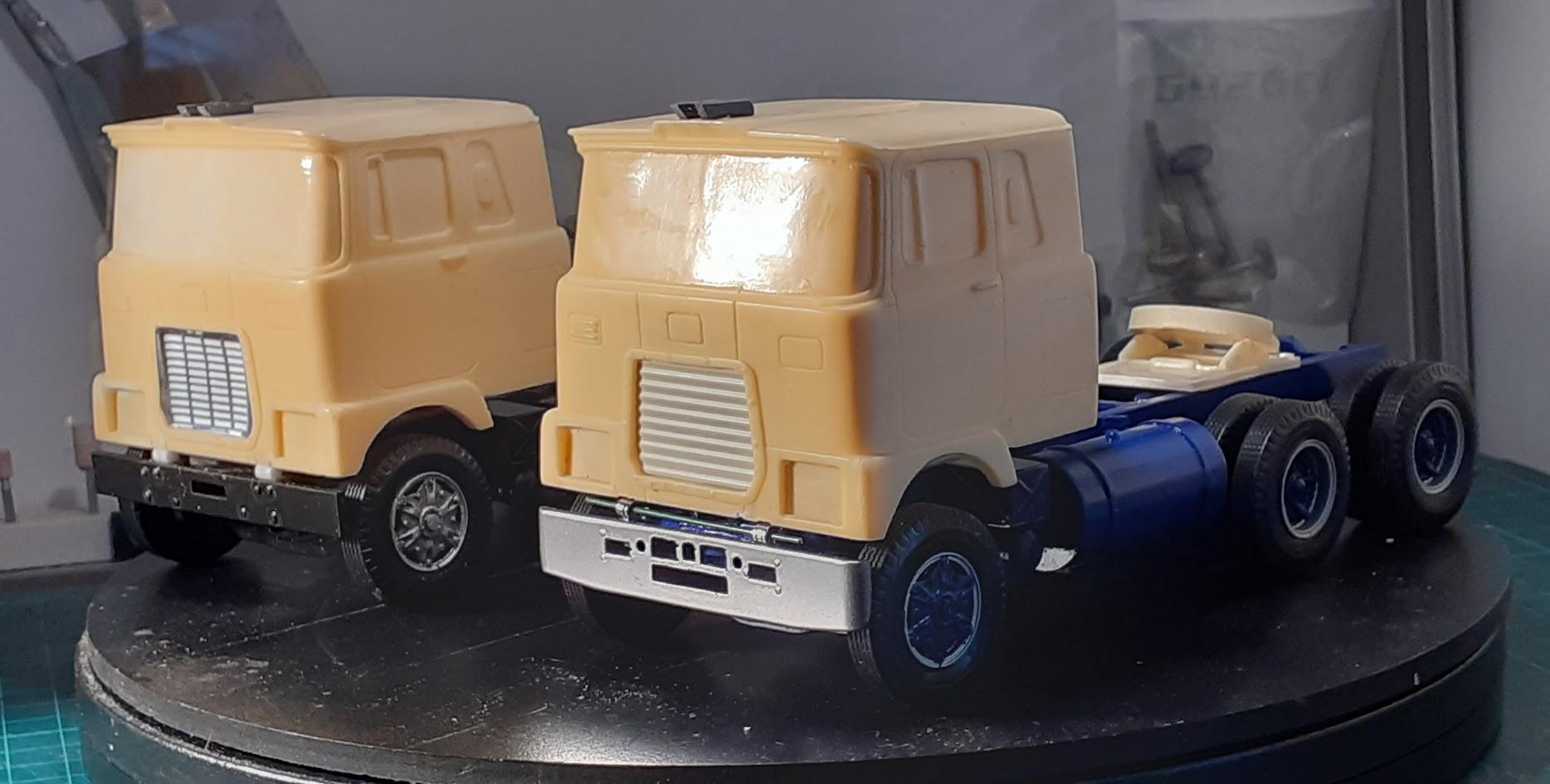

The Brush Posted July 2, 2024 Author Posted July 2, 2024 (edited) Hi, I have made 2 grille's 1 to try then another to mould with adjustments, I can either fir it with surround or cut the grille itself to fit. one thing i have used in this build is a big box of hindsight. I should have included the grille in the cab before making the mould. I might cast another cab with it & the bustle back fitted. i made it from ho scale cladding , I plan to spray it chrome then infill with black. Thanks for looking. Edited July 2, 2024 by The Brush 3

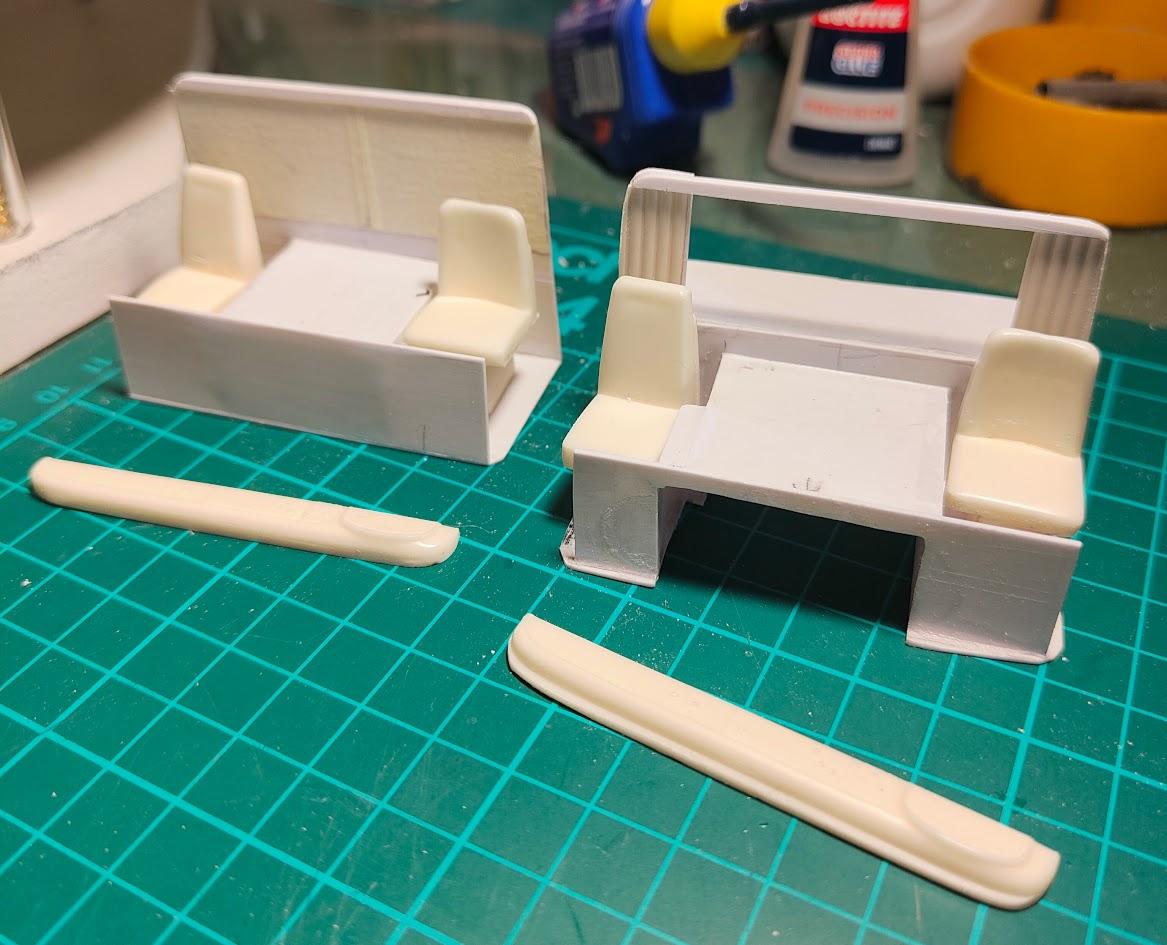

The Brush Posted November 20, 2024 Author Posted November 20, 2024 (edited) Hi, I have just finished the interiors & moulded the windscreen , full door panel in clear acetate with decals for lower panel, Looks lighter than it is, I formed the windscreen with a 2 part wooden male & female mould heated the acetate with a heat gun then pressed together to get the shape. Interiors from plastic card with steering wheels form wire & 2mm rod, also made a few decals with dials. They are not exact replicas but fill a gap. Probably not much of it will be seen. I will make a new interior in sections so i can cast it in resin. Thanks for looking. Edited November 20, 2024 by The Brush 4
BK9300 Posted November 20, 2024 Posted November 20, 2024 Ingenious idea for your door panels! Your windshield solution looks to be as good as or better than vacu-forming - nice clean edges - terrific job! 2
