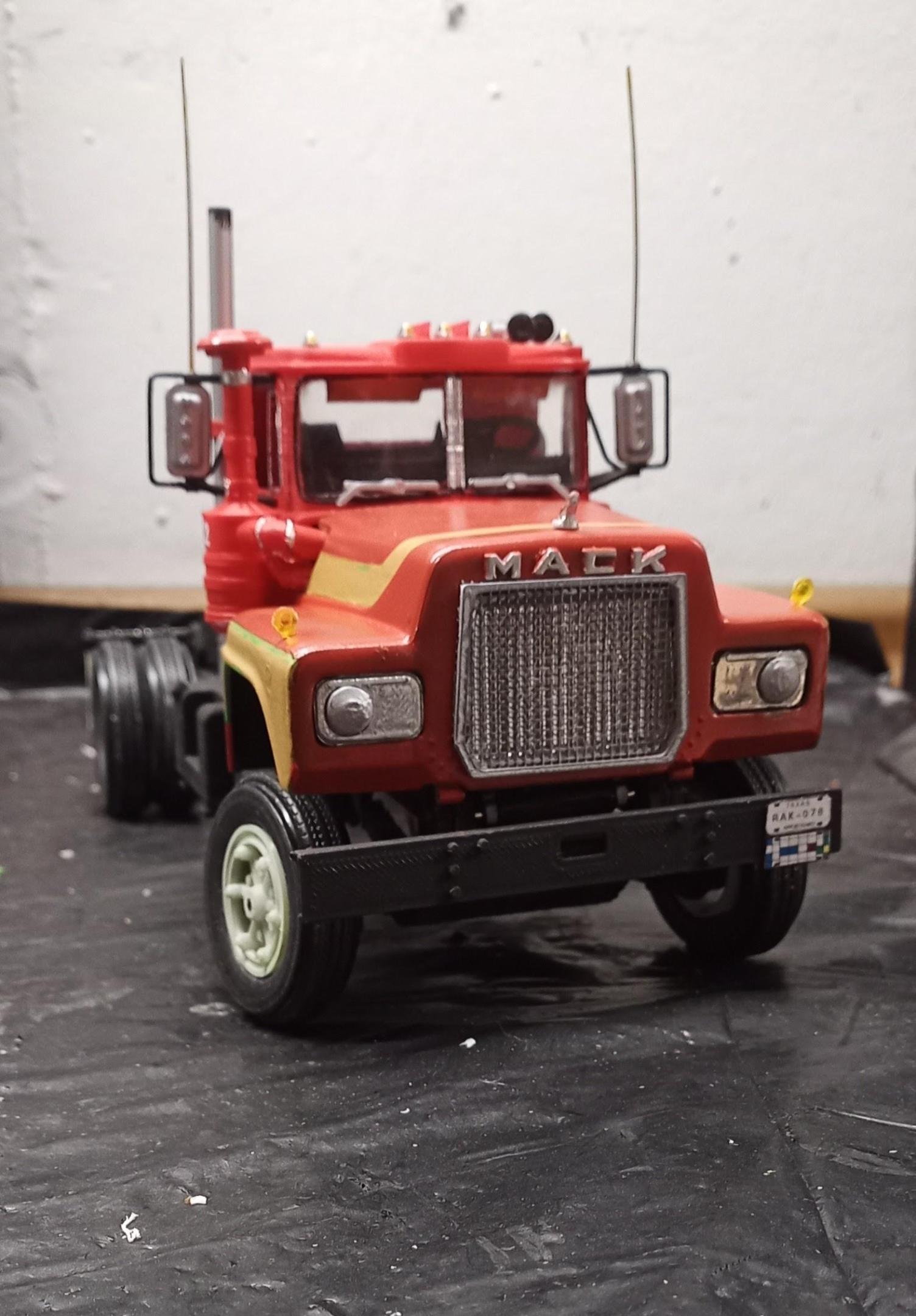

In the opening shot of your post the stripes do have a green tinge, on the one where you asked what it says on the doors they're pure tan coloured to me. Co.ours can vary so much on film, but I'd lean toward a khaki for the stripe. The twin pup trailers were never 20ft in my experience, always 25-27 feet.
On 3/1/2024 at 10:10 PM, Jürgen M. said:
Sorry, but I've got a red-green problem. A friend of mine said it's green with a touch of gold in it.
But thanks for the input.
That's what I thought.
I see no green what so ever in the stripes, they look gold or tan to me.

Thanks for your input Rockford! I've got a tan color but it's gonna be Tricky to repaint now that the Truck is fully assembled!
I'm trying to put the color in the decals. If that doesn't work I can still hope for a calm hand! ?

OK, I took your advice and changed the stripes from green to tan. Looks better! Thanks again!

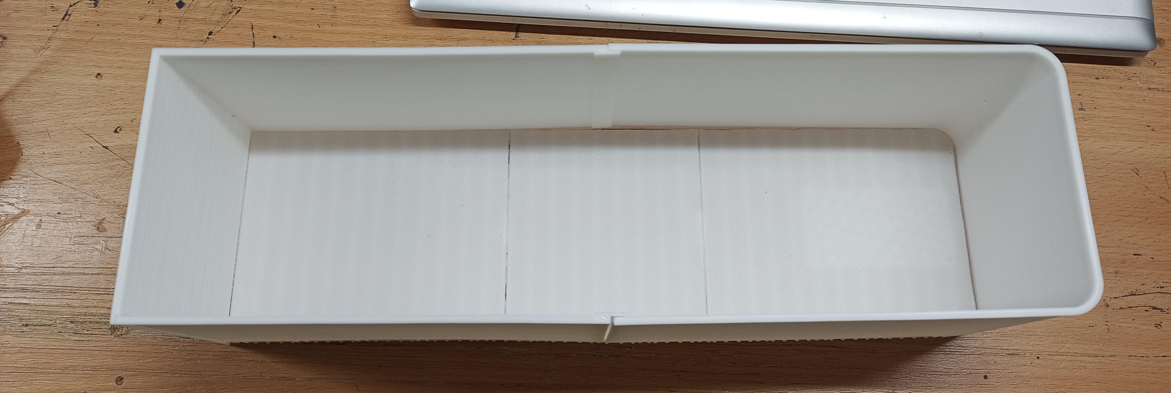

And I´ve started printing the first trailer parts:
Here´s the floor made of three parts. (Only because I had designed them to 20ft and not 27!
So I made another part to increase the lenght from 24 to 33cms.
original_e884518a-d0ec-4f41-8880-93f4e88f3b68_IMG_20240304_102233_116.jpg.4b6f87d02e7e4c8a002381f3b542e562.jpg
And here´s the front and side walls (only front half) being printed:
  • Like 2

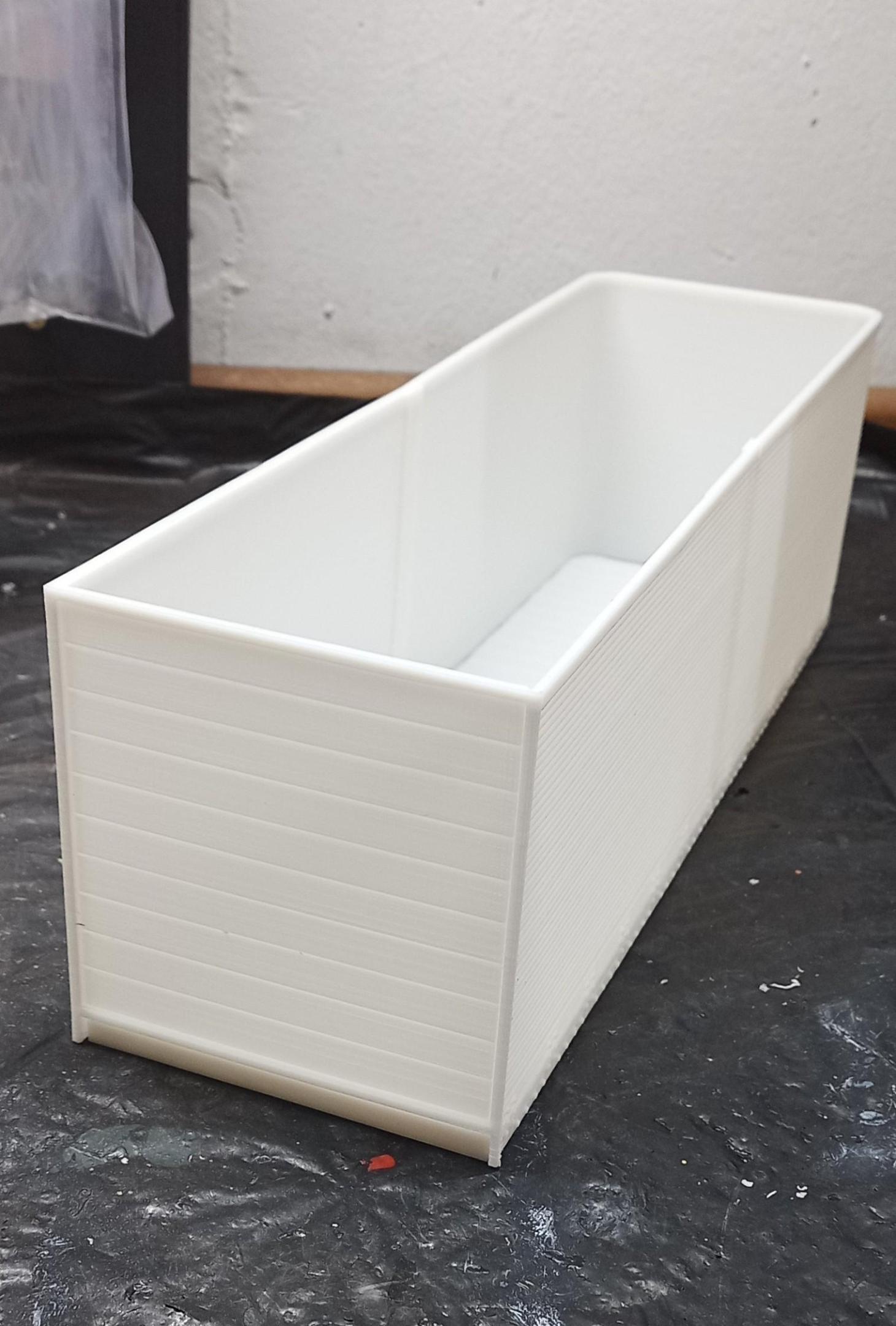

The rear part ist also printed.
I put them together to see If they fit. Seems to work out pretty well.
IMG_20240305_193258_499.jpg.4b04f7593c3b6f2d823ac58bce69148c.jpgIMG_20240305_193309_435.thumb.jpg.26026e500814bec800e41f6c83cddea1.jpg
When they're glued together and painted I'm sure it will look even better!

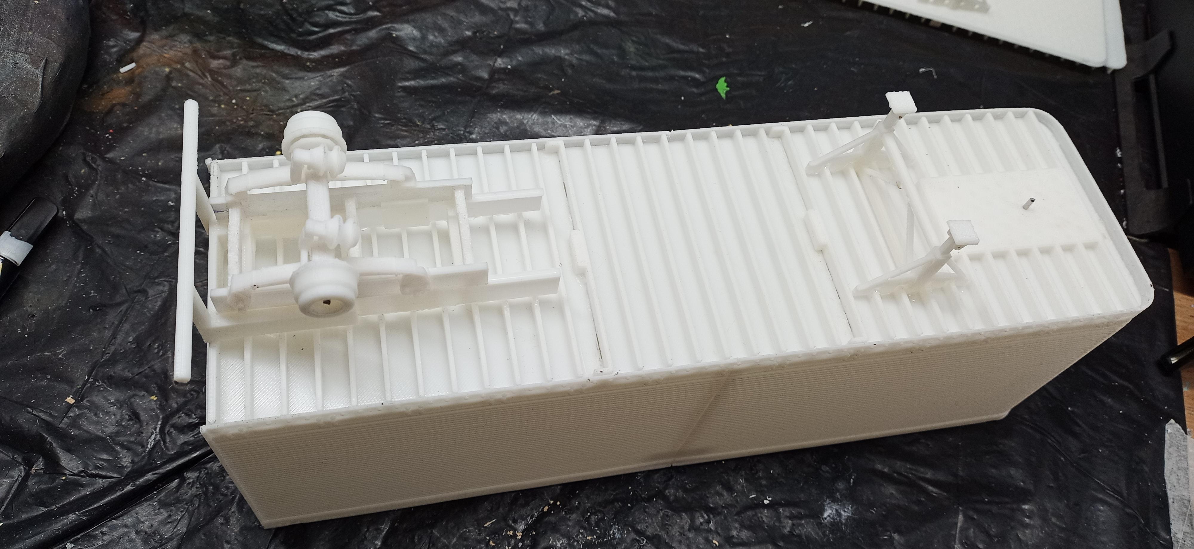

Also the walls of the first trailer are now glued to the floor:

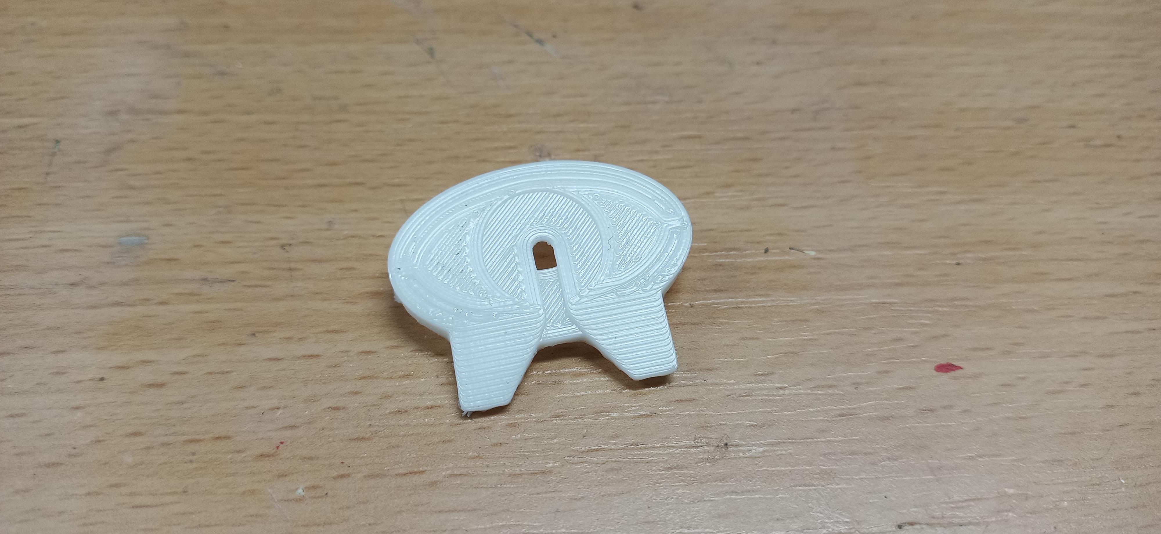

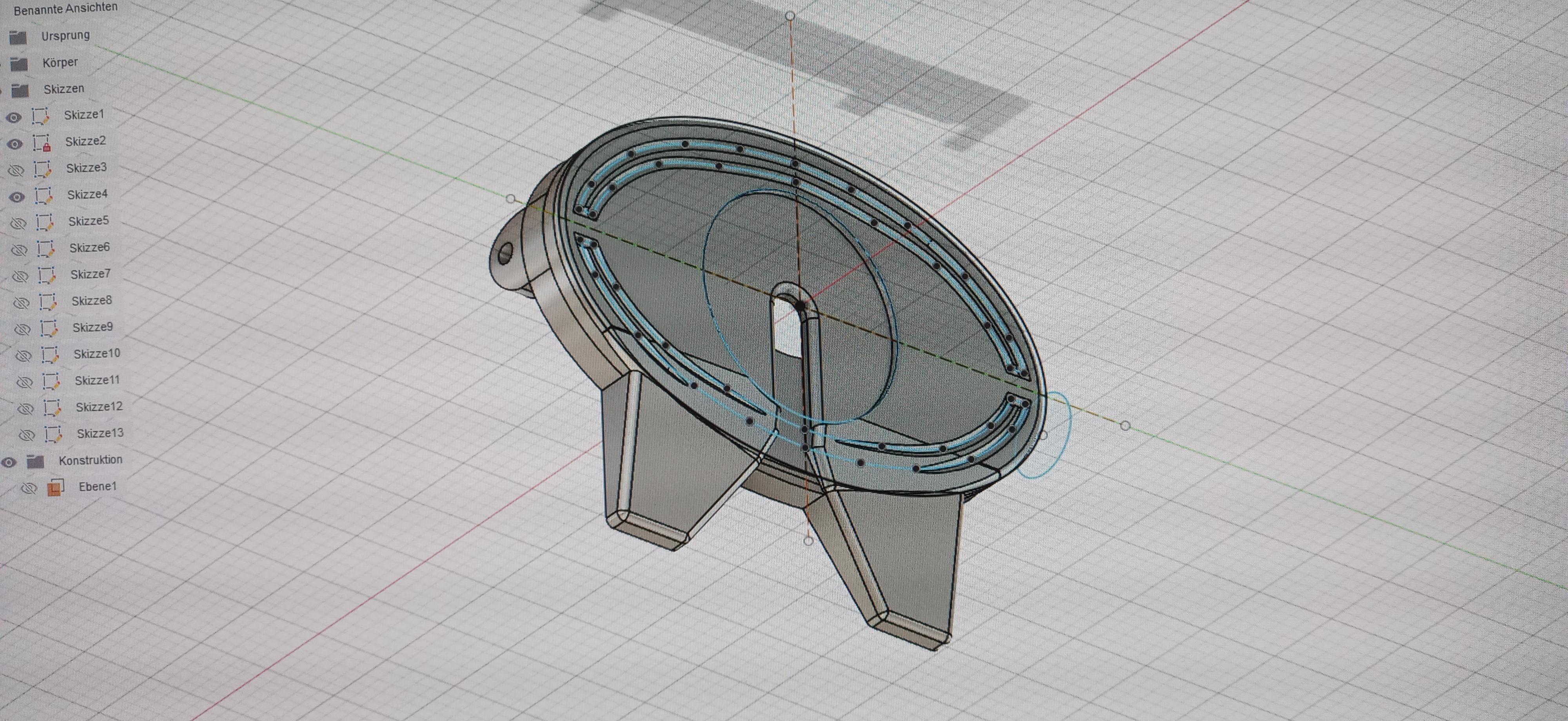

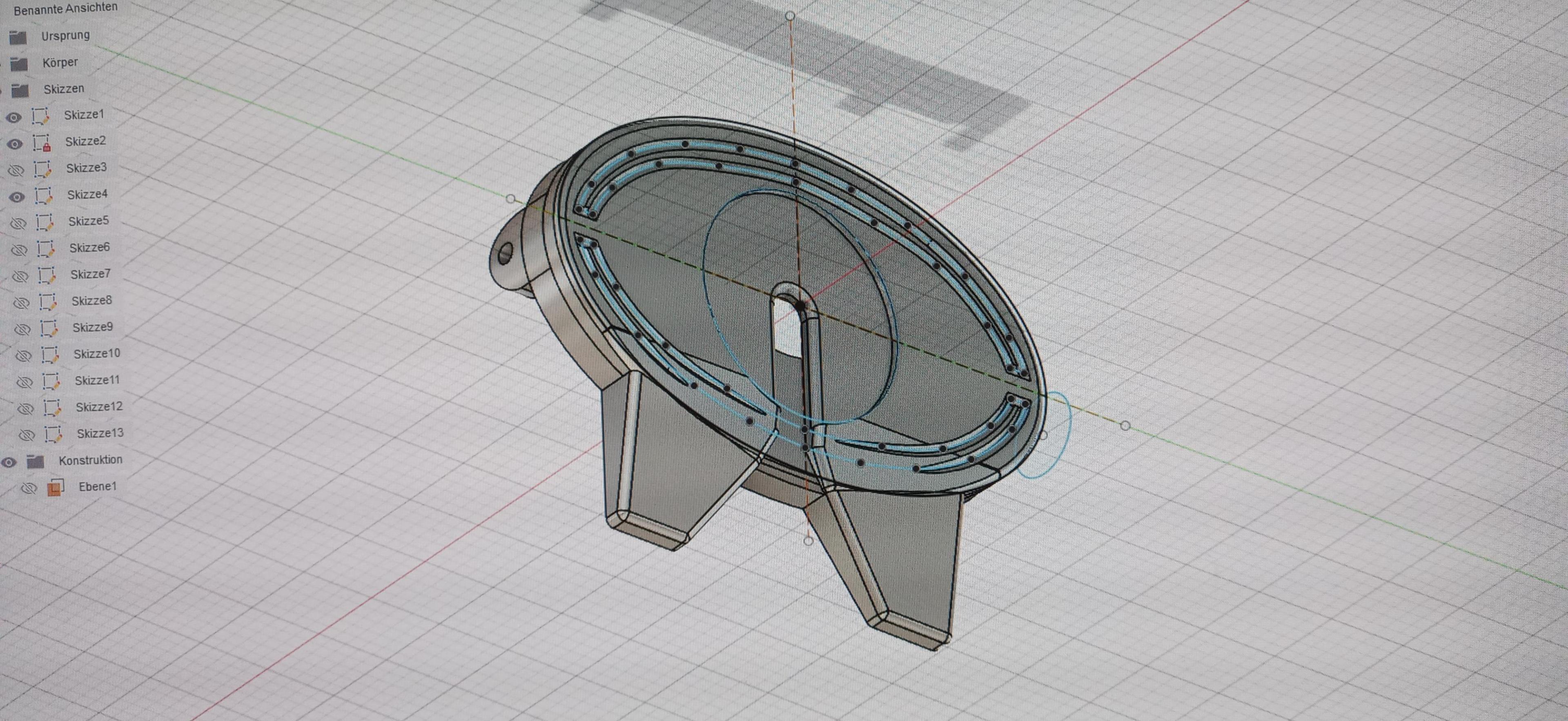

And I designed a new fifth wheel for the drawbar of the second trailer:

The fifth wheel of the second trailer ist printed ...

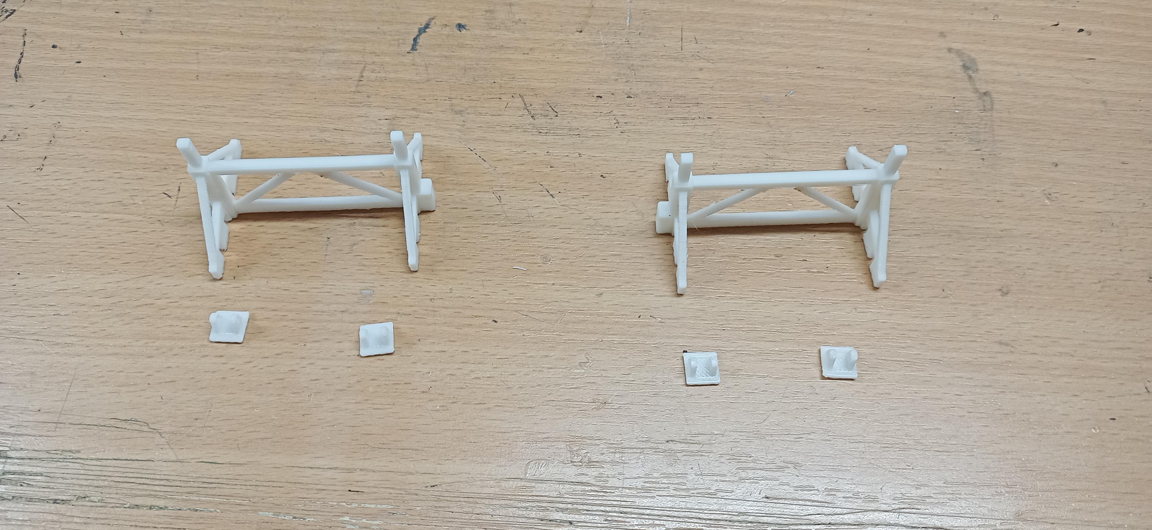

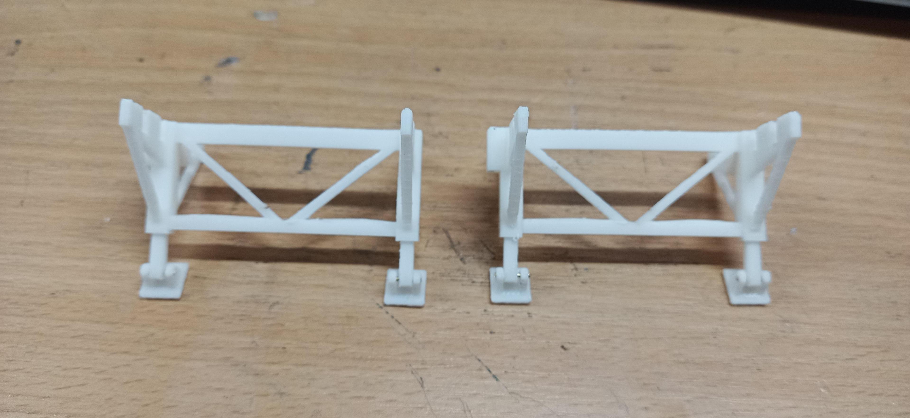

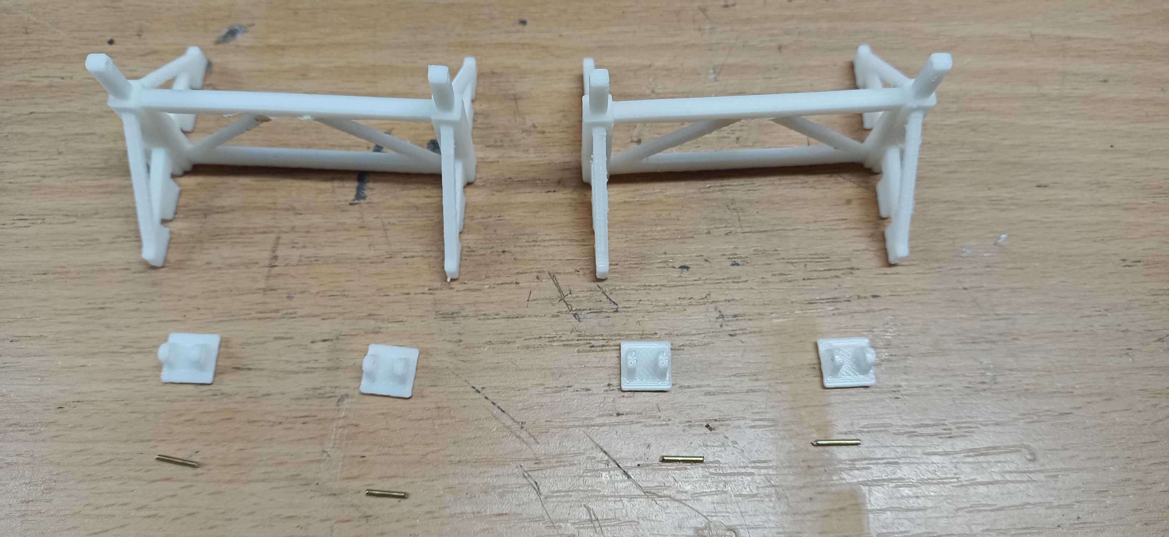

... so are the landing gears:
I used the pins to keep the "feet" movable.
Not that it's necessary but it looks nice! ?
The landing gears are printed in one piece! Saves glue! ?

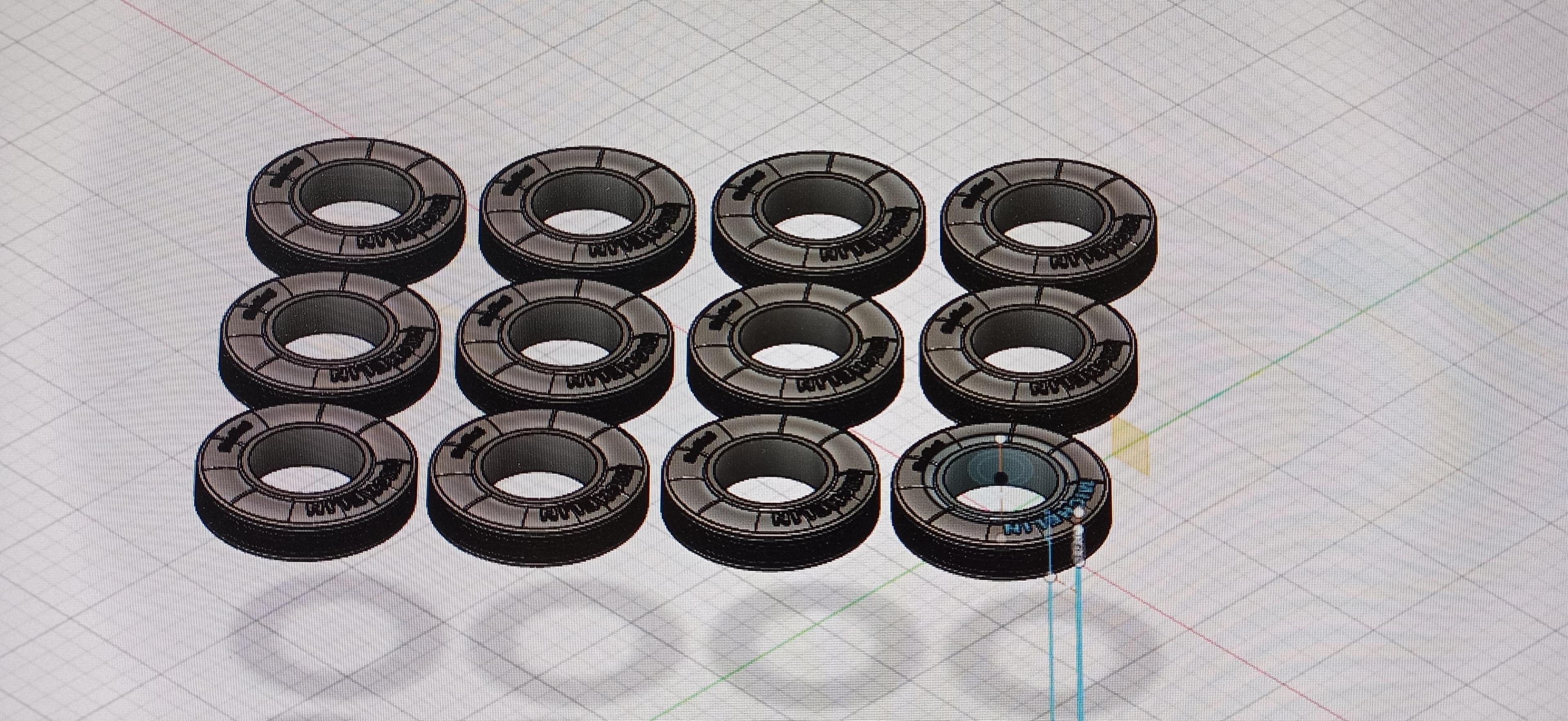

Unfortunately I ran out of tires.
I always ordered them directly from Revell but they're shifting their production to Austria which means no orders possible for the next 4-6 weeks.
Since I don't want to wait that long I designed them! ?
Edited by Jürgen M.
  • Like 1

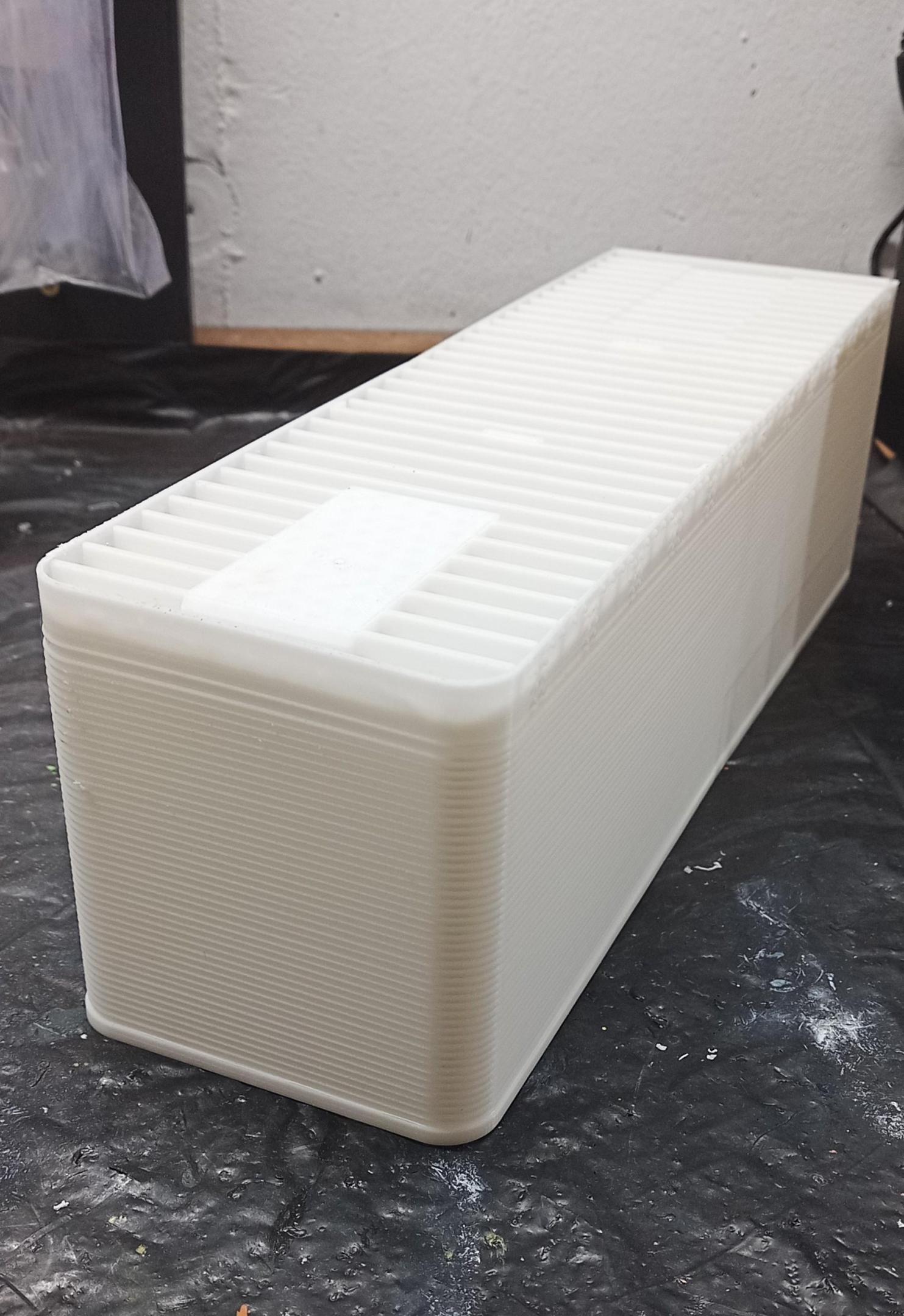

The trailer is coming out very nice!
I wonder if you are going to do anything with the vertical line in the middle, but either way, I think it will turn out to be fantastic!
And Michelin tires on the drawing software looks good too.  Keep up the good work!
Thanks!
I was thinking about the vertical line too. I'll have to put some putty in and then clean the horizontal lines. Hope that works out the way I want it to!
I think I'll put on the first layer of primer and then see how much the vertical line shows through. It just looks so dominant because the light ist shining through, showing the connecting areas. We'll see!

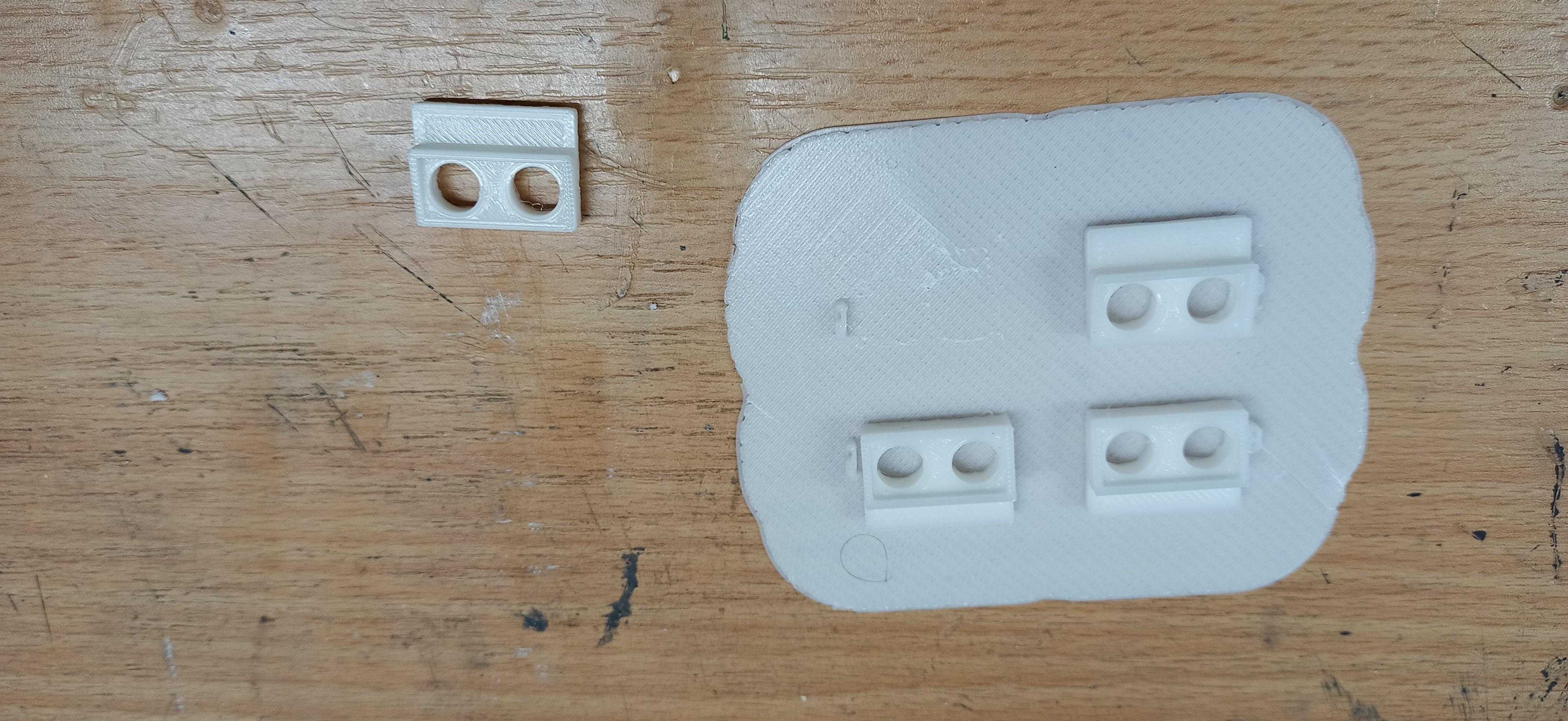

These are the rear lights of the trailers like they come out of the printer!
I made them fit the red and orange lights you find in every Amt truck model kit. Guess everyone knows them!
IMG_20240314_140321_216.jpg.47810fc40d2564611b890853b2e93600.jpgIMG_20240314_140412_525.jpg.40d1ca8023ed3b1593212c4101f03a96.jpg
They'll be covered on the back side so you don't see the red and orange through.

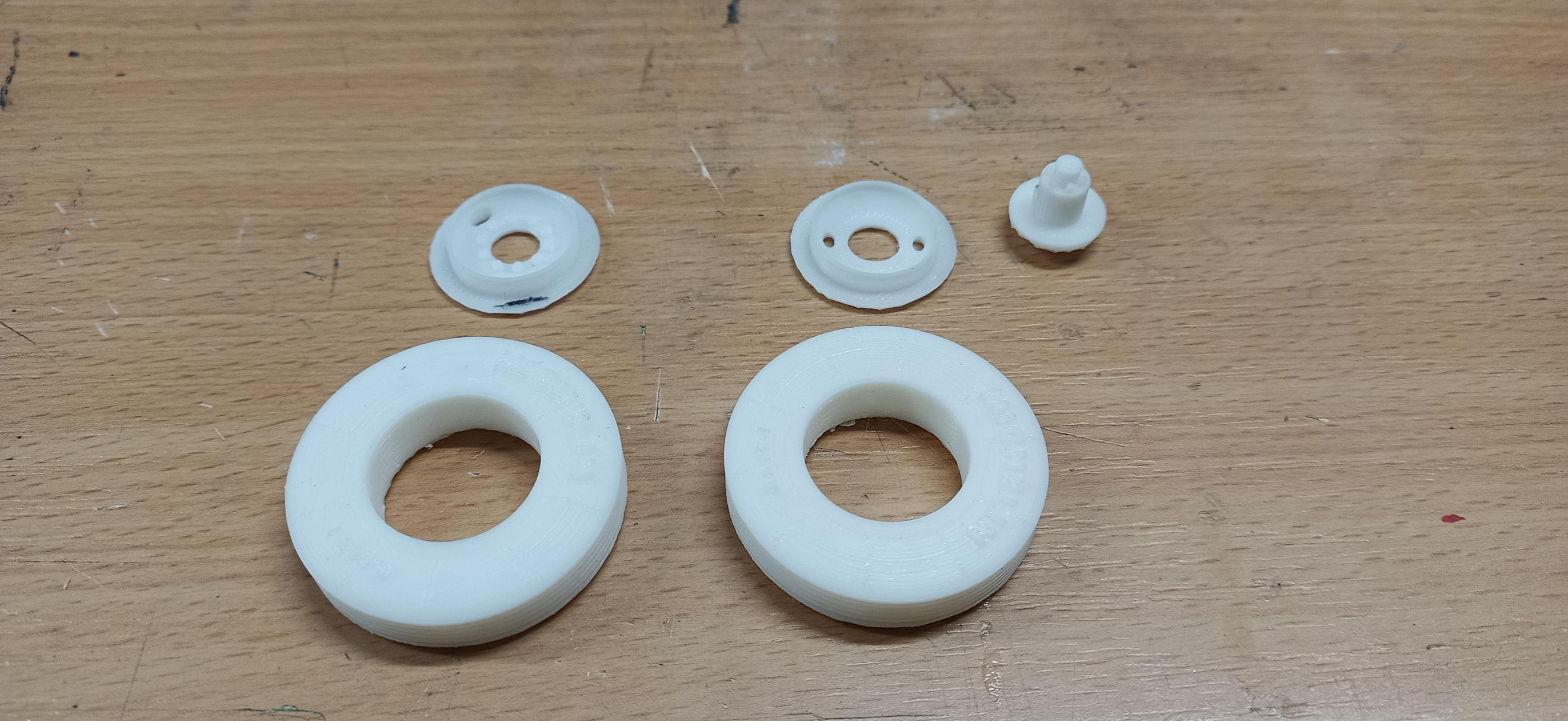

The wheels are completely printed now.
This is how the parts fit together. (I know, it's hard to recognize details on white parts but I think the principle of the whole thing gets clear!)
The hub is put into the inside wheel which hast to be turned around first...
then they're fit into the inside tire.
Then the outside wheel is put on top.
Finally the outside tire is put in place.
The rims are printed in one piece with the tires. It'll be visible when everything is painted. You might See it in the picture of the 3D drawing I posted.
Anyway, this is one version of how I build truck and trailer wheels.

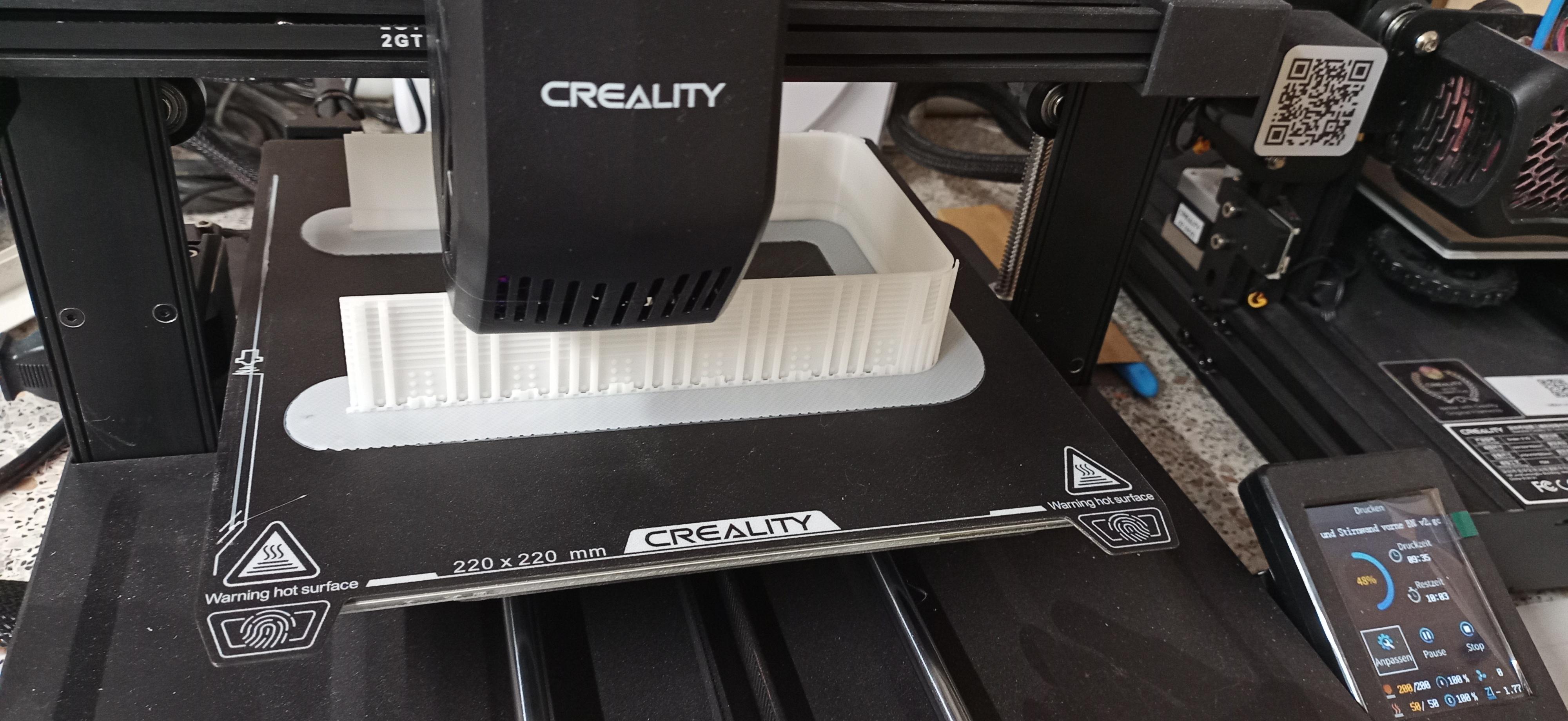

This is the very last part of the second trailer to print.
The vertical grid is just the support structure.
If you can read the display there's another 18hrs to go on that. Takes about 24hrs in total on one of those!

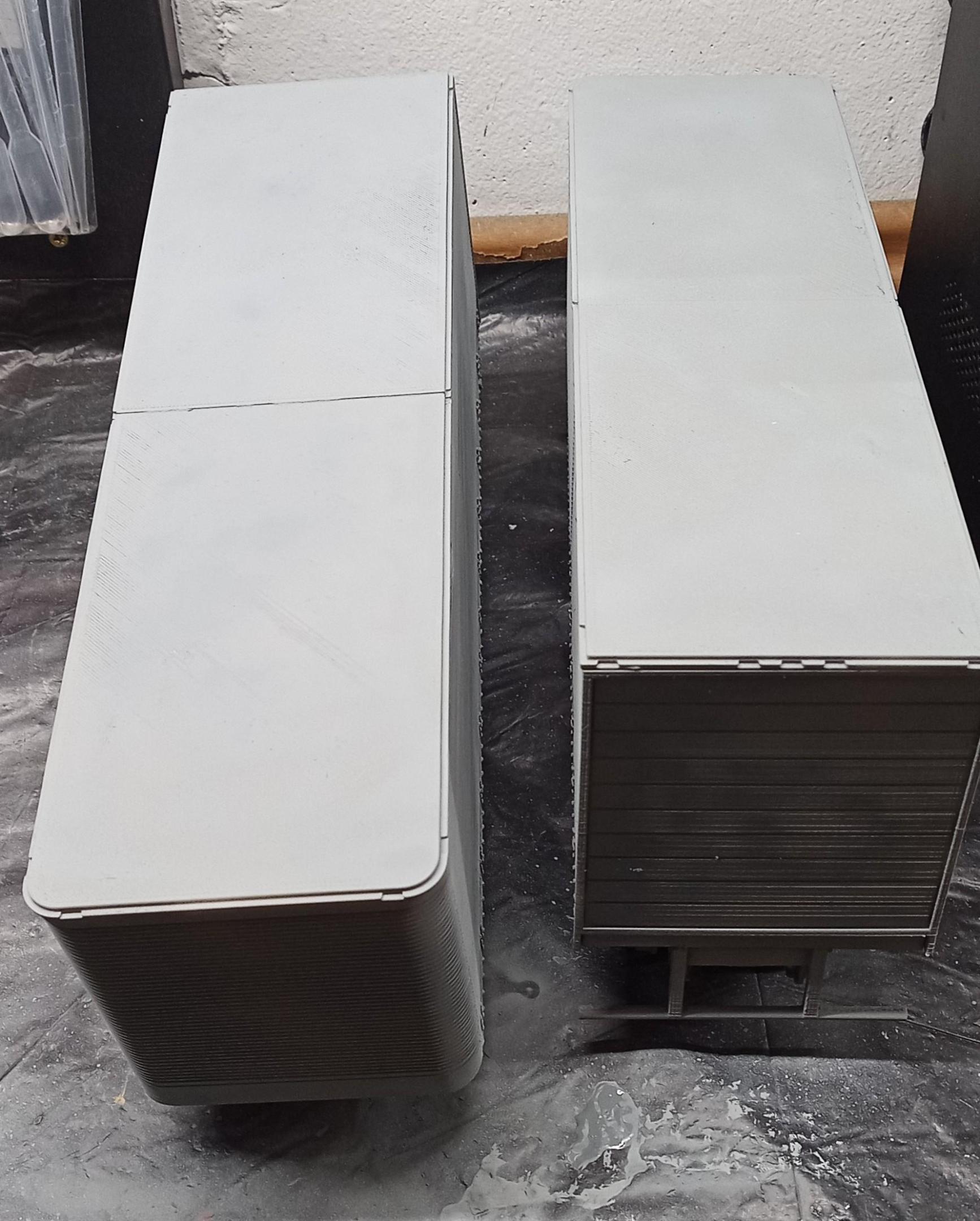

The trailers are ready for painting now!
Almost like twins!
The drawbar is only positioned because I have to know how far it's going to have to stick out in order to make the trailers turn without touching.
Edited by Jürgen M.

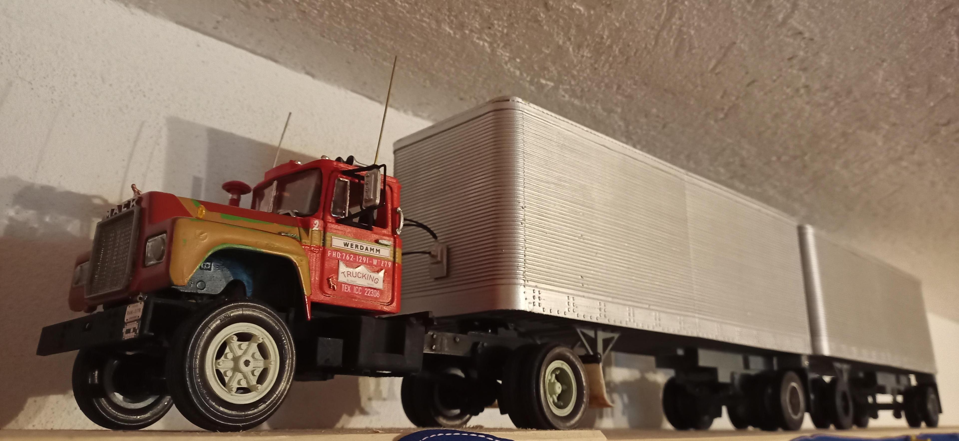

Looks like "Big Nasty" is ready to join the convoy!
Air lines are installed!
Ready to slip into the back door!
Only the "Fruehauf" emblems on the trailers are missing but they'll be finished and applied shortly!
Concerning the vertical lines on the trailer sides caused by printing in two halves (printer size doesn't allow larger parts), I tried to close the gaps but it didn't really help. A little maybe!
Still looks pretty good to me.
Hope you enjoyed the build and thanks for following and your good advice! ?
