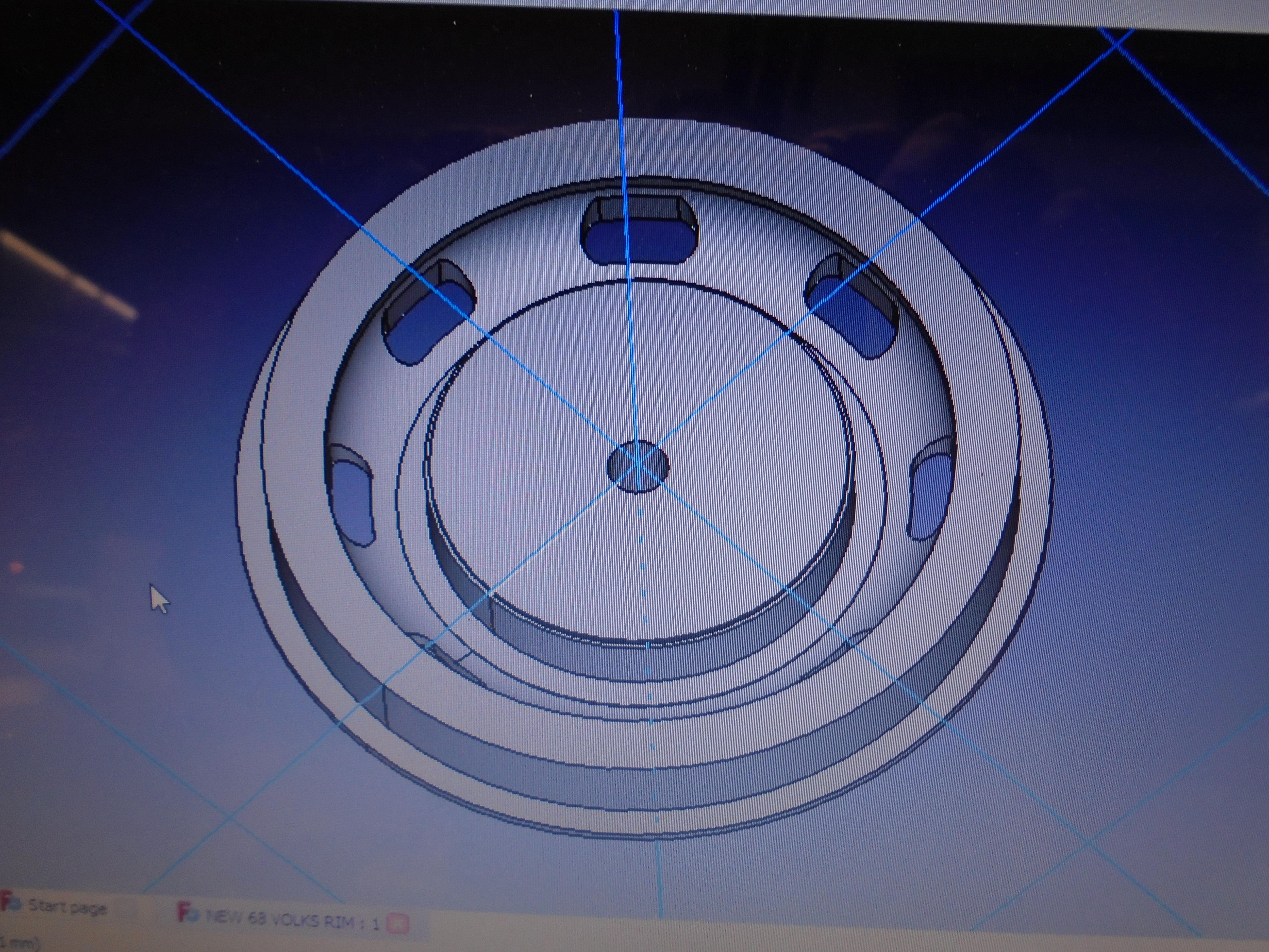

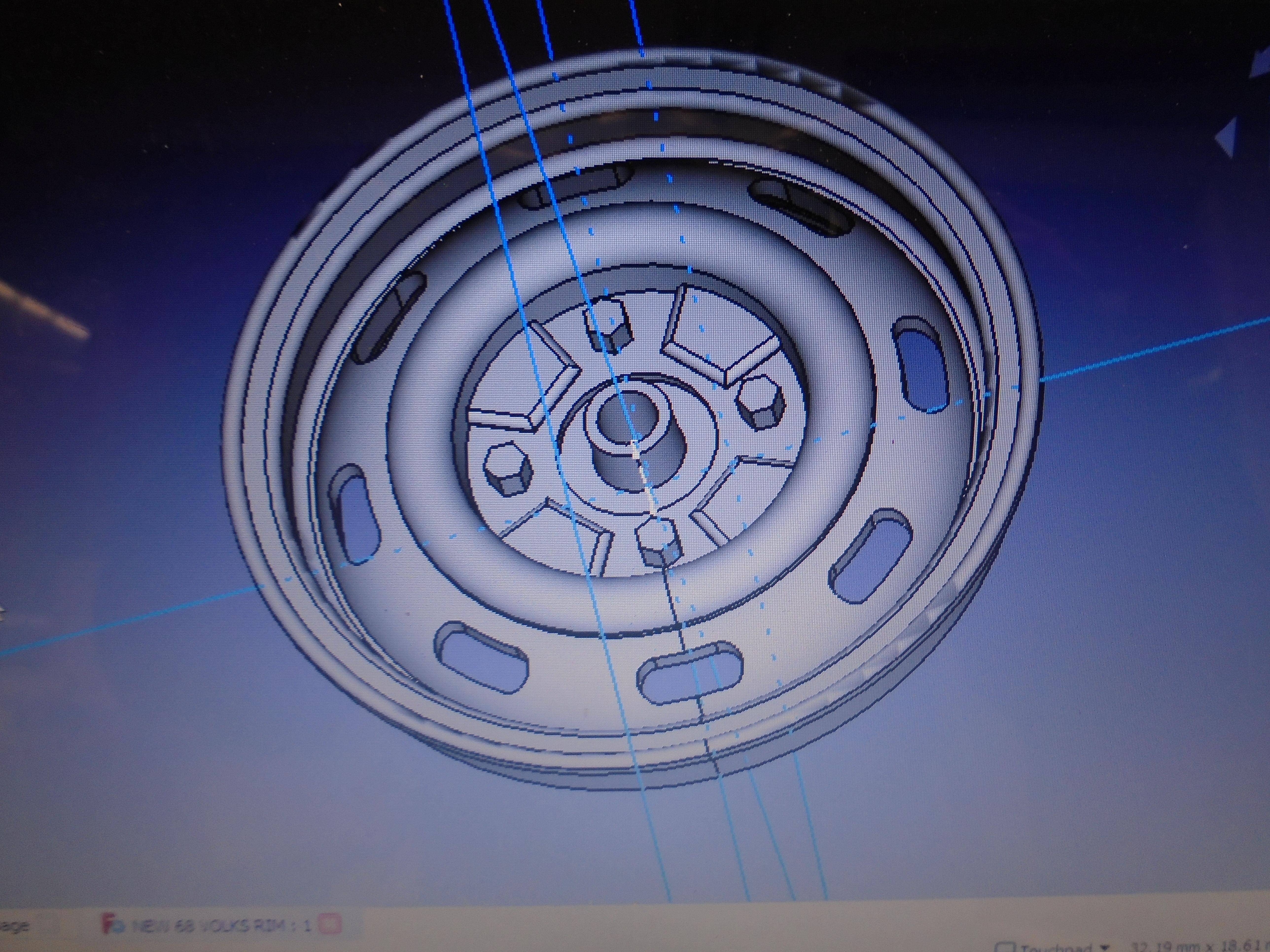

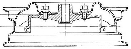

My first effort to model something I needed, was a Volkswagen steel wheel. I gathered photos of the wheel and also found a cross section drawing. I was able to import the drawing into Freecad and scale it to size. I drew the geometry to emulate the backside of the kit wheel so that when it gets 3D printed, it will fit into the kit tires. Then I rotated the geometry and punched in the slots and added fillets. I haven't printed them yet though. Trying to draw up a bunch of things to print over a weekend when I can exhaust the resin fumes out of my basement. This is also my first time posting pictures, so I hope this turns out OK. Good luck. 3D modeling and printing has consumed a lot time that otherwise would be used to build models. But hey, I'm having a blast.

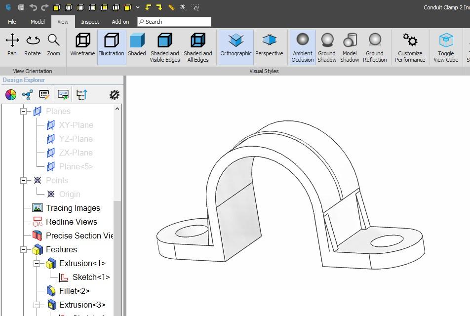

I'd start simple, and with something you actually need/want. It makes all the patience needed easier.
My first part was a pipe clamp I need in a different size than what I had. I threw a few other early designs in there too.
The more you do, the easier it gets so just get started.
